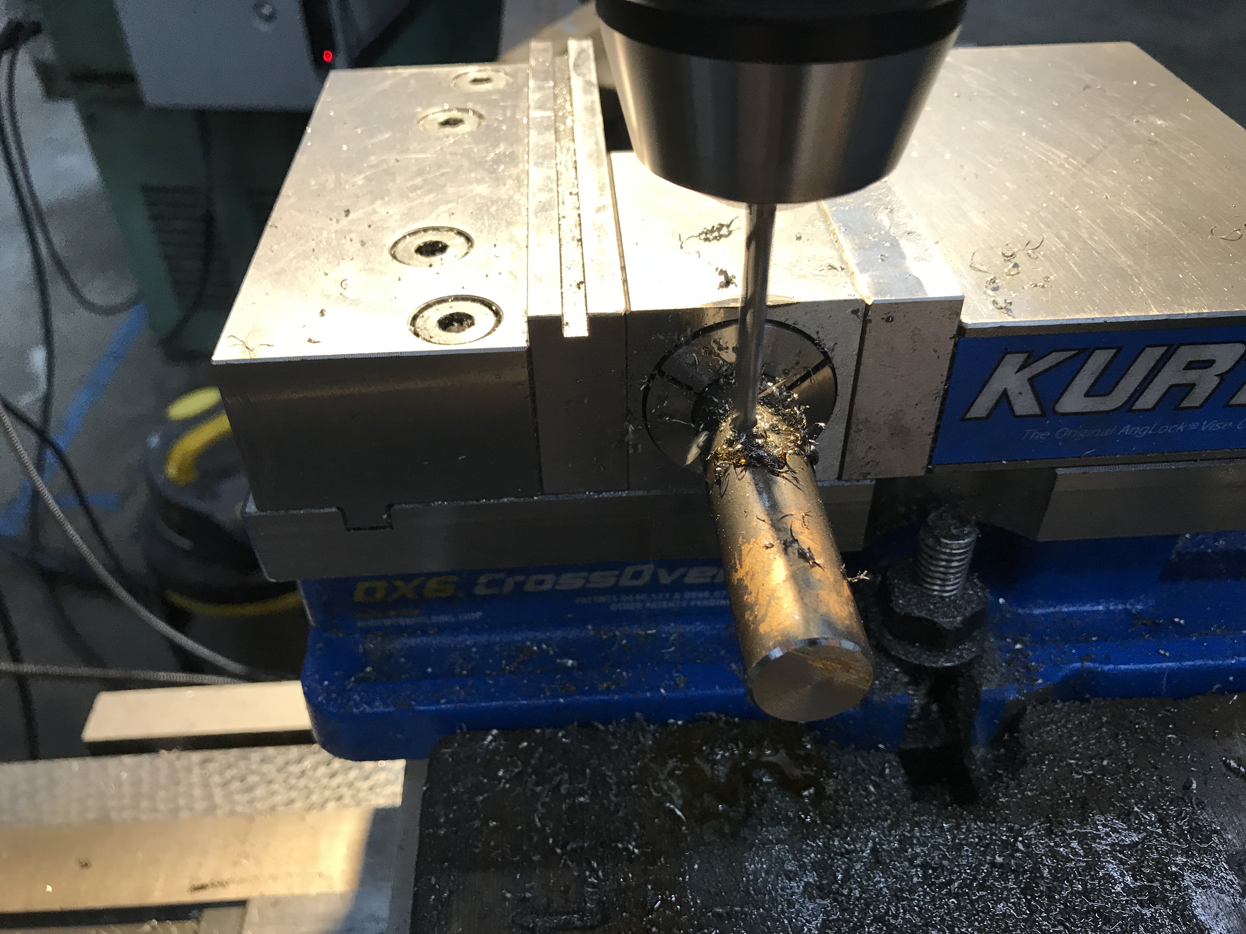

The big day is here. Our shafts are being machined. There are multiple steps involved, so expect the process to take more than a single session.
One shaft has bern drilled and tapped for the set screw.

The first shaft is almost complete. A key-way and key-stock has beren added. This insightful modification will prevent the same destruction of the shaft in the future.

Drilling the hole that pins the worm gear to the shaft
