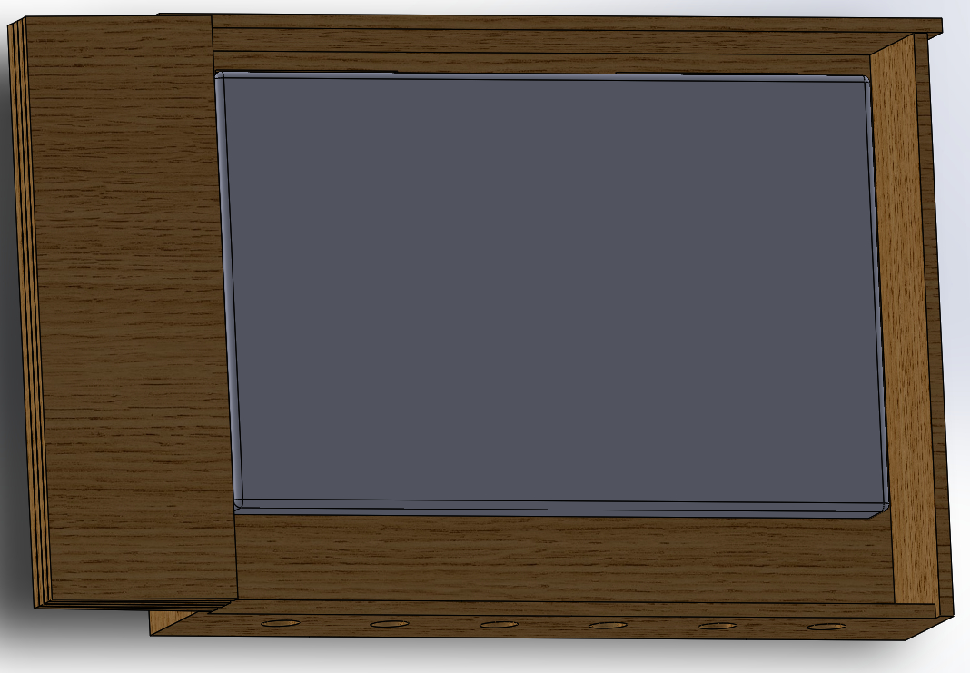

Thanks everyone for all the great ideas. I think I will go with a tradition hinge to one side. I think a stainless piano hinge will keep out enough water. This will let me just use lumber to make the front door. I might experiment with making a panel just to see if I can glue up something 20" with any accuracy (two folding panels). I’m not too confident in my precision skills. But hey, this guy will get a $600 TV box for just the cost of material so I’m not too concerned.
I’m really tempted to do this… thinking… it would require me to succeed in creating a 40" panel from 1x12 lumber. On the plus side all worries about water are put to rest.
Current concept minus the actual width of the door panels which I have not decided yet. I’ll also have a piece of trim inside the box on top and right for the door to rest against.
