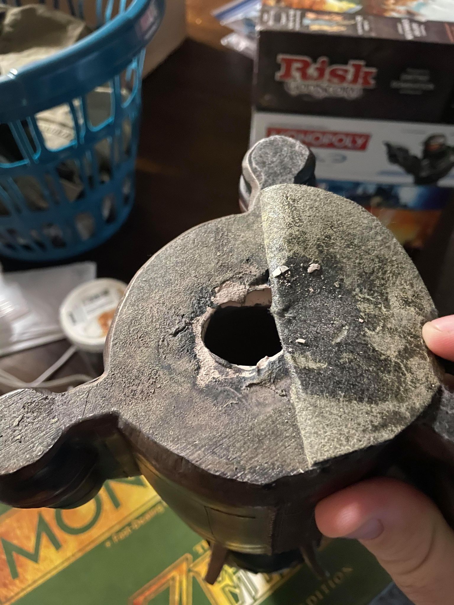

Hello! So I have a question/ favor to ask of you. My boyfriends dad passed recently and they had him cremated. His dad was obsessed with Marvin the Martian and while cleaning out his fathers apartment we found a sculpture that is hollow. (His father was a major hoarder) It’s got a hole on the bottom so we can get the ashes in that way… we just aren’t sure exactly how we to properly seal it up. At first I thought it was bronze but after research I found out otherwise and it’s actually made of ceramic/ porcelain. Would you or anyone you know be able to help me seal it up once we get the ashes in it.

I’m thinking a shaped cork to plug it and then maybe heat molded plastic base using silicone putty like in a kitchen / bathroom style? That way it would be removable later but permanent enough for the purpose.
PS I know it might sound weird to some to use a marvin the martian memorial urn but, you know people are gonna people!
How about just a 2 part epoxy resin? I’ve sealed the bottom of some cracked pottery before that way and it worked like a charm. It helps that this already has a cover on the bottom.
well, like the hole is the only way to get ashes in. So would a barrier be good? And then mix the epoxy with, like some stone filler to make it seamless in appearance
Would it be cast like, right side up so the base forms correctly?
ahh, I didn’t realize that was the only way to get the ashes in. Then yeah after the ashes are in, you’d need to plug the hole relatively carefully if you wanted to do a layer of resin on top. you basically dont want the resin mixing with the ashes and it pours like syrup.
Maybe create a silicone base plug. Mold it to it, before putting the ashes in. Then place the ashes in after the plug is made.
You could also use silicone sealer around a fitted plug, which doesn’t run as much. Line the sides of the plug and the inside of the hole with thin layer and then put it in. Wipe away the excess and add a little extra if you see any gaps. The result should be watertight.
