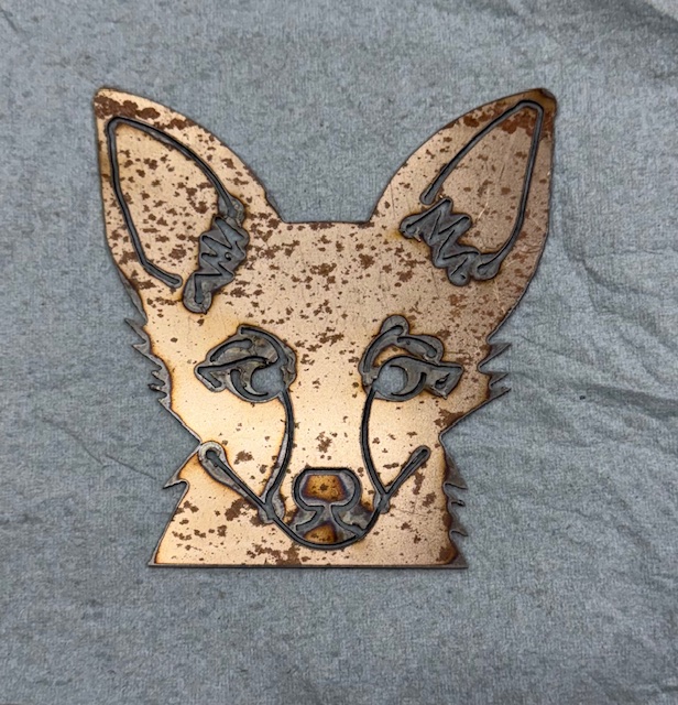

Keep in mind the more you use it, the better you become. There are so many features in the software. Take for instance Plasma Mate(inside of the dynatorch program). It is a canned list of various components. Including brackets, flanges and etc. these canned list of items you can adjust the measurements to make work for your specific needs.
For instance I cranked these out yesterday using Plasma Mate.
I meant to ask. What font did you use?
I just used Arial Black, but I had to explode each letter and modify each to bridge the internal areas that I didn’t want to fall out.

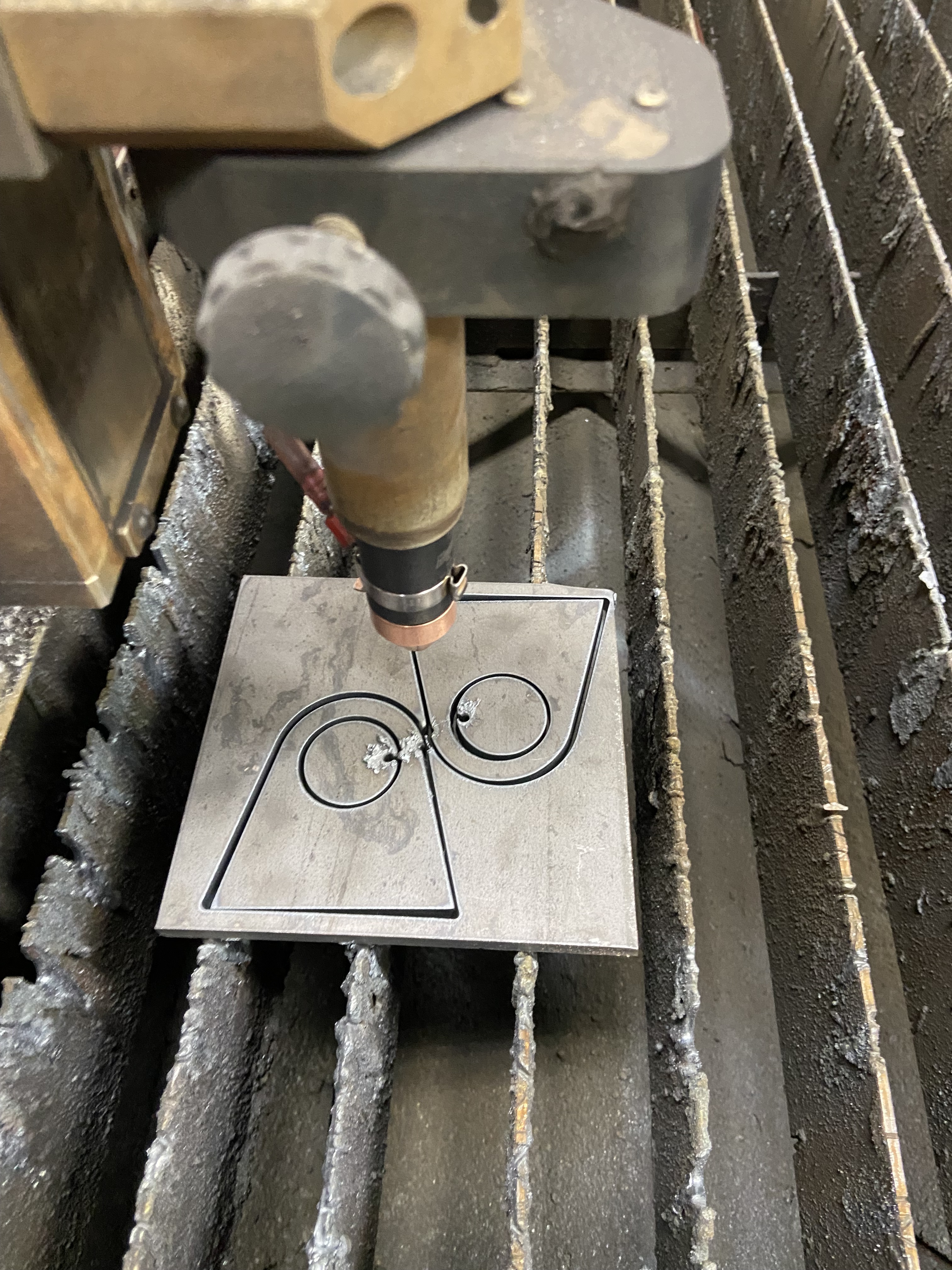

I was in class with you that evening, and was able to produce this that same night. Definitely far from a refined product, but I think it came out pretty decently.
Definitely a ton more to learn than can be covered In a single class, but I feel it was plenty to give us a good jumping-off point.
My main problem was that the generator needed to be turned on BEFORE performing a trial run. Without the generator, the program locked up. Then when I installed my consumables, the generator fault light came on. Turns out Welder Supply does NOT know exactly what equipment DMS has and I was provided the wrong nozzle. Other than those 2 issues, I was able to do everything I wanted. I just need to think up a new project, get some steel and get working on it. BTW, I’ve now sanded and painted mine, turned out EXCELLENT.
