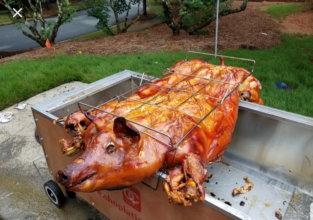

Hi everyone! I would like some advice on building a Pig Roaster box like the one on the pics. I know the wood part should be easy, but I don’t know nothing about metal working or if it would be better buying one than trying to build one. Any advice would be appreciated, also help offerings. thanks!

The number one rule when building something like this is to not use Galvanized/Zinc plated steel, because it is not food safe and can be toxic. Sadly that rules out a lot of the material that you could buy at Home Depot/Lowes.
As far as skill to make this goes, it is pretty simple. Lots of bending and some tack welding/spot welding might be needed.

304 Series Stainless Steel is a common type used in BBQ’s and ovens.
When I worked at United Technology Fuel cells, the High Temp Reformers used 310 series, it cost more but we warranted it for 20 years and was higher temp.

I forgot what gage our shear and brake will handle, @TBJK @hon1nbo. But you’ll want to keep it to no thinker than that if you want to cut and bend it on DMS equipment. It can be TIG welded or riveted. You’ll want some insulation between it and the wood frame, something like this Ceramic Fiber Blanket

however it can also be cut on the plasma table, and I would be willing to lend a hand if needed. Our table can actually do Expanded metal plasma cuts, which would give you great results for grill racks like these.
90% sure they’ll handle up to 16ga mild, 20ga stainless…

the fire goes on top. The pig is clamped down between 2 racks, and placed in the “tub”. Then flipped 1/2 through.
Seems to me like it uses a shytetonne of charcoal, but what do I know?
