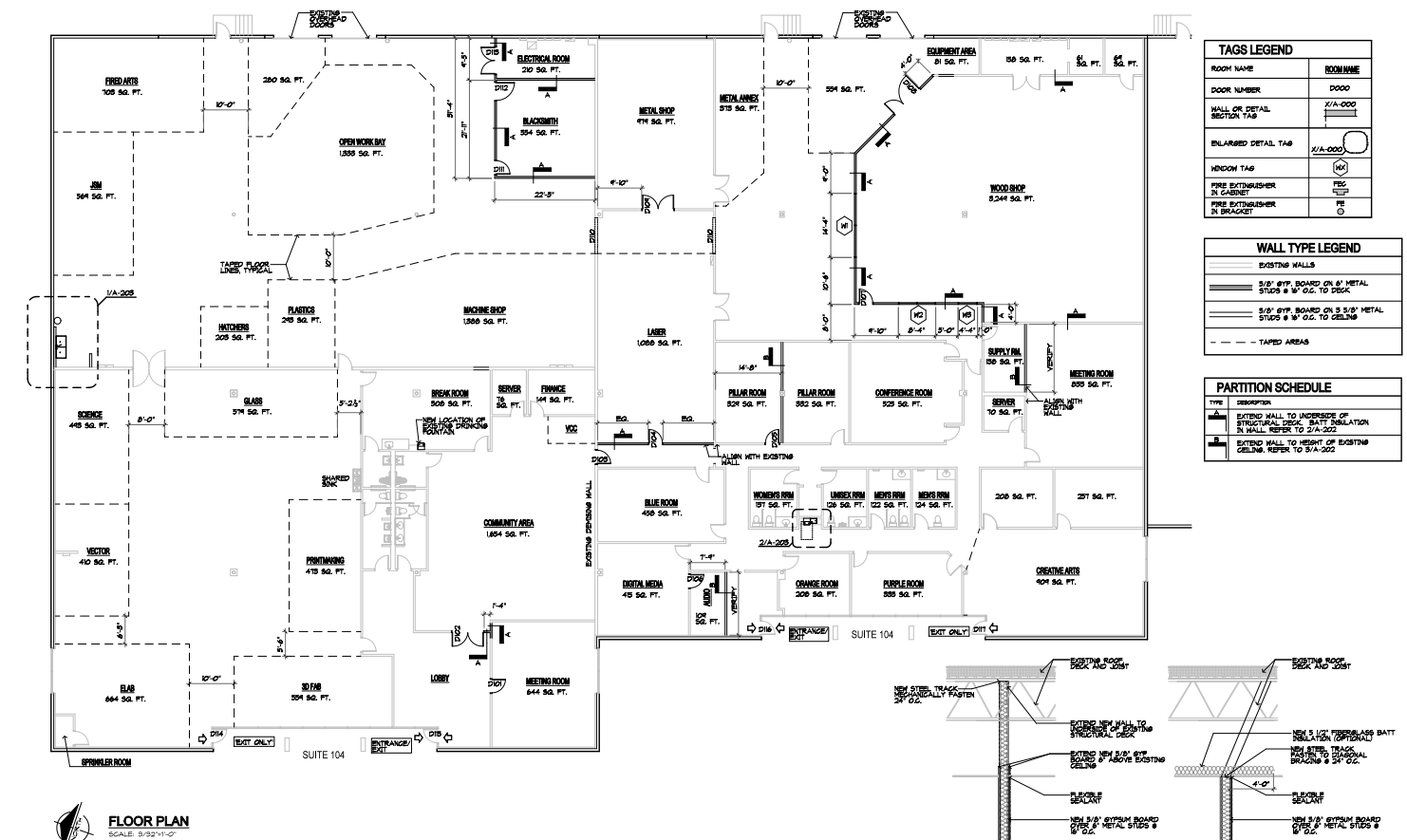

For anyone curious what the original architectural plan was you can submit an open records request here and request: “Architectural plans submitted december 2018 for 1825 Monetary Lane, Suite 104, Carrollton Tx 75006. Application 18-9139”

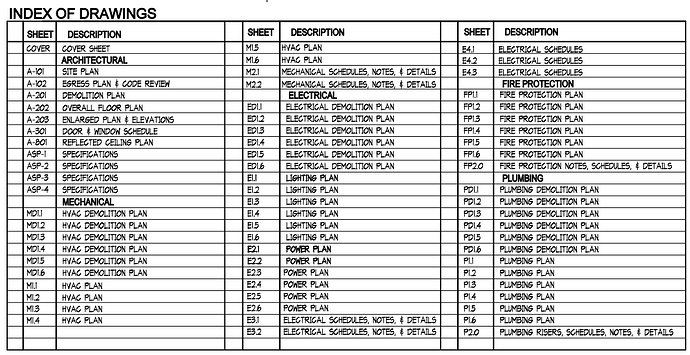

Althought I suppose they aren’t really relevant since a different approach has been chosen. It’s 69 pages detailing construction, hvac, ventilation, electrical, compressed air. Personally I think it’s interesting to look at blueprints, although I’m no engineer and can’t really follow the electrical diagrams

They are not just architectural, its the full set Electrical, Mechanical, Plumbing & Fire Protection. Often the SOW is in the drawings itself. Which consists of sequence of operations, detail views, schedules & others. 69 pages is pretty small by drawing standpoint. It is imperative that once done, we have a set of “As-builts”. This gives us the direct locations of items & how they were built. As engineers don’t always talk to each other or things cant go where they want it to go.
Always have a copy of the as built plans. It solves a lot of mysteries when you’re troubleshooting down the line, months or years after.
I might even suggest walking through the “as-builts” with the GC (or individual contractors if no GC) to make sure they are accurate! My office’s original as-built plans had a couple floor wiring boxes that weren’t even close!
