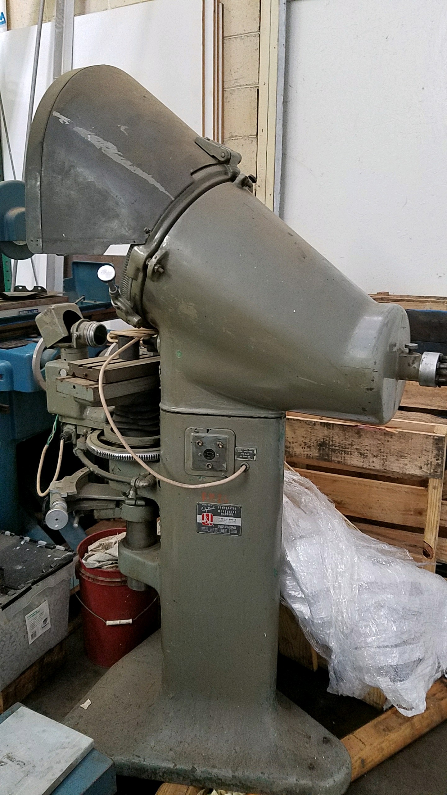

Renaissance Machine, located at 3600 Noble Ave in Ft Worth, has an optical comparator for donation if machine shop is interested. The thing likely weighs around 750 lbs. and will need to be transported with four of the strongest straps and transportation with proper tie down points. If y’all are interested please let me know in the next few days and I’ll pass along the contact information. @Photomancer seemed enthused by the prospect.

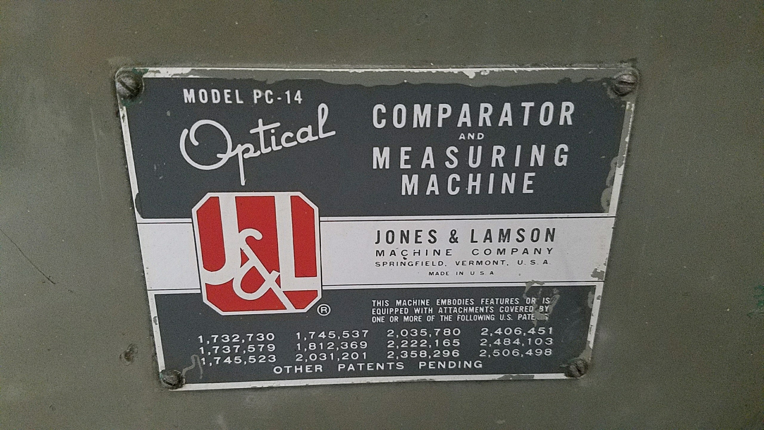

Do you by chance have a model number - these appears to be a much larger unit that I’m used to being around. But Yes, interested. This a great piece of inspection equipment.
Let me give the owner a ring and see if I can get that information
Will need to take this up at next committee meeting. A lot of members may not know what this tool does. Will also have to find out what various grids are available and the cost. I’m assuming the optics are still there, in reasonable shape, as well as working light source, bulb may be needed but otherwise OK. If not will have to see what those cost. I’ve not seen one that is cast iron before - but that would help entire stability of mirrors and optics. This is the type I’ve used in the past, weight 125#

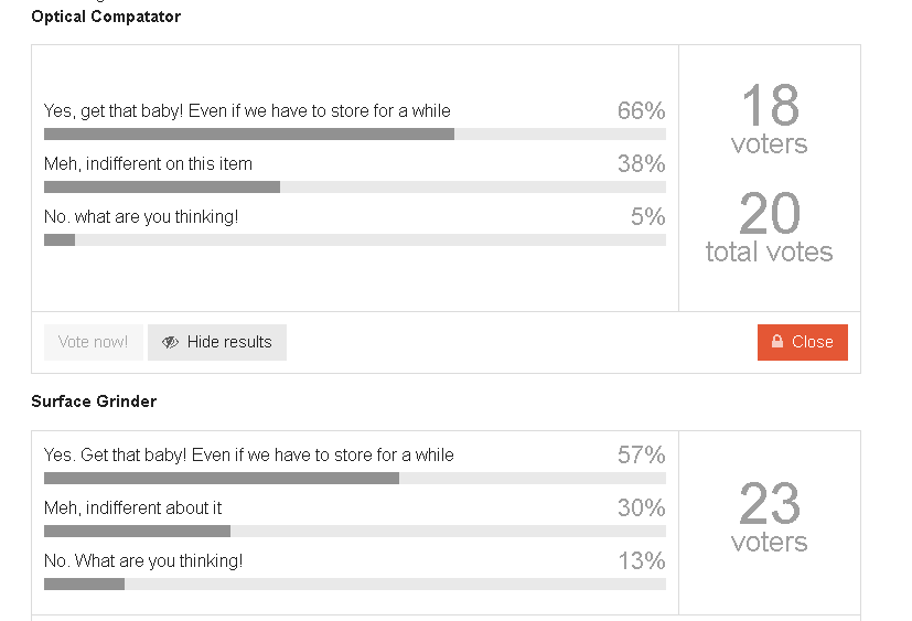

I’d like to get a nose count:
Optical Compatator
  • Yes, get that baby! Even if we have to store for a while
  • No. what are you thinking!
  • Meh, indifferent on this item
0 voters
Surface Grinder
  • Yes. Get that baby! Even if we have to store for a while
  • No. What are you thinking!
  • Meh, indifferent about it
0 voters
@Team_Machine_Shop
Just bumping, would like to be able to tell them Friday Yes or No on these two items. So please vote if you haven’t.
Thanks
I closed the voting:
66% Want Optical Comparative vs 5% that Do Not 13 to 1 in Favor
57% Want the Surface Grinder vs 13% that Do Not 4.4 to 1 in Favor
@NightRanger
@nicksilva if No objections I recommend let @NightRanger let the donor know we’ll take take them!! No need a way to get them here!
I have no objection so long as we have room and power for them . The grinder is going to make a mess. Not cleaning up after use will likely become an issue for the new janitor… uh, I mean chair
