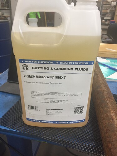

Gonna try a little of this. Found in the fire cabinet. I’m turning steel.
That is a concentration formula. It’s used for the lathe & cold saw.
There is premix in a 5 gallon container. That is 20-30 times as concentrated as needed.
I think a cheat sheet or cliff notes regarding the what/where/when/how of cutting fluid use in the Machine Shop – laminated and somehow affixed in one or two noticeable places – would help out a lot. Just from looking at that jug and a cursory reading of the label it would never occur to me that it need a ~25X dilution.
It says concentrate and gives a brix for dilution.
I think you would agree that if the front of a container has words on it that you don’t understand, you shouldn’t use it.
Additionally, the various machines have different concentration levels.
Looking at picture provided I still can’t locate “concentrate”, etc. Then again I am all hopped up on Geritol at the moment…

Thank you all for the comments. Reading back over my original question and even my follow-up regarding the Trim Microsol, I realize I wasn’t being completely clear as to what I was actually needing it for. So to back up for a minute. I was only needing some cutting oil for the Colchester lathe to brush on the cutting tool as I was turning steel. I did end up using a very small amount of the Microsol in the Spillmaster tub but barely enough to just cover the bottom of the cup. I definitely didn’t pour any of this stuff into any of the machines. :slight_smile:
When the thread cutting class began, I asked Rich (the teacher) about it and he mentioned it needed to be diluted. So, i learned something, but don’t worry, it was barely more than a cap full.
So in terms of cutting fluid specifically for the Spillmaster tub, what should I use? I still am not entirely sure.
