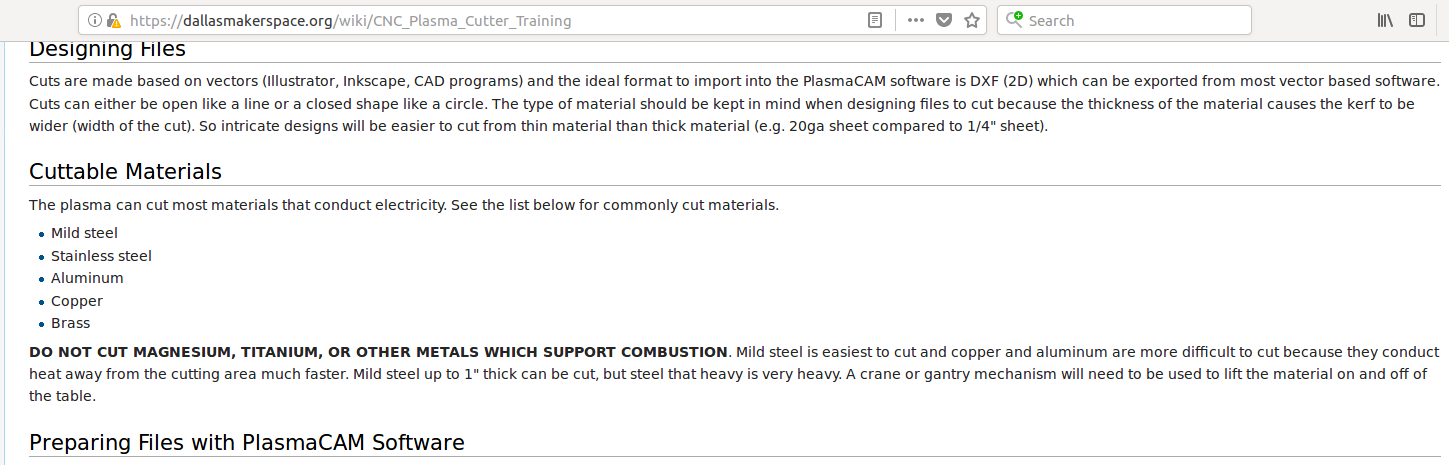

The spiel when I teach is “you can cut pretty much anything that will conduct electricity, but some are easier to dial in the temperature, and others are prohibited for other reasons; magnesium we ask you not to cut with the plasma cutter. Mild steel, stainless steel, and aluminum are listed on the reference charts for heat and speed; anything else, you’re on your own. Expect to do a lot of testing.”
A screencap from the wiki page about the PlasmaCAM:
I read the powerpoint presentation that was used, although admittedly the one I have is dated 12/11/16 so it might have been updated. My face is red :blush: - I didn’t think to read the wiki. My bad …
However, Zach @zmetzing has an excellent point that brass is about 1/3 zinc. I guess that answers my question.
You might want to update the wiki …

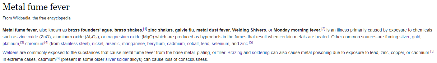

Here is the reasoning why you don’t want to breath fumes from burning / melting brass.
Source: Metal fume fever - Wikipedia
Might be a nice add to the wiki as to the why. Many of us don’t like rules that are presented as because I say so. But, giving context why a rule is needed appeases these kinds of people.

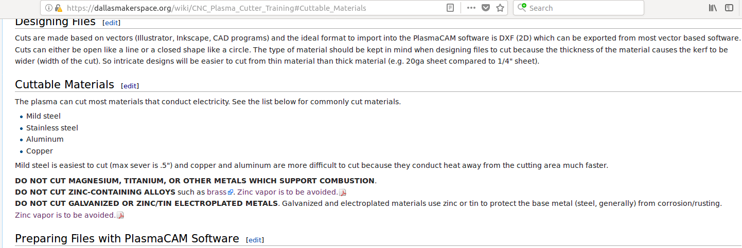

That information was, in fact, added, during the edit I presented, which comprises the “current” page as presented to the public.
Did you check that out?
Some of us also like for folks to read for themselves, and follow the links we sometimes feed them to back up the decisions made.
Here, I’ll highlight it:
And if you click that link that says “zinc vapor is to be avoided” is goes here.
https://www.cdc.gov/niosh/docs/81-123/pdfs/0675.pdf

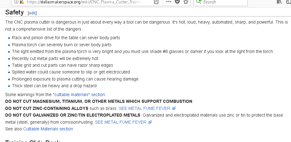

Inserted “METAL FUME FEVER” information into the “Safety” section, while keeping the “cuttable materials” section the same:
I like it,
The phrasing made me read on when I stumbled across it. :smile:
Thanks!
