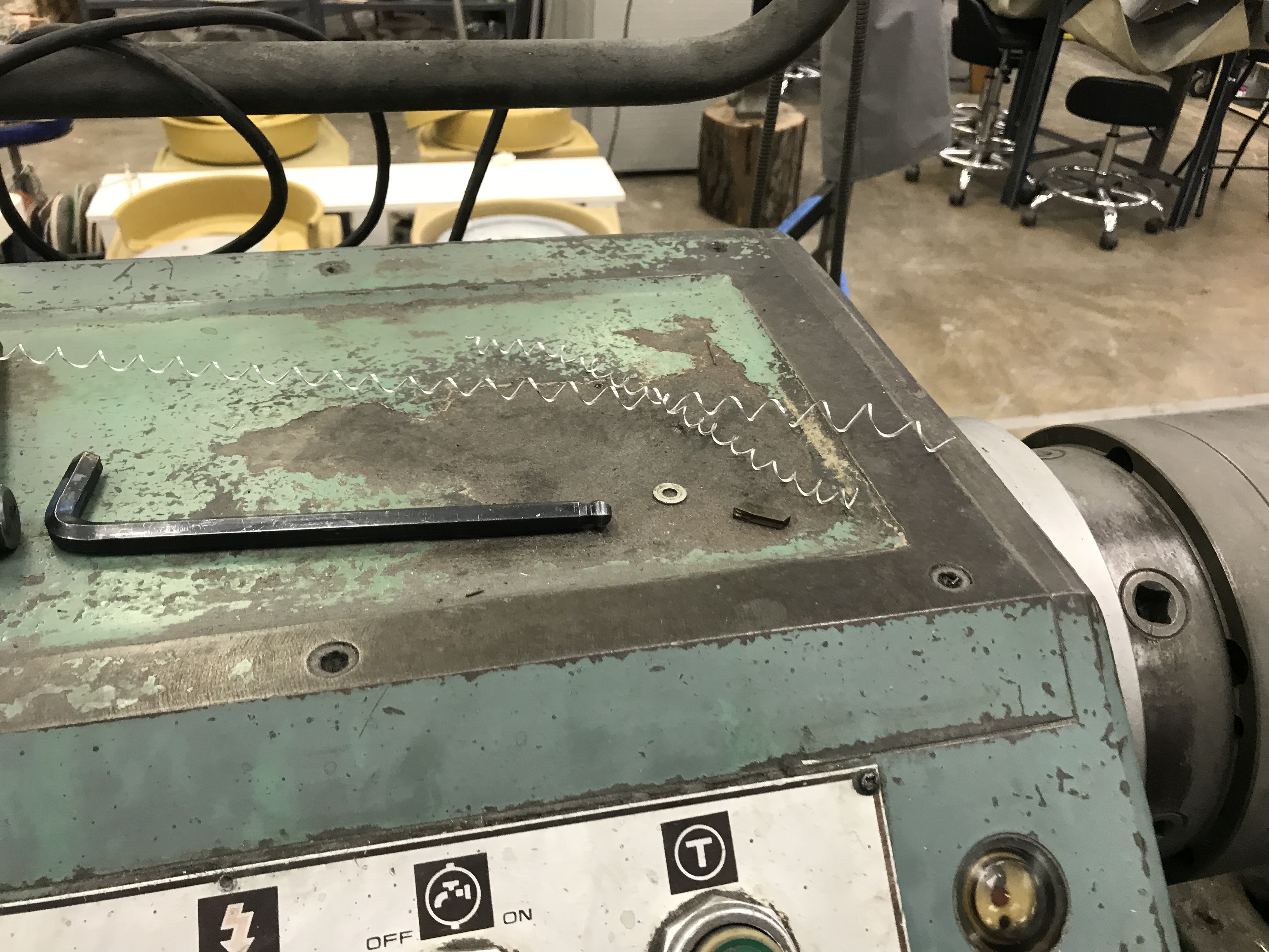

We temporarily wired it up yesterday evening to give it its maiden DMS turn. It’s not quite there yet to put into service. We still have some work to do to get it up to snuff. I did fix the DRO & smoothed out some of the tapered gib for the compound.
First turn

Played with this beast a bit tonight. I think we have a keeper…

Opened the gearbox tonight. Looks quite beautiful. Nothing obviously wrong to me.
Looked at the belts too and they seem fine. I agree all the fluids need drained and replenished.
Oh, the compound screw is bent.
Love the oiling system, seems to have good lubrication for each of the gears.
No visible debris, chips, or gunk.
