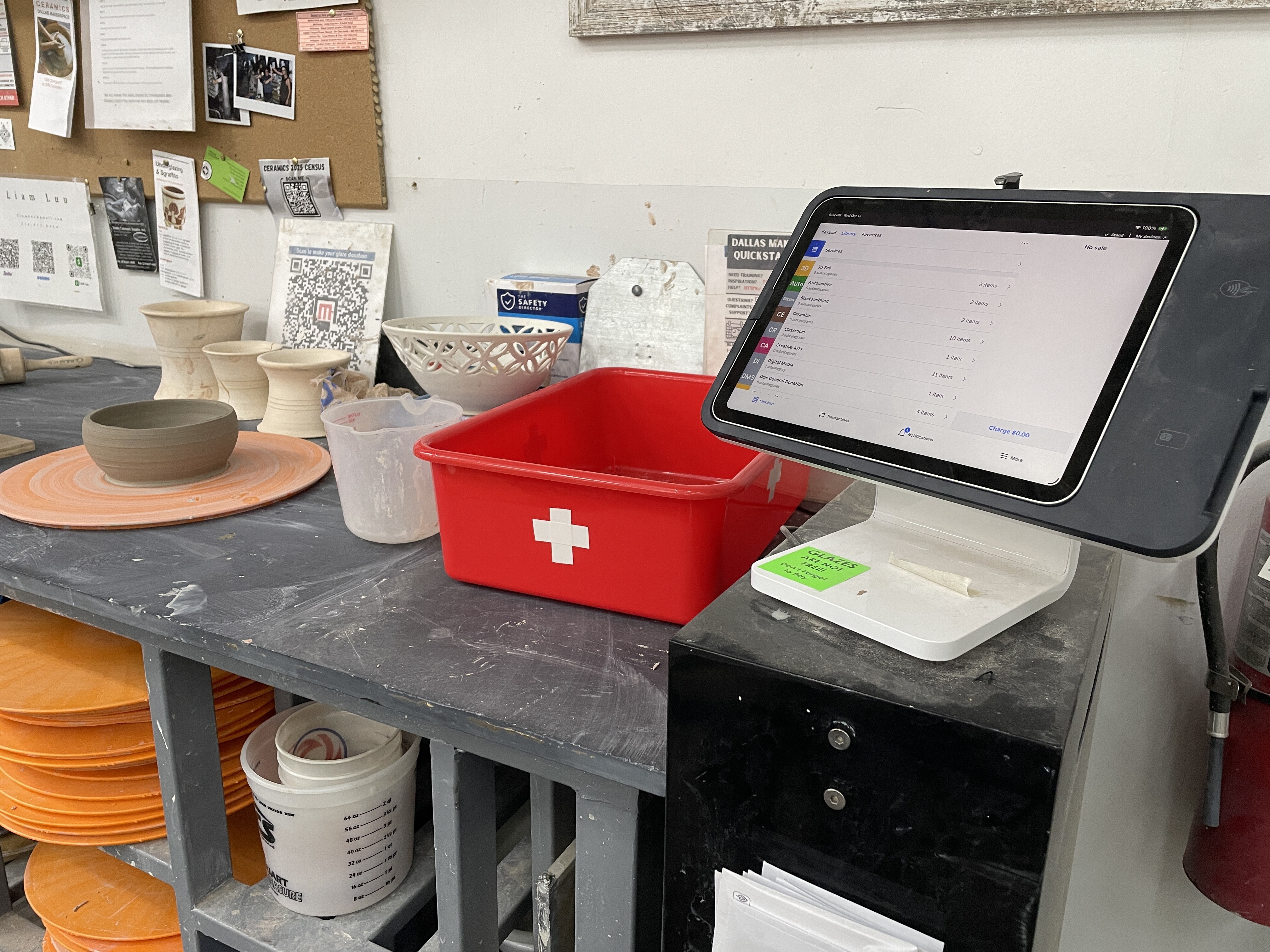

There’s a grey plastic bin on the counter by the payment kiosk for glazes that need help. The paper sign on the bin (that someone keeps taking off?) is temporary, I’m working on making a better one.

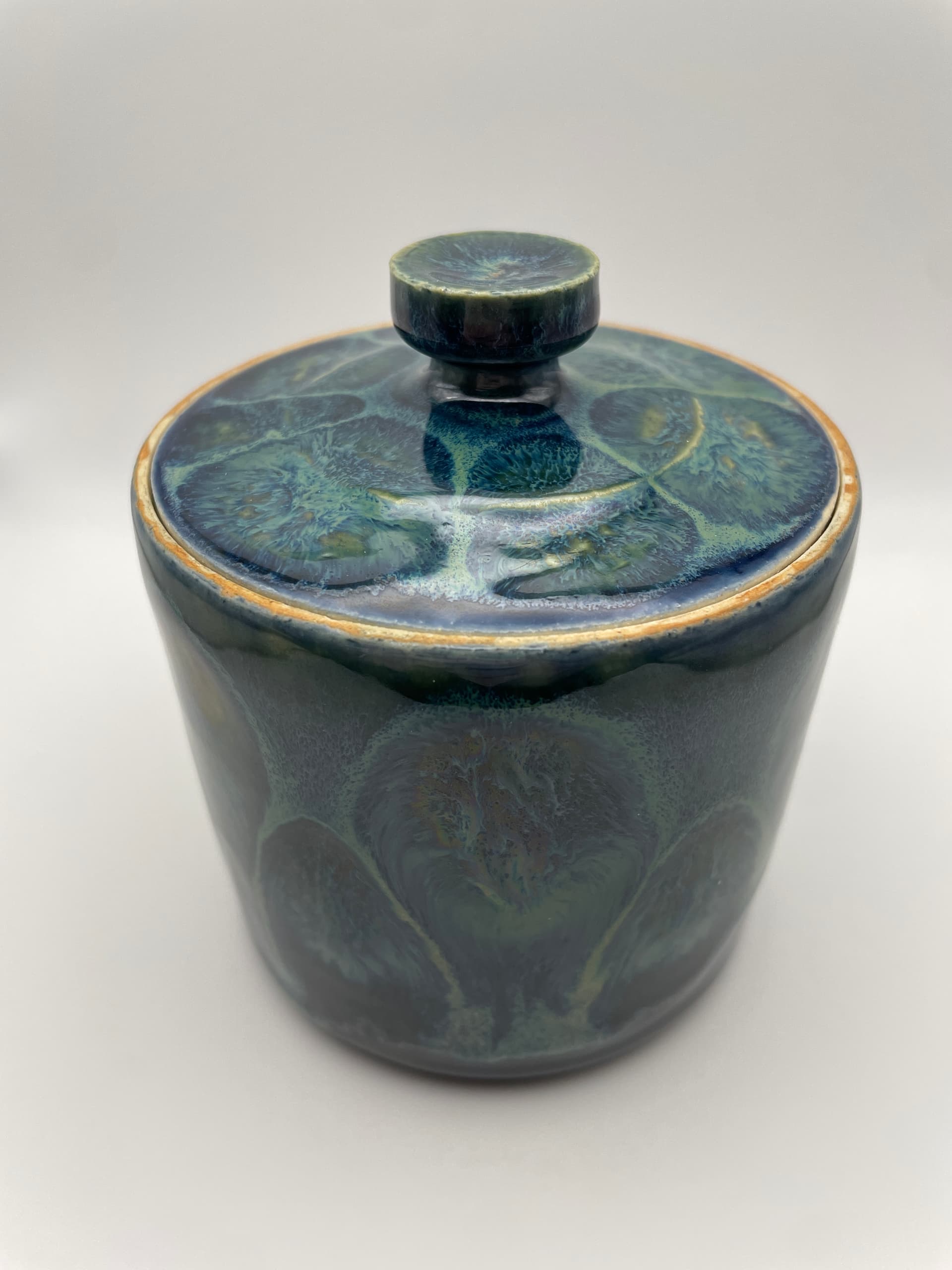

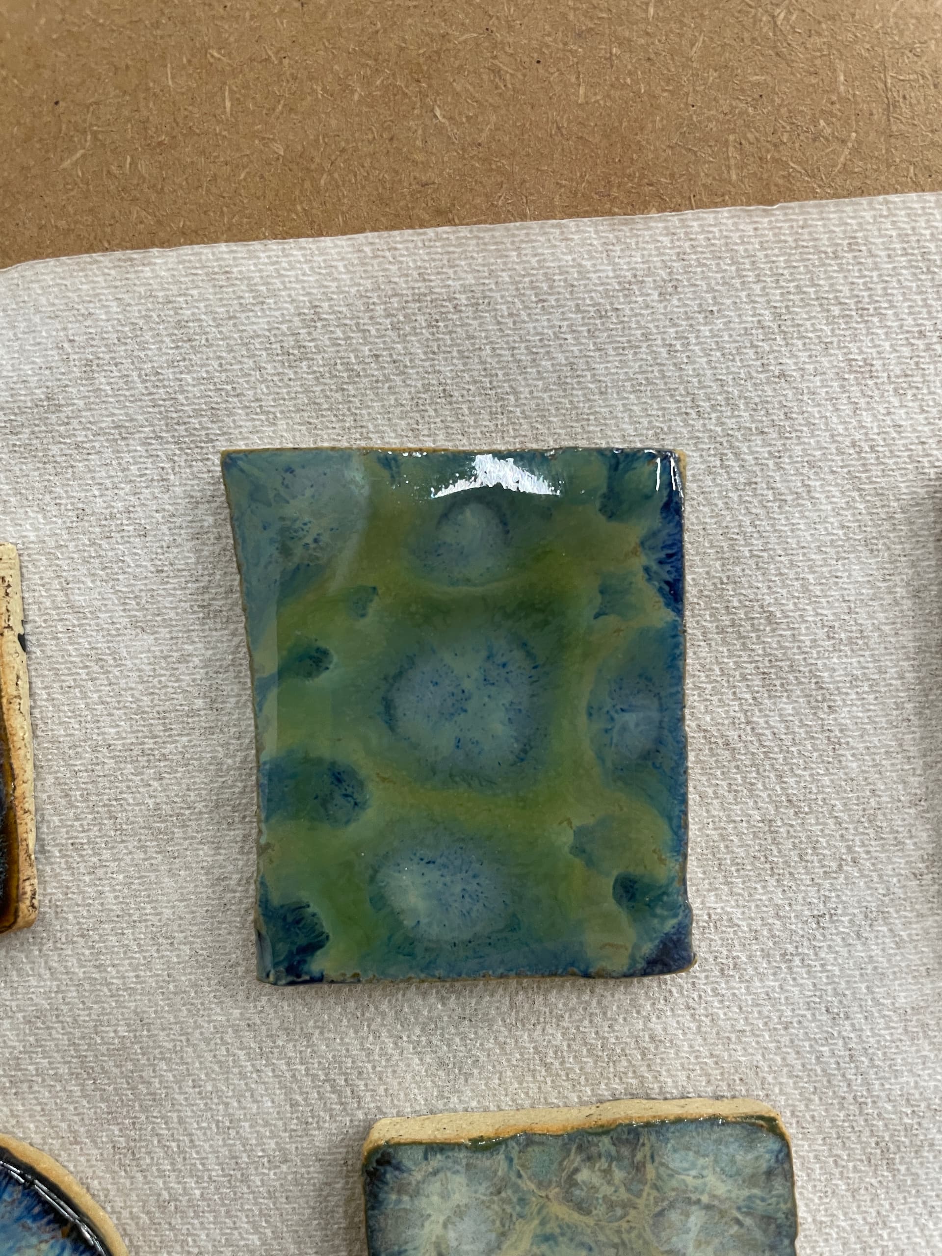

  • Watered-down glazes don’t enough reactive ingredients in “3 coats” to create the right effect, and turn this result
into this blobby mess:

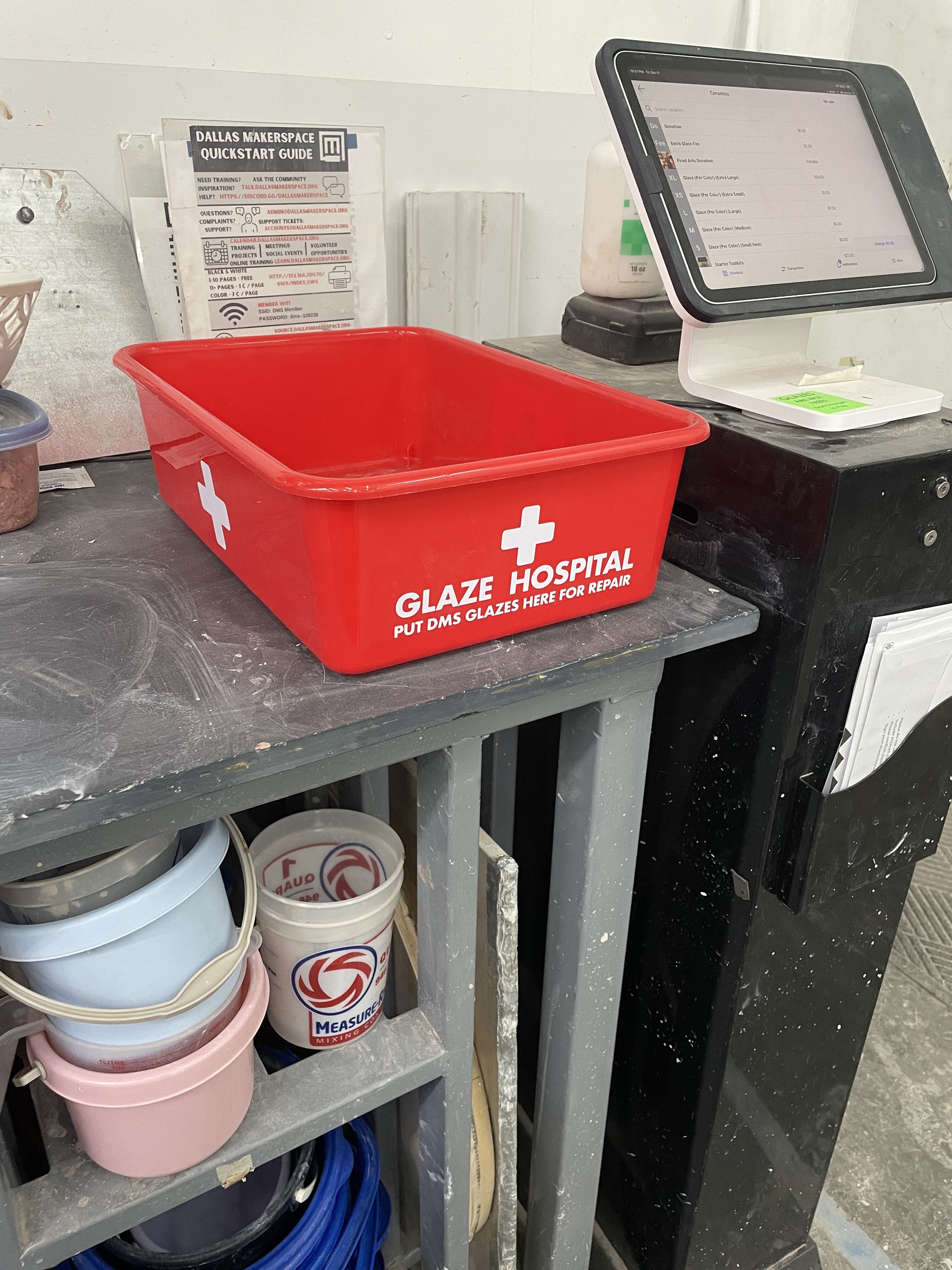

We have a new, more-recognizable bin! We’re getting the vinyl labels cut but in the mean time it has a white cross on a red bin :rofl:
It’s so cute y’all :rofl:
