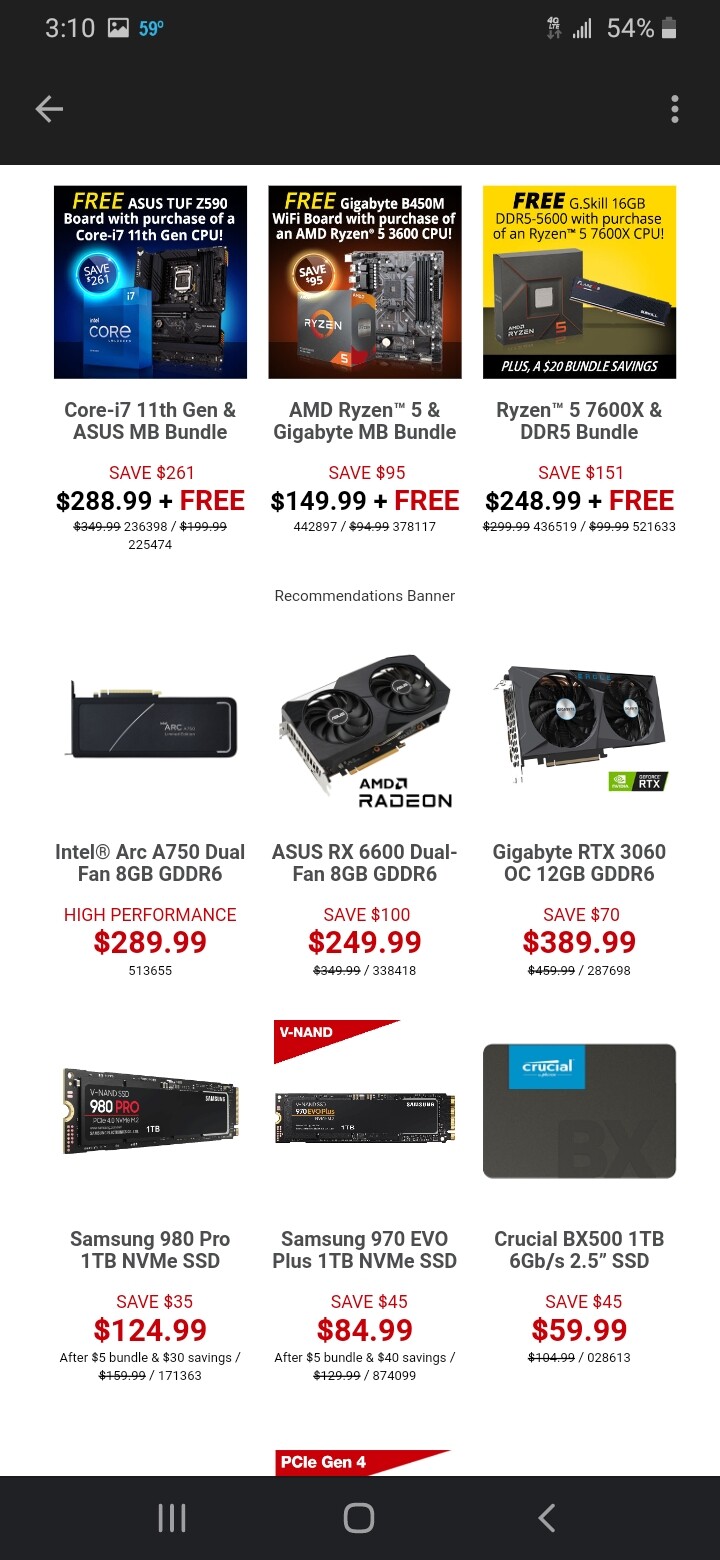

I actually just got this today…

If you still looking i just got this today…
