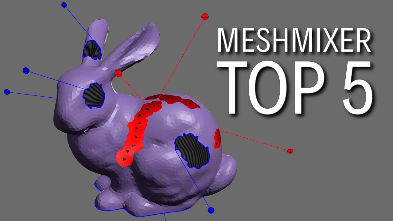

You may want to consider using Meshmixer. Maker’s Muse has a useful video on YouTube about using it.
Autodesk recommends using Fusion 360 since has similar features…
https://www.meshmixer.com/
Mesh Repair starts @8:40
