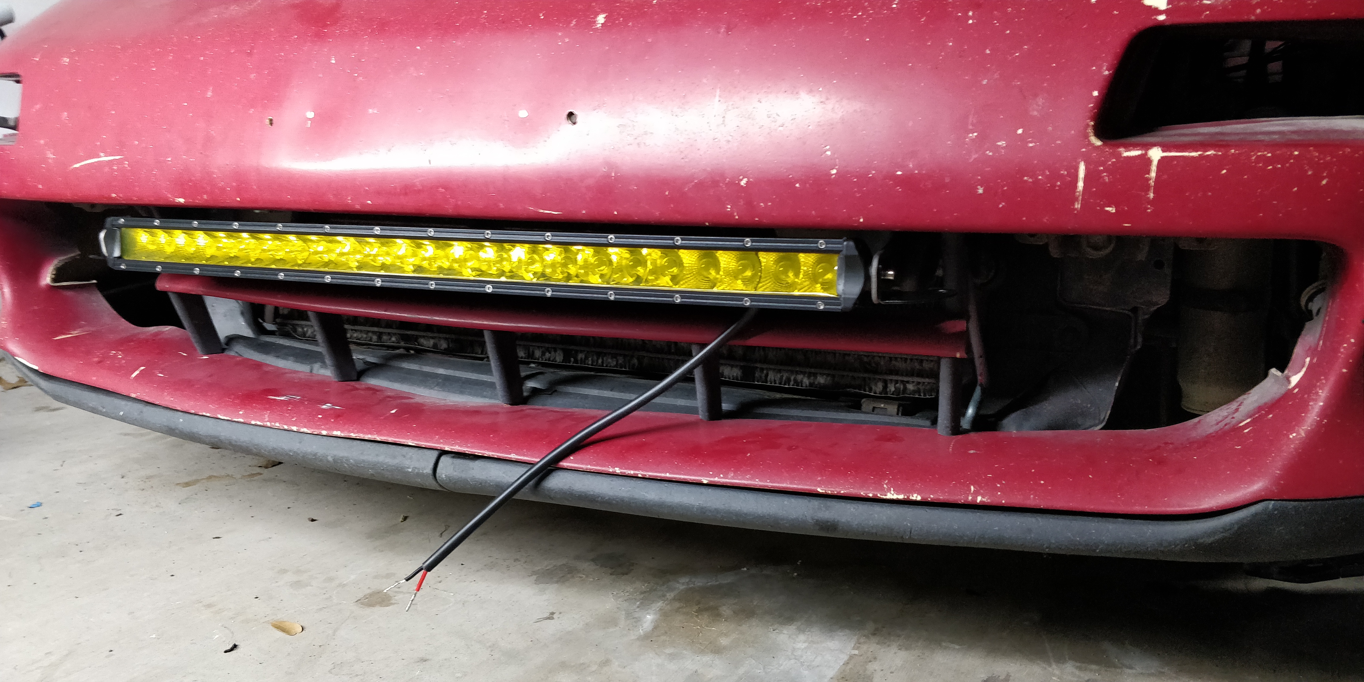

I have a bumper that has been cut for foglights (you can see in the picture where the center bar is cut out to fit foglights), and another one that hasn’t been cut for foglights. Originally I planned on just swapping the bumpers and doing some paint work, but the way the rest of the car looks I don’t think I’ll bet way just painting the bumper without it being painfully obvious that the only remotely fresh paint on the car is the bumper. So I was thinking I could cut the bits off the uncut bumper and fiberglass or something them on to the painted one so it looks like it’s supposed to be there. After that long winded explaination, does anyone have any suggestions on a product or something that I can use to attach the cut out bar part from my new bumper to my current bumper?

I didnt do the best job explaining it. That picture with the lightbar just happens to be the best picture i have of the center bad on the bumper, the lightbar is already installed. The bar im worried about is thin red bar in the center of the grill section. You can see where the little bar was cut to fit the foglights on the end.
This is a better picture showing what my bumper looks like with the cutouts for the foglights on each end of that center bar.
I want it to look like this where the bar goes all the way across
Same process as above, create and form part, then fiberglass part. Attach from rear with some of the super adhesives that will stick to plastic and fiberglass - something bridges between both parts for strength.
Touche. Guess i know what im doing then. Thanks for the help!
