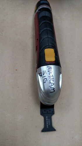

We now have two new ways to deal with onion skin and tabs once you turn the work over and can get to both your skin and tabs. Both tools are stored in the brown cabinet with the paper roll on top:
- An oscillating tool with a saw blade. Battery powered.
Looks like this:
And the battery charge is by the white paper roll:
