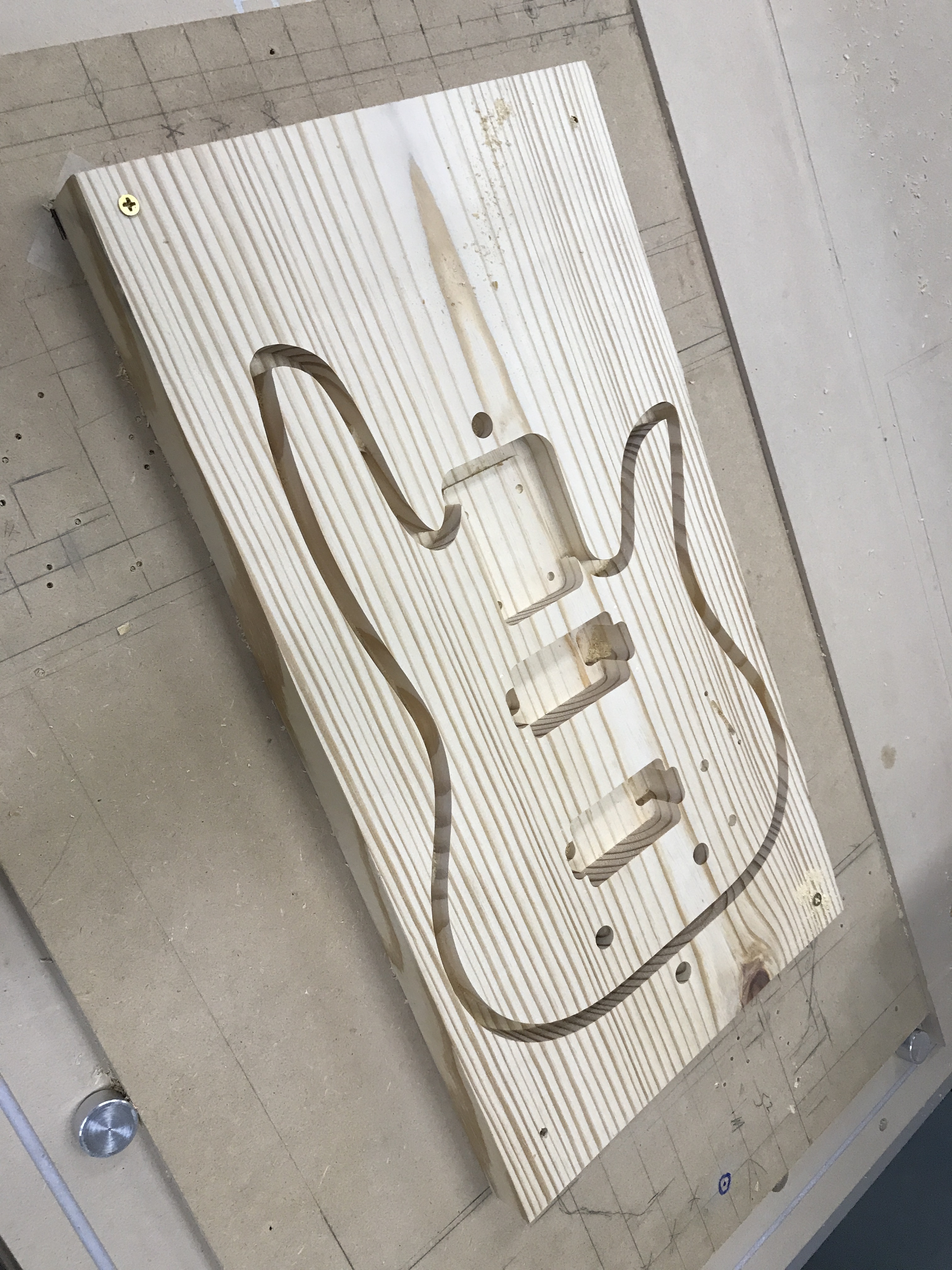

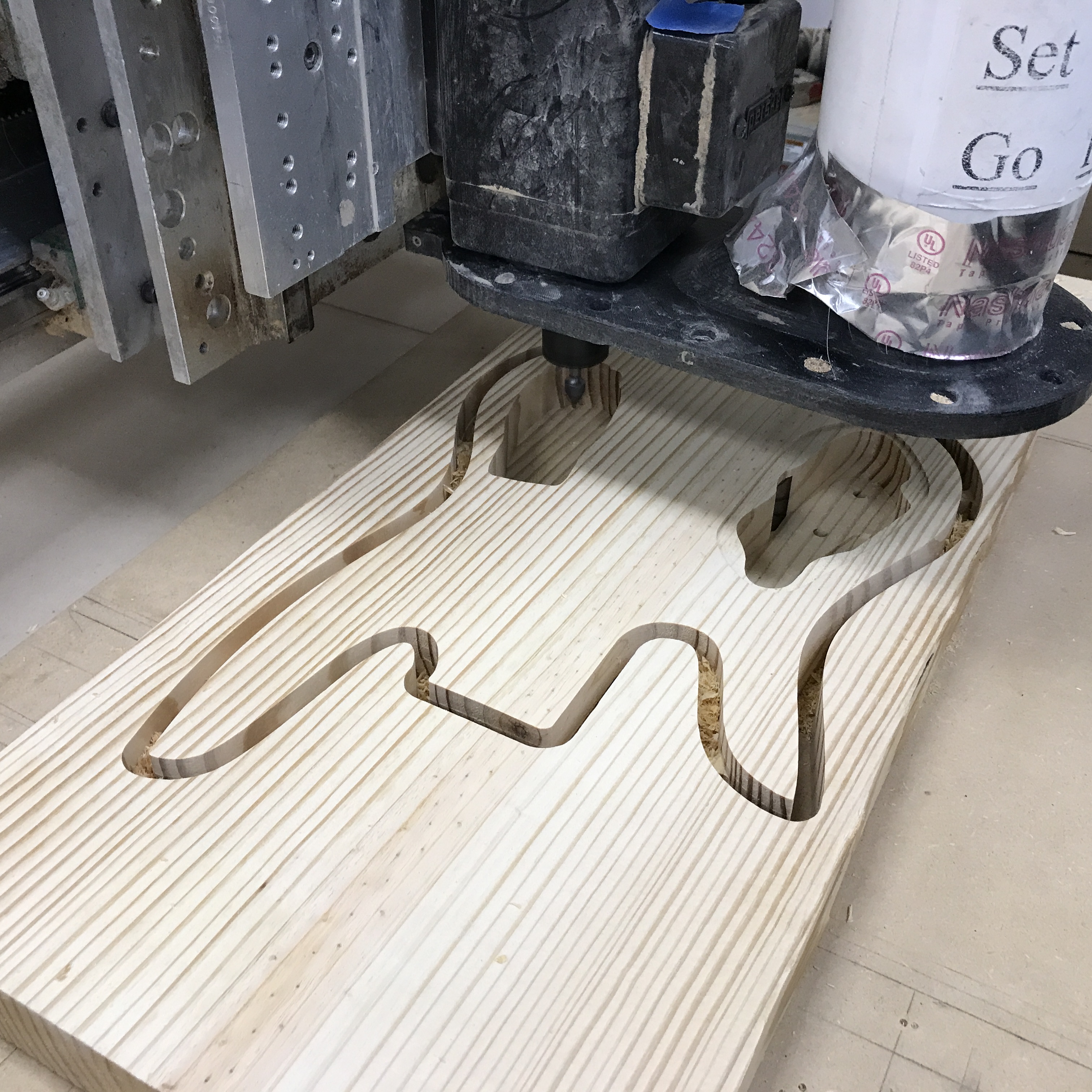

@rmramsey2 is back from his trip and is running his sample guitar :guitar:.
Slowly taking shape.
Time to cut the back side.
One guitar body ready for sanding.
