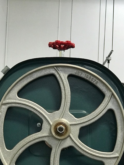

Greetings. Now that we have the throat plate, I tried putting a blade on the bandsaw and noticed a few more problems.
  • The tension drive screw or more likely what it goes into is likely stripped. It tensions a little then slips back to no tension. I didn’t have time to take it apart more but bottom line it won’t tension. The red knob is where you tension it.
  • It needs a couple of blade guide blocks (cool blocks).
This blade was way too big. Likely 150" rather than 105". I left it on the table. It might fit the big bandsaw.

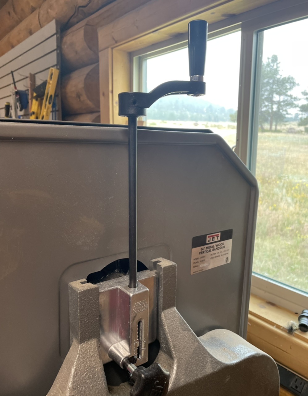

I was able to buy a replacement tensioner for my Jet bandsaw. The original cast metal part had cracked. Ironically, it was cheaper to replace the whole tensioner than just that part.

Assuming the assembly I bought would NOT work for the DMS saw, I believe that it would not be too difficult to fabricate a replacement at DMS using some all-thread and a square nut made from a tapped piece of 1"x1" x1/4" (25mmx25mmx6mm or similar) square stock. I believe the part is a metric part (since the wing nut for the lock knob is listed as an M8 part).
On my saw, the nut is the only thing the tensioner thread interfaces with, so as long as the threaded rod fits through the holes in the other parts and the square nut is just small enough to slide snugly into the assembly, I would think that either metric or equivalent moonwalker unit diameters would work.
Here’s my saw with the replacement assembly and an upgraded handle on the top.
FWIW, I think the handle at the top for adjusting the tension works better than a knob: I had previously made this upgrade to my saw.

Oh ok I just remembered that red adjustment knob patch cause when you try to adjust it standing on the ground it hurts your hand like hell
