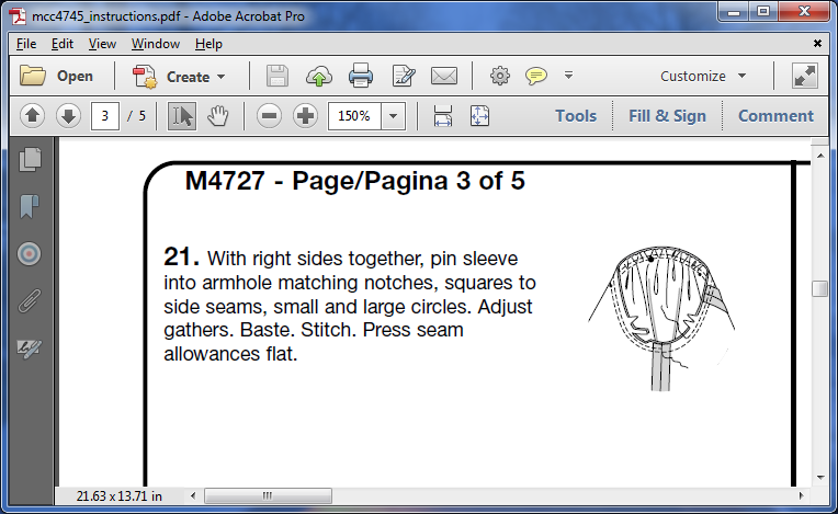

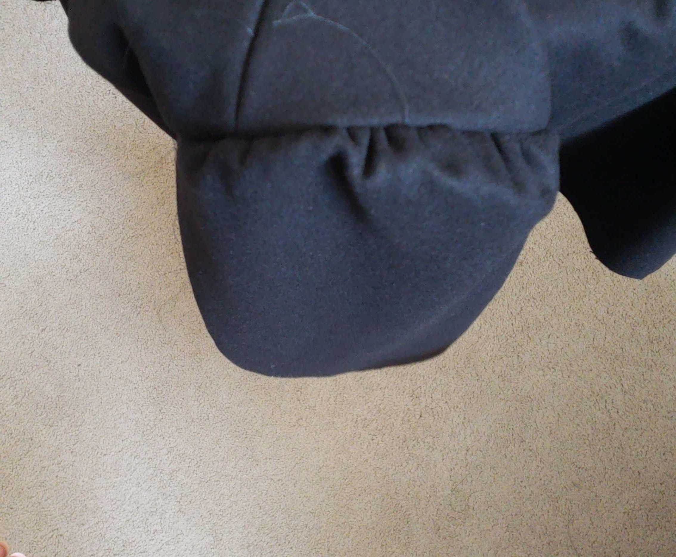

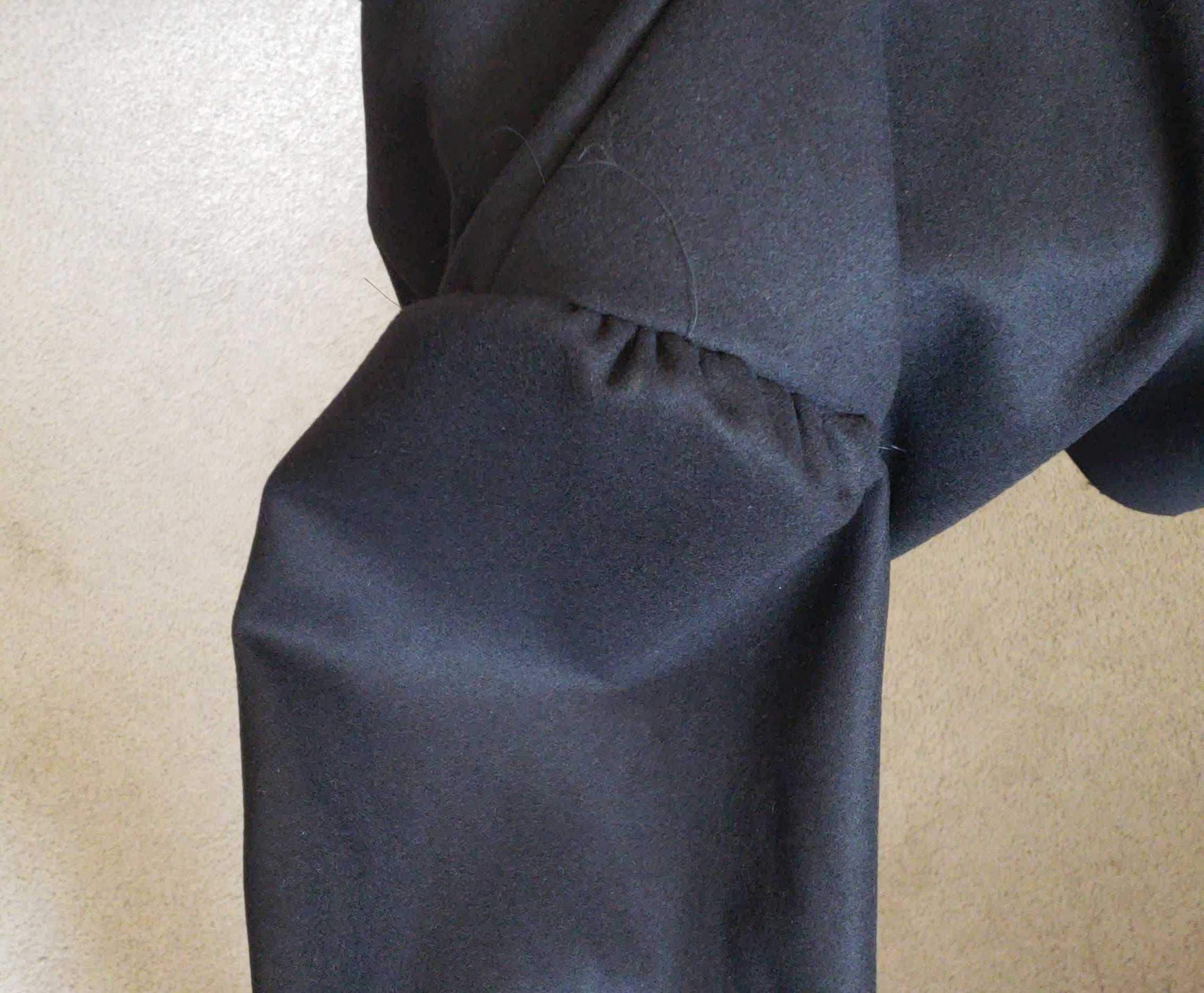

I’m making a coat. I’ve just attached the first sleeve, and the pattern called for gathering the sleeve fabric at the top, then sewing it on. I’ve done that and I dislike how the shoulder is gathered/bunched. It looks like the shoulder of a womans’ coat really.
So I’m looking for advice on how to modify the shoulder so it doesn’t gather, hopefully resulting in a shoulder that looks more like a suit? Any advice is appreciated.

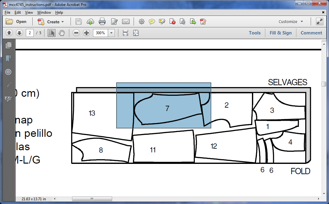

This is the pattern shape ( number 7), then what it looks like attached.
As far as I know the easiest way is to have a pattern piece for a sleeve that you like better and alter this one to match, but that’s not going to work for you since you don’t have one. Can you measure the armhole on the body and figure out how much fullness is in the sleeve that’s extra? If so you could take that information and basically do the opposite of slashing and spreading by removing small wedges of the pattern piece until you are closer to the armhole circumference and then tape the pattern together with the smaller sleeve cap.
Basically the opposite of http://isntthatsew.org/slash-method/
Start with Cindy’s @sinless suggestion to measure your armhole. Then you need to reduce the fullness of the sleeve to match … but only above the elbow to the armhole cap. This picture shows the pattern folded in half. You will be removing a wedge (in your paper pattern) from E1/E2 up to K1/K.

Between this and @sinless suggestion I think I got it. I was worried about the sleeve getting to narrow if I took out a strip going to the wrist.

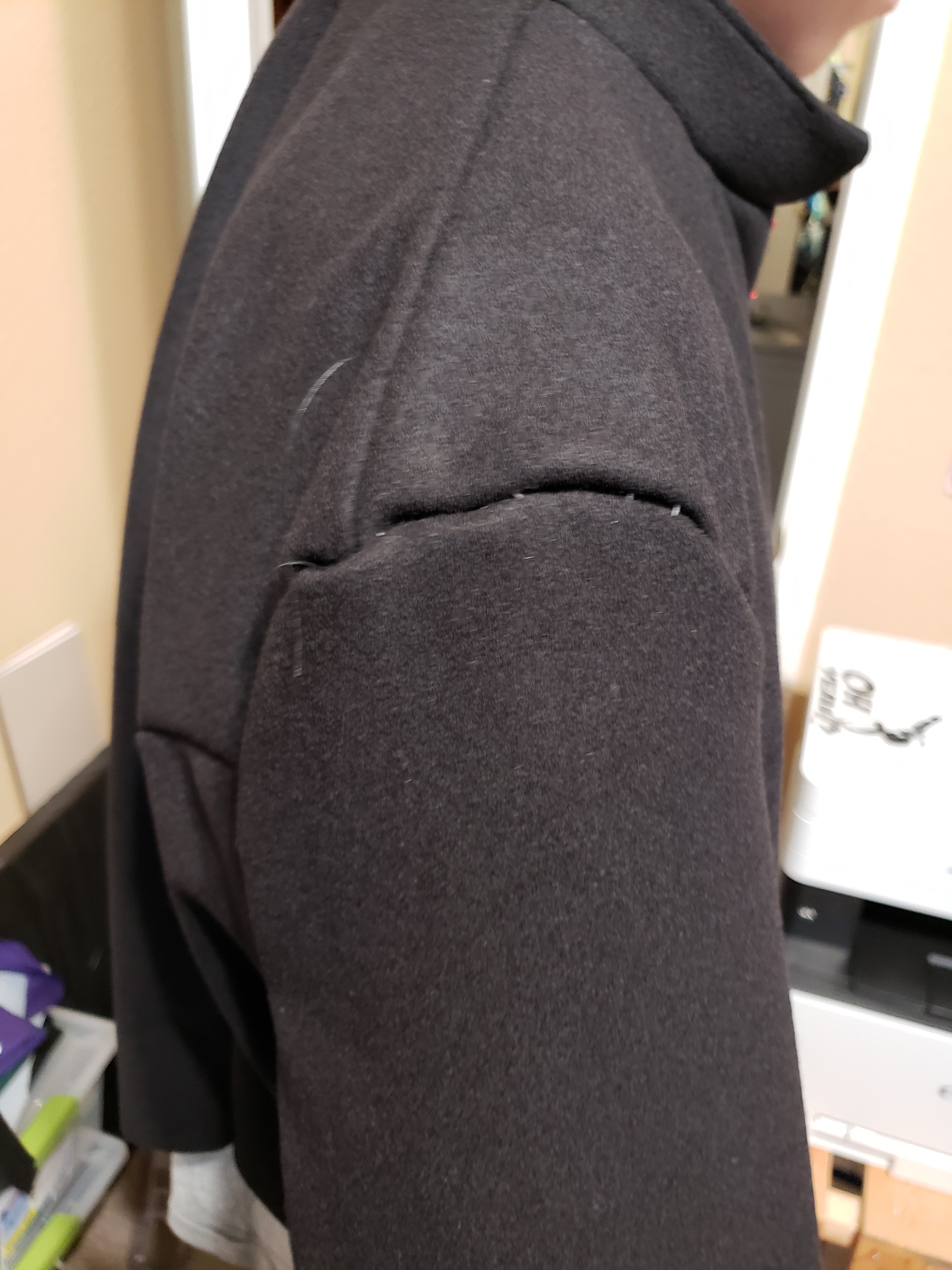

Looks like this technique is going to work for me. Thanks KS for the help. I had to cut both a strip to the elbow as you suggested @John_Marlow and I also had to trim back the shoulder curve, but it looks good now. Thank you all again.
Hand stitched with white thread for fit. I’ll post pics when it’s done if anyone is interestesm.
