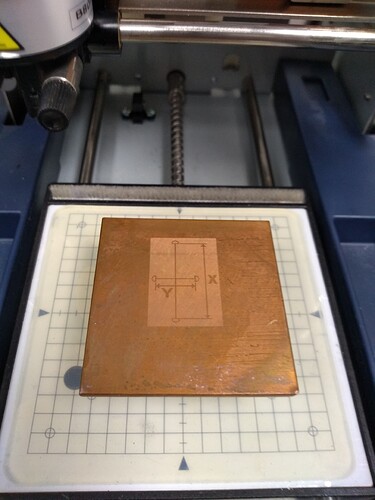

@dougemes – as I understand it, the Metaza is sort of dead. Mostly unrepairable, yes?

It will take someone with far better eyesight than I to try and disassemble to replace the failed limit switch mechanism for the threaded rod axis. @themitch22 had mentioned he might be game to look at it.

its not the head, its the rest of it. We actually tested out both heads slightly before the limit switch broke. on the “current” head only 2 of the 8 needles/pins/edges are actually kaput. It only uses 1 of them at a time, so the heads we have are fine.

Limit switch was cleaned and now is working.

If it gives any more trouble we’ll need to get a replacement one. It’s a simple optical transmit/receive pair - an infrared LED and a phototransistor in a package.
