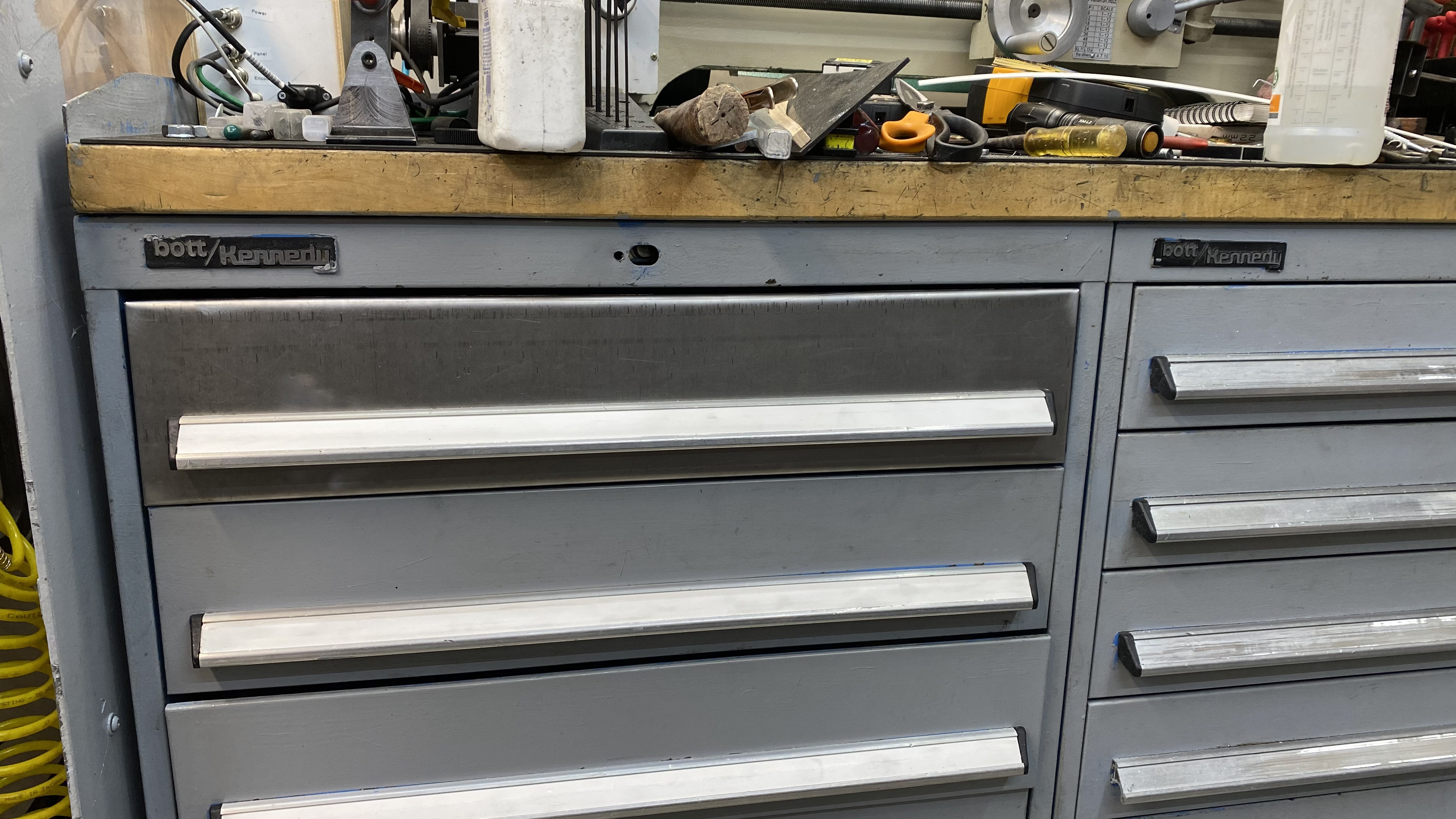

Here are the results. Not perfect but passable for my first time using the metal brake for an actual project. Not sure if it’s obvious but the top long bend is the one that was a bit more rounded over. More in the distance in the second picture. Then I made matters worse by drilling the holes that oriented the bad side up. Dohhh… But I have plenty of sheet metal so I’m gonna try another one sometime this week. What I really need to do is to bite the bullet and but this on the plasma table so I can’t get it wrong. Or at least it will be a different kind of wrong… ha ha. Then I can focus on getting the bends correct.
Dude, that looks damn good. Especially if not real familiar with sheet metal work: calculating bend allowance, set-back, spring-back allowance, etc. Inside work very good and pride worthy. Once it is painted it won’t be noticeable at all (Except of course to you. Whenever we make something all seem capable of seeing are the errors).
Thanks much David. Sorry I didn’t even see your reply till now. Brightened my day!
