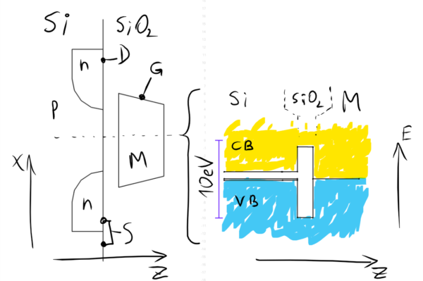

Mess with the subatomic structure of a MOSFET
