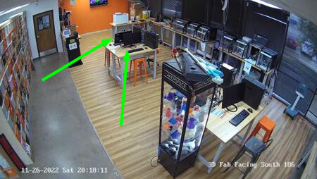

There are two workstations in 3D Fab that have the Chitubox slicer (green arrows). I don’t know which one is 3dfab-05. The slicers are different versions (which is actually a good thing because the firmware on the resin printers varies).
Try creating a .ctb file on the other workstation. I routinely have the problem you’re describing. One slicer works with one printer, and the opposite for the other one. I don’t remember which is which.
@engpin … please do not update the slicer that is still version 18. I think that’s on the south workstation.
