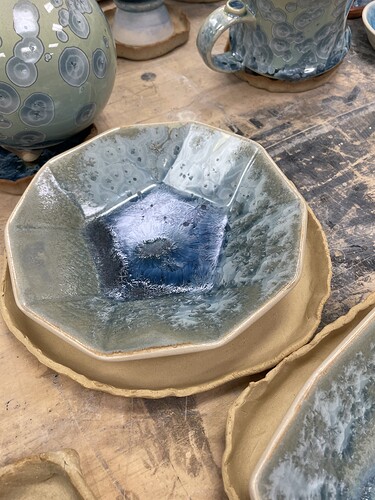

Another round of Macrocrystalline firing is under our belts! We had a lot more variation this time around which isn’t always as satisfying but we were able to learn a lot more than previous firings. We discussed pot shapes, kiln locations and firing schedules as we unloaded this morning and I wanted to mention them here for future reference down the road.
But first, photos! If anyone takes especially glamorous shots of your pots, please add them to the thread.

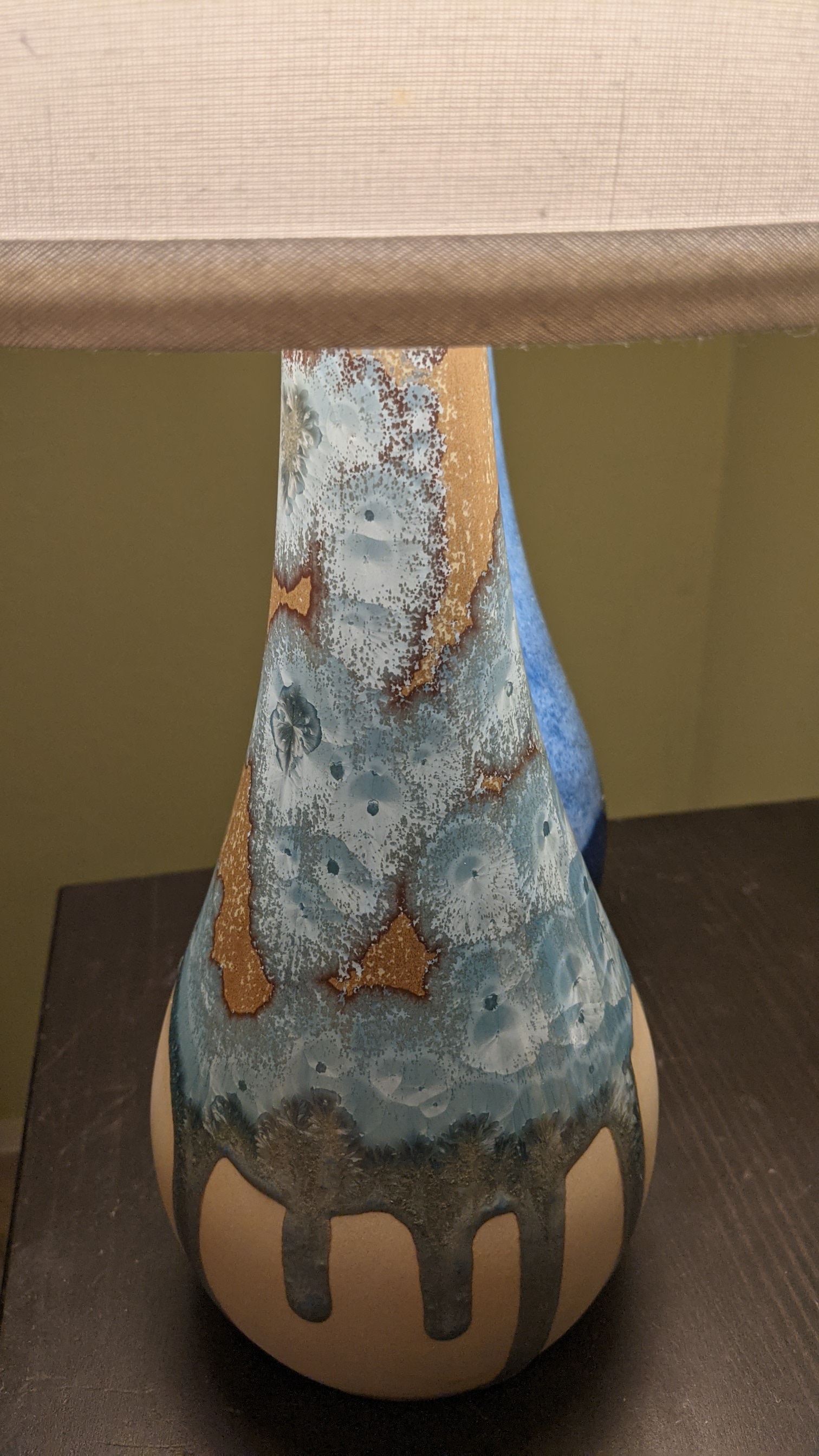

It’s lamp.

Pretty :heart_eyes: :heart_eyes:
