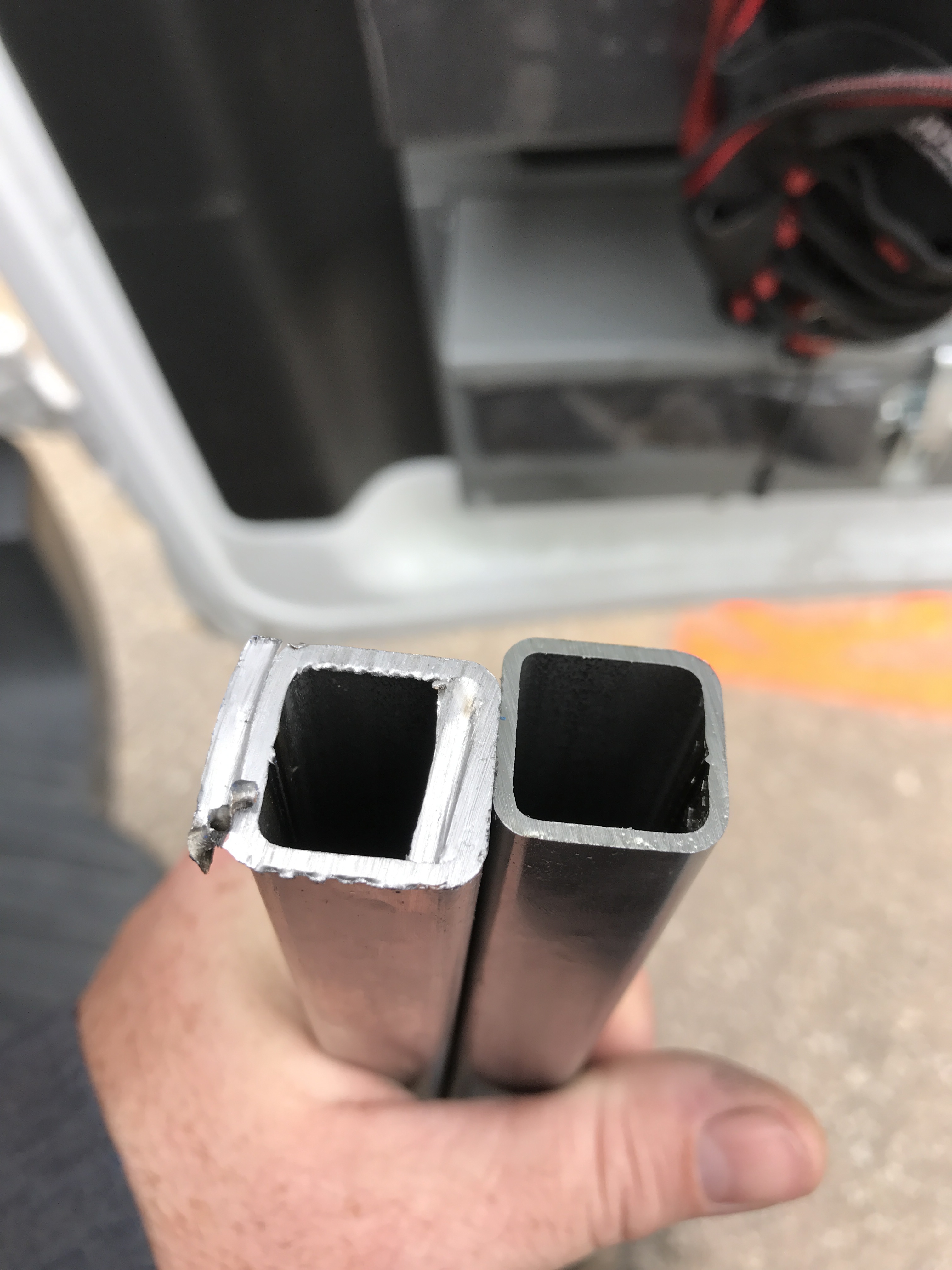

A before & after the blade change picture.
That is an awesome improvement, and well due!
Stall usually indicates a dull blade having a hard time cutting.
