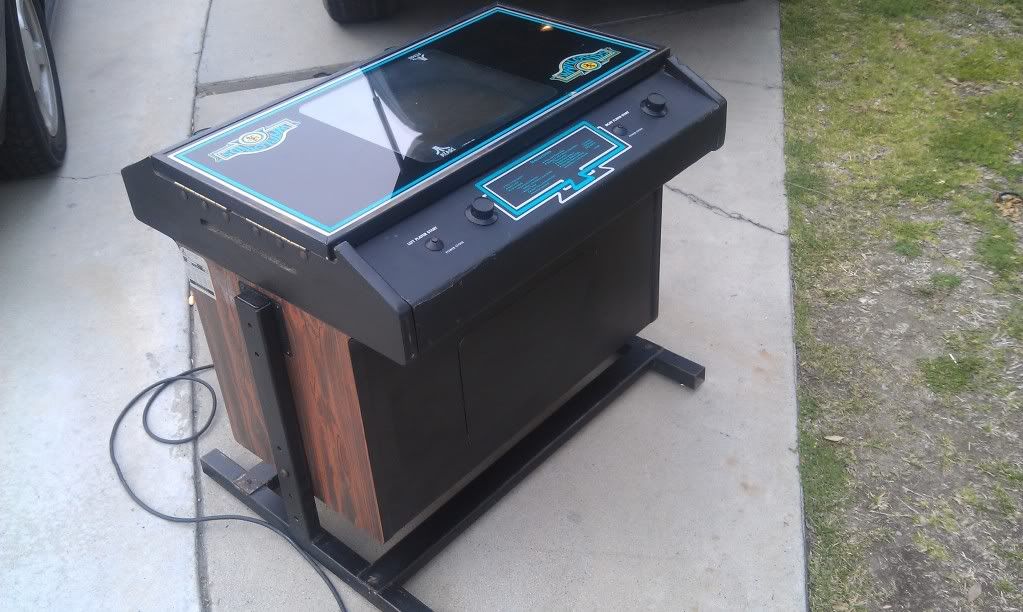

I’m starting a project to build the Ultimate Atari Warlords 4 player arcade. Example:
