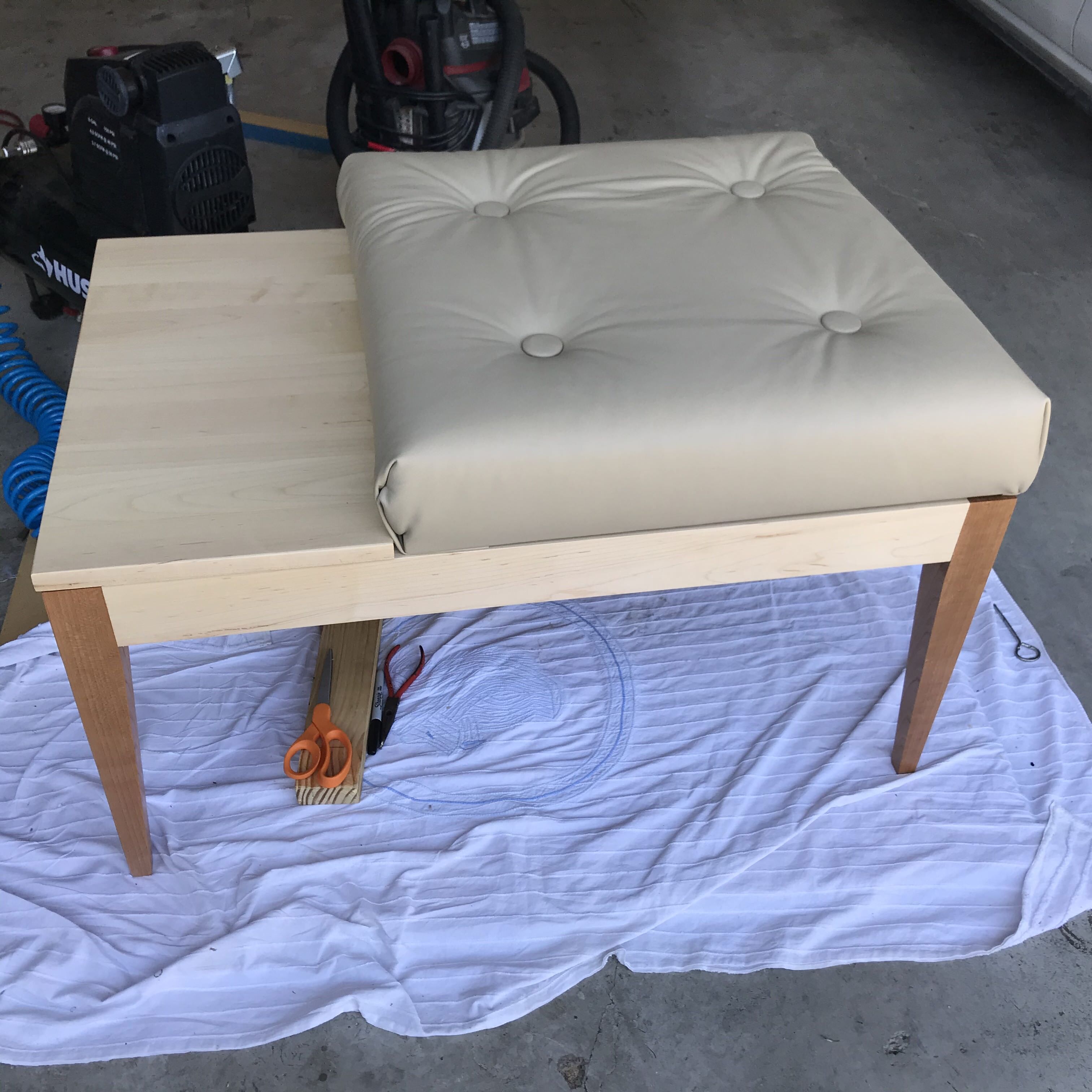

I actually haven’t attached the top or cushion to the base. I’m happy with how the cushion turned out(minus the untucked portion in this photo!), but it looks like a couch cushion sitting on a small table, so I need to rethink my proportions.
