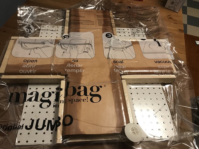

I bought chisels. I do appreciate the offer. I also just bought cheap magic bag to just give it a try. Worst case is it doesn’t work.
I’d try putting a flat piece of plywood in the bag to encourage the backs of the pouches to stay flat. MDF is porous to vacuum pumps, so perhaps a piece of MDF instead.
Second attempt, we shall see. I ripped the first bag & was also frustrated with my Dyson as that hose has a “teet”. Used my bucket head vacuum.
