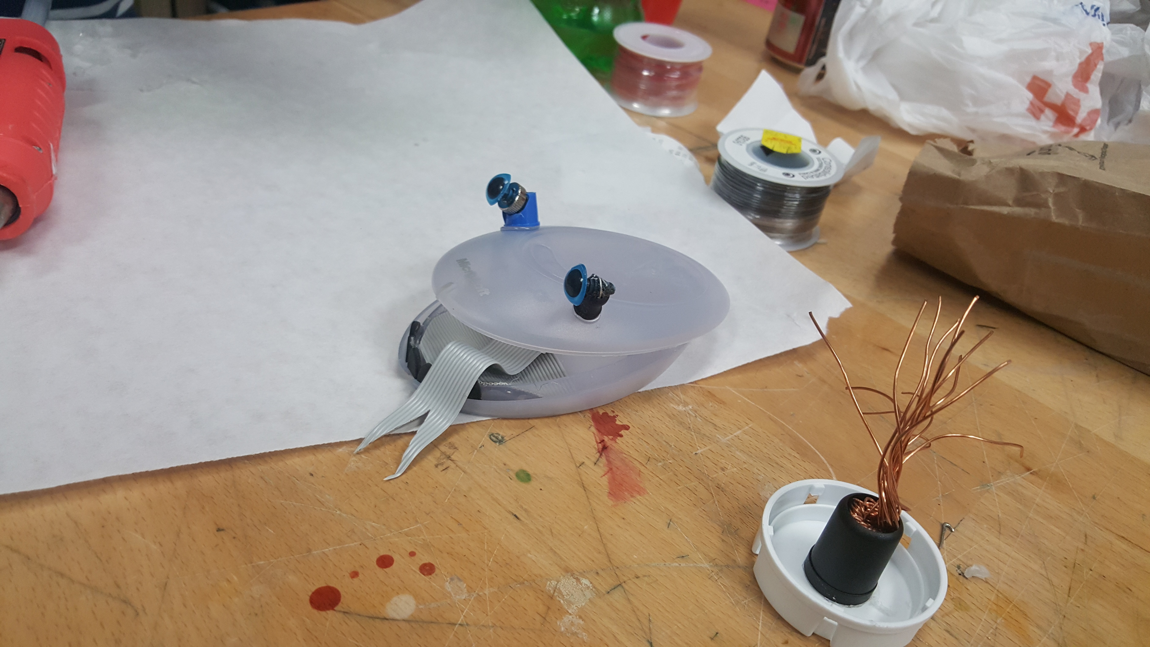

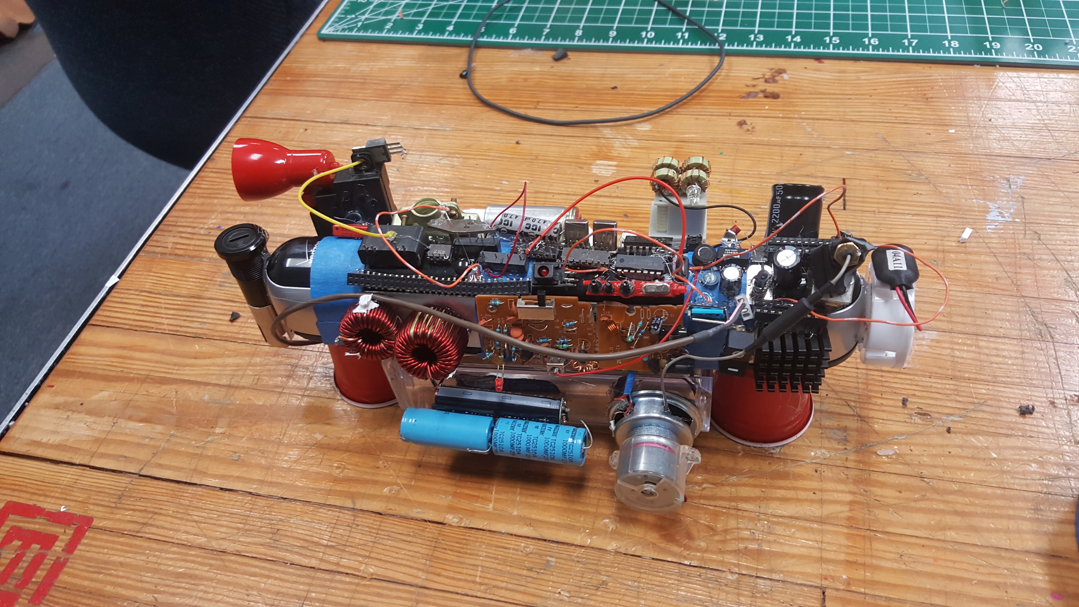

We will have the last class for doing some final edits to the space ships. This will include finishing adding details, adding LED lights if wanted, and painting the models.
Here are some pictures of our progress.
