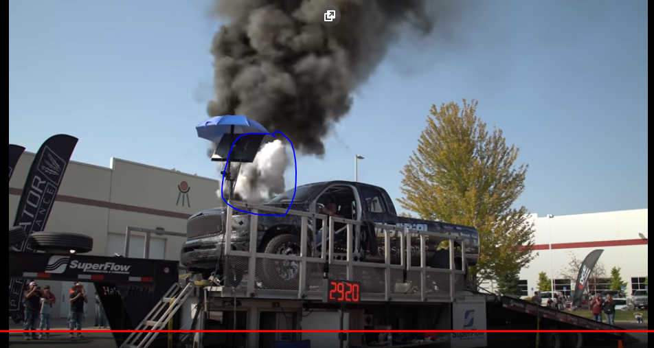

So I came across this in an email a couple days ago. Thought I would share it. Just remember, Just one more time…nothing can ever go wrong there. From what I read, he did 2920 HP then wanted to cross the 3000 HP.
What causes all the black/grey smoke? (I mean before the explosion…)
Hmmm…catastrophic block failure…
Surprised there wasn’t more shrapnel out among the spectators.
just a little more boost…
just a little more rpm…
just one more ECU tweak…
just…POOF!
Hard to say. Could have been a few different things. Nitrous, Oil or maybe coolant blow by.
That is certainly where I would have stopped.
I agree with Tim; not sure, but I think he was hitting the NAWS when these happened, but I suspect the “white” smoke is caused by coolant making its way through the combustion chamber.
I think he didn’t have a chance to shut it down, and all the gyrations after this, were trying to prevent the inevitable: 3000+ horsepower of self-fueling rage from pushing a Cummins 6.7 beyond its capabilities.
For sure, it was grenading once the black smoke stopped (because then, it’s running on something other than Diesel fuel; probably engine oil).
