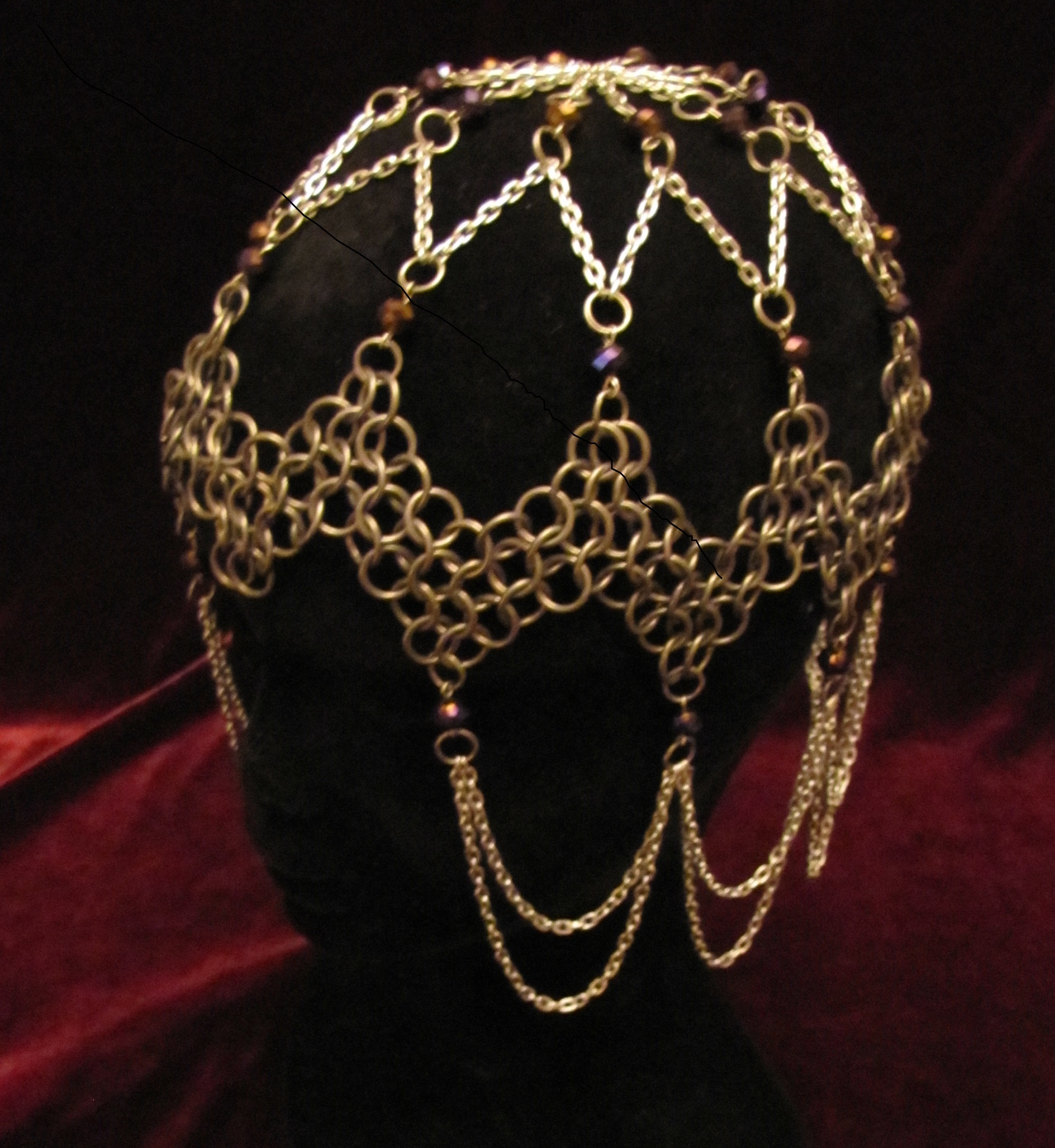

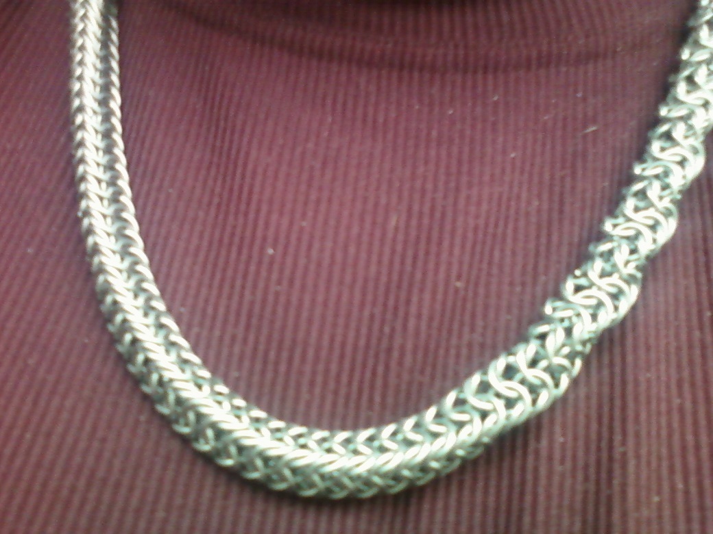

I’ve been making armor and jewelry from chainmail since the mid 1980s
I’d like to offer a class in basic and advanced chainmail assembly if there’s interest.
I’m always available for questions and advice.
