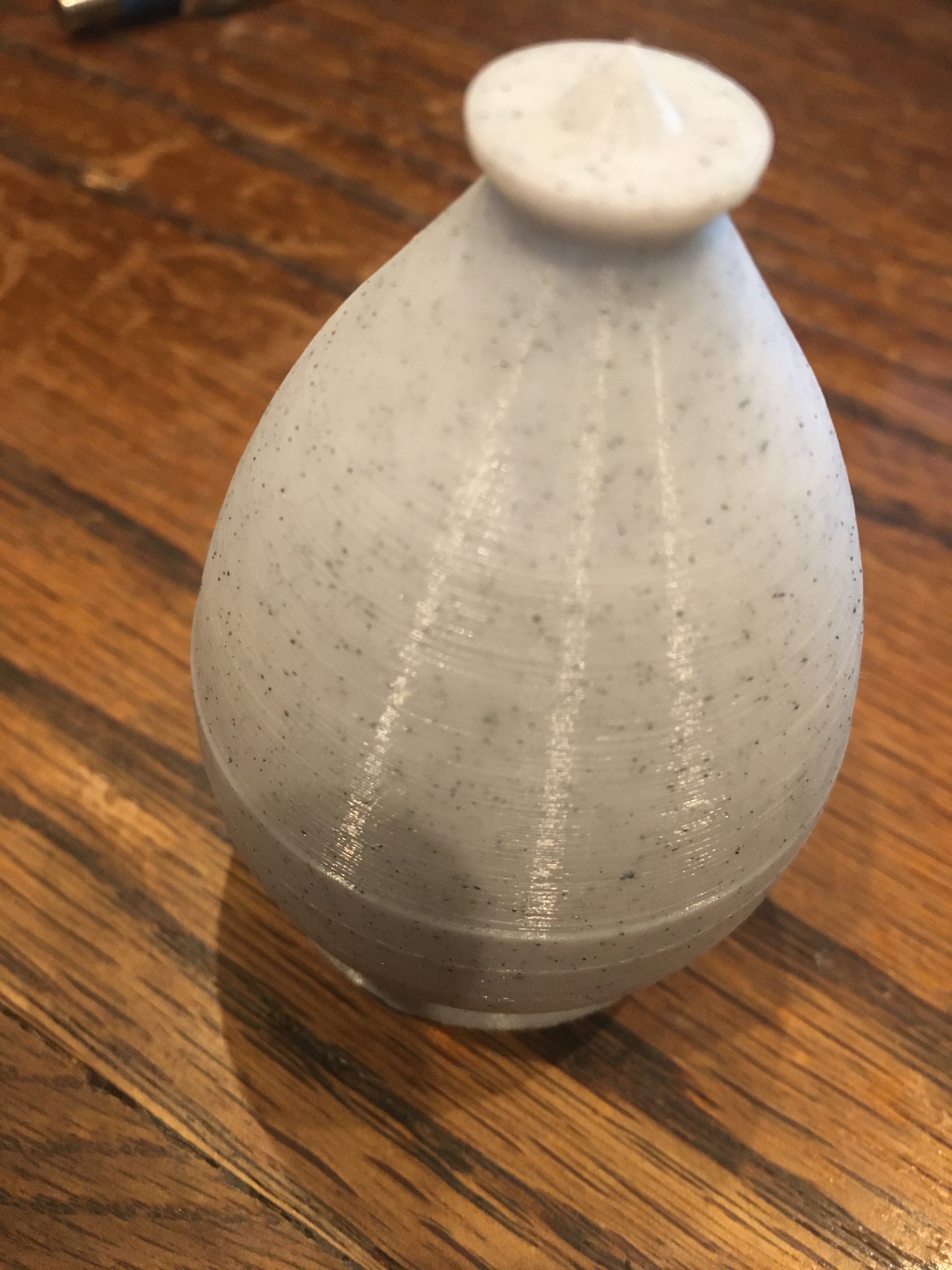

I’ve got an Ender 3 Pro and I just printed a kid’s throwing top from the marble filament from:
https://smile.amazon.com/gp/product/B07P8YTQB5/ref=ppx_yo_dt_b_asin_title_o06_s00?ie=UTF8&psc=1
It printed fine and I’m now printing another PLA print from a Violet Silk filament and it is printing fine.
I’m using the stock extruder end and I’m not having any problems. I have a number of spares, all brass, that I can use if I need to. I upgraded the Bowden tube to a Capricorn tube and it seems to help the quality of the print.

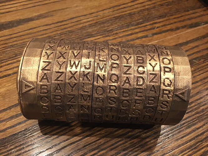

I think it just looks a little grey with flecks of black or dark grey in it. I’ve also printed wood filament on it. I would say just based upon how the filament feels that wood is probably harder on the extruder than the marble filament, but both worked fine on my printer. (Here’s the wood print)
And the marble top:
