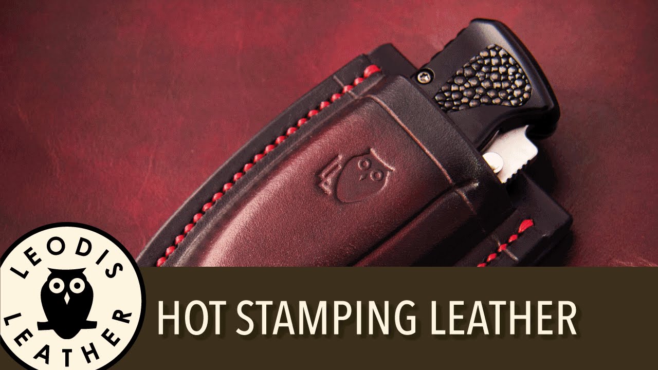

A lot of stamps/makers marks are heated and pressed into leather. This is done after the dyeing stage, and instead of wet stamping. Ian Atkinson points out this works on not just veg-tan, but many others, like English Bridle Leather and prob pull ups.
Not so hot to burn the leather, but still enough to leave a permanent impression.
Some folks use a propane torch/heat gun for their metal stamp (usually brass). Commercial machines avail too.
Ian has a great vid here about why and how:

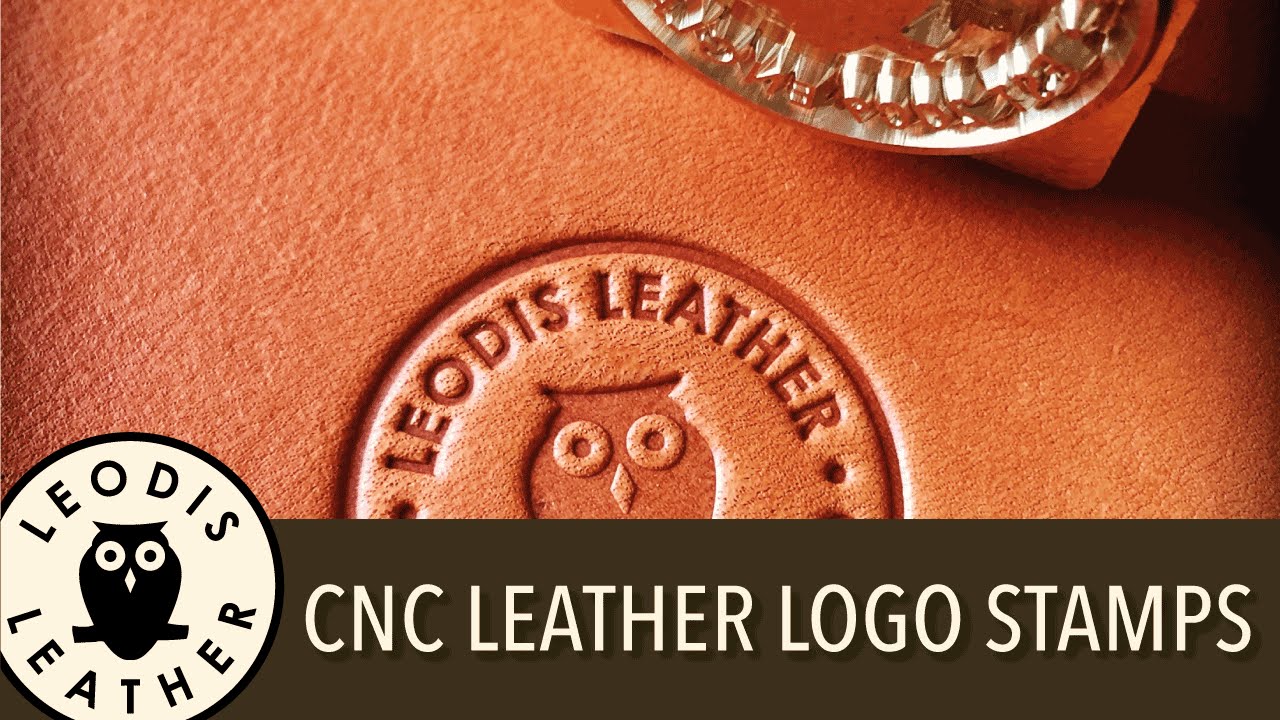

Note: Ian has a follow-up on making the stamps.
This is a good project for the Shapeoko if you choose brass.

I’d seen heated stamps used for chrome-tanned and oil-tanned leather (where casing wasn’t an option), but he makes a good case (no pun intended) for the occasional use with veg-tan as well.
