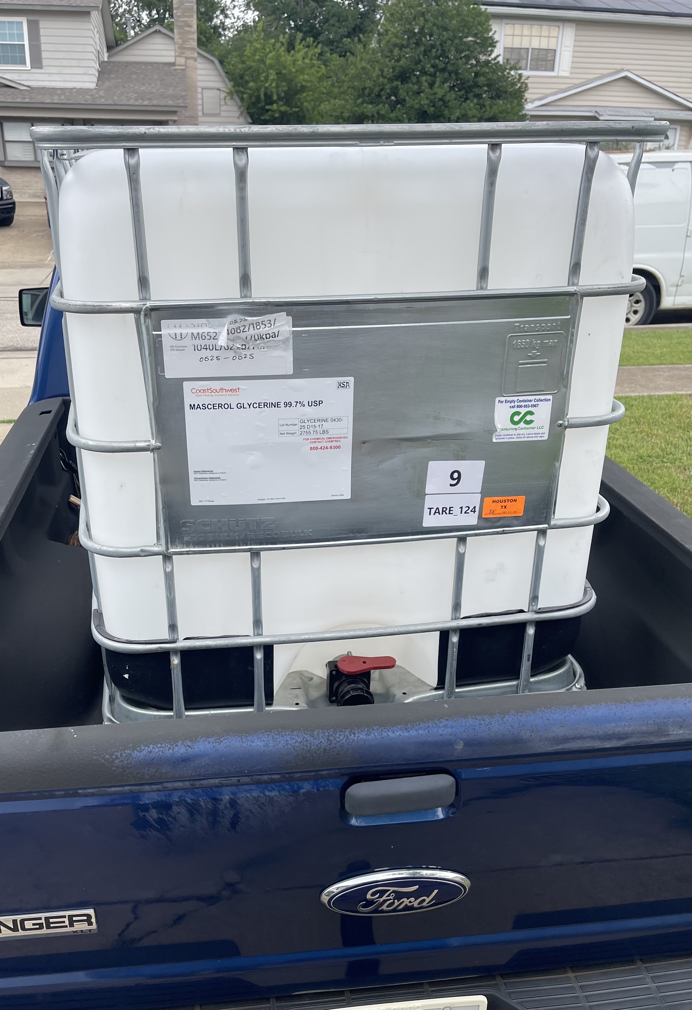

Cross cuts. I intend to build a platform for a 275-gallon IBC tote for a rainwater collection system.
