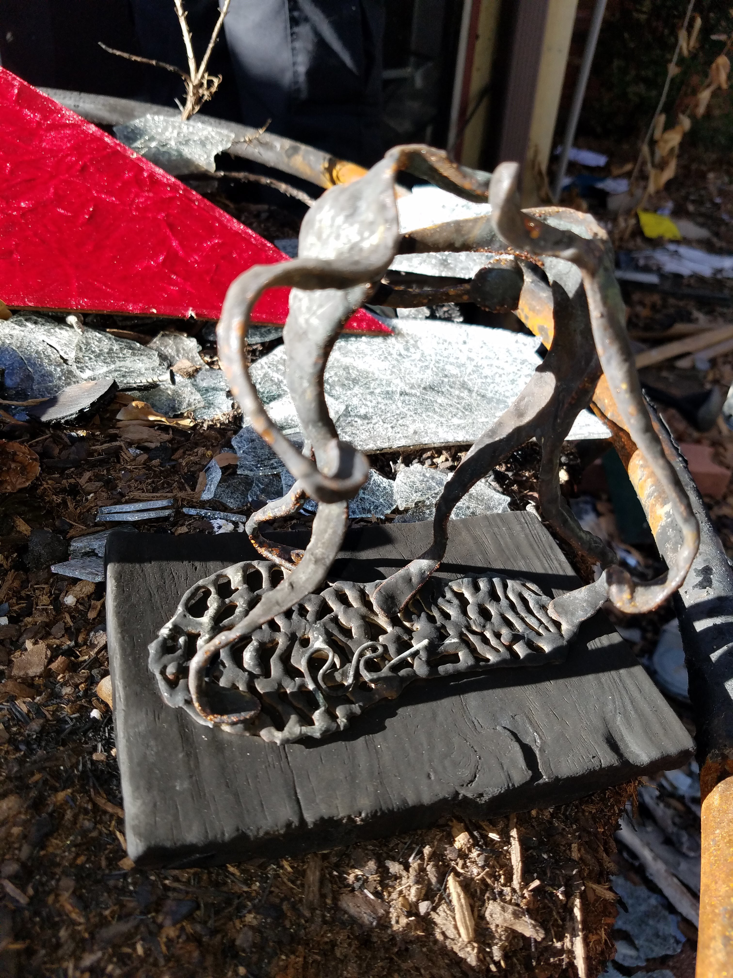

Good day everyone. We had a house fire on Dec 22 that destroyed most of our house and my family’s possessions. We are trying to salvage whatever we can, and I found a sculpture that I purchased in Fredricksberg. I was told the smoke was very caustic and will begin to erode metals immediately (which I believe to be true, as the sculpture already appears to be pitting.) I believe it is made of copper, possibly bronze.
Does anyone know how to clean it?

Warm clean water is the natural enemy of most things corrosive. Were I in your shoes I would use a toothbrush / rag to gently scrub a hidden area with warm fresh water. If that appears to work I’d rinse that thing really really well. Be sure to include rubber gloves and eye protection in the effort.
According to Wikipedia some rather nasty acids are the problem. If that’s true for you then mild bar soap will be beneficial.

In addition - I vaguely remember that one of the members had a (son?) who did a science project on how to clean copper. It seems that a paste of lemon juice and salt was particularly effective.
Neverdull and/or Brilliantize are excellent products for cleaning and polishing soft metals.

Either salt and lemon juice or salt and vinegar is used to remove tarnish from copper
Wash it well after or it will patina in blue or green
I would start with warm soapy water that then try the salt and acid in a small area also toothpaste is a
mild abrasive I have used it to polish stretches ou of amber
