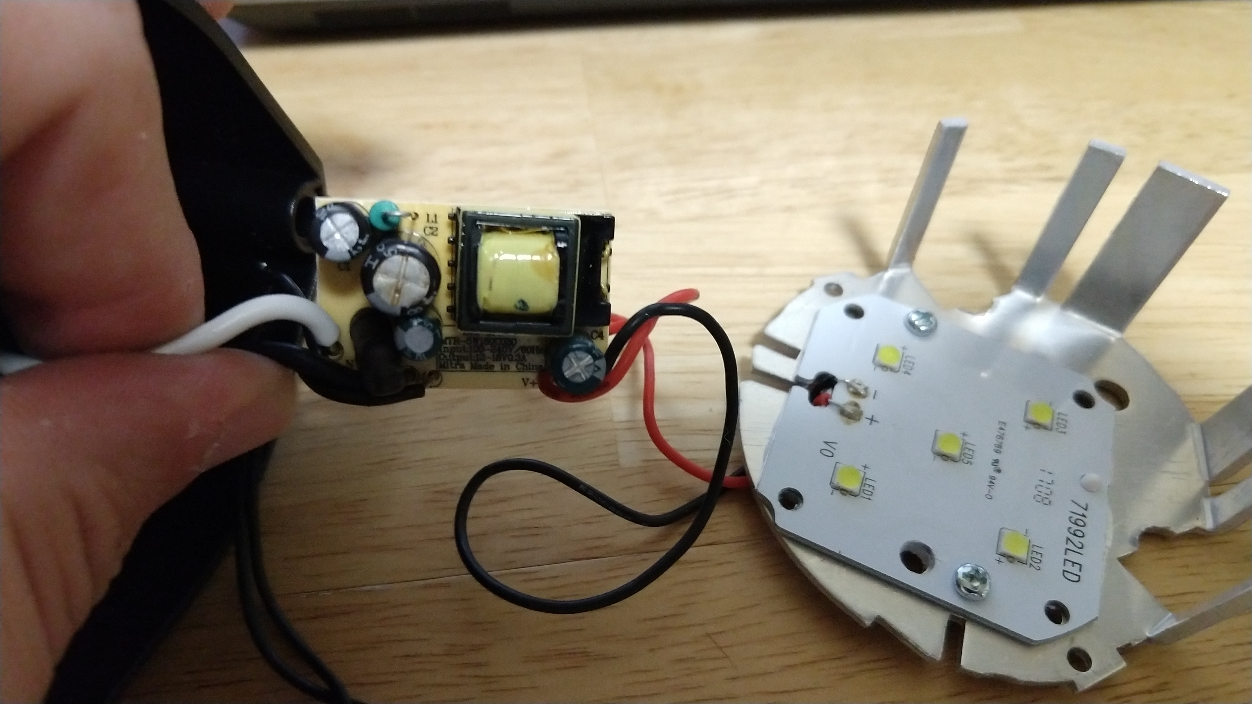

Looking at the LED PCB, the 5 LEDs are clearly in series. I’d expect the voltage across the +/- leads to be ~15V assuming modern 3V Vf LEDs. My crappy multimeter reports 2.5V.
didnt get the best photo of the thing
slightly better detail of the LED end

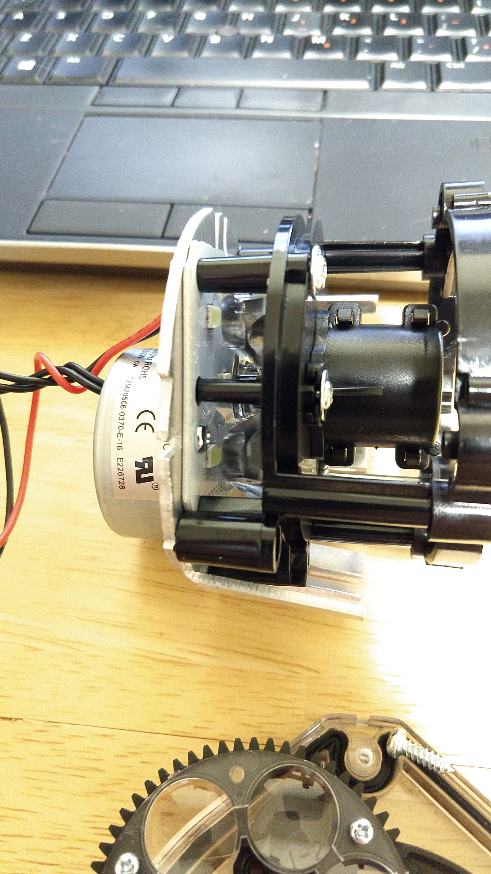

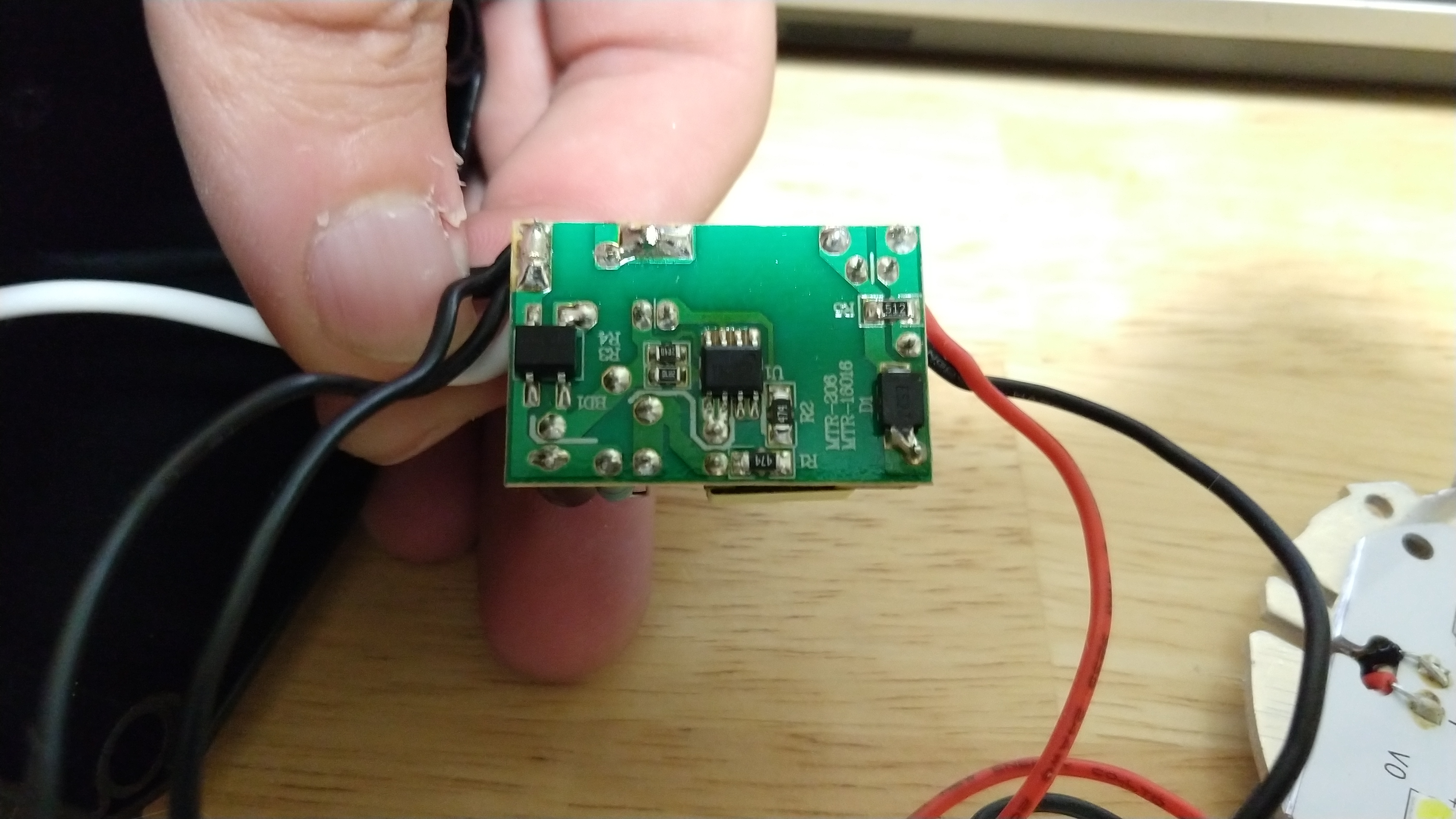

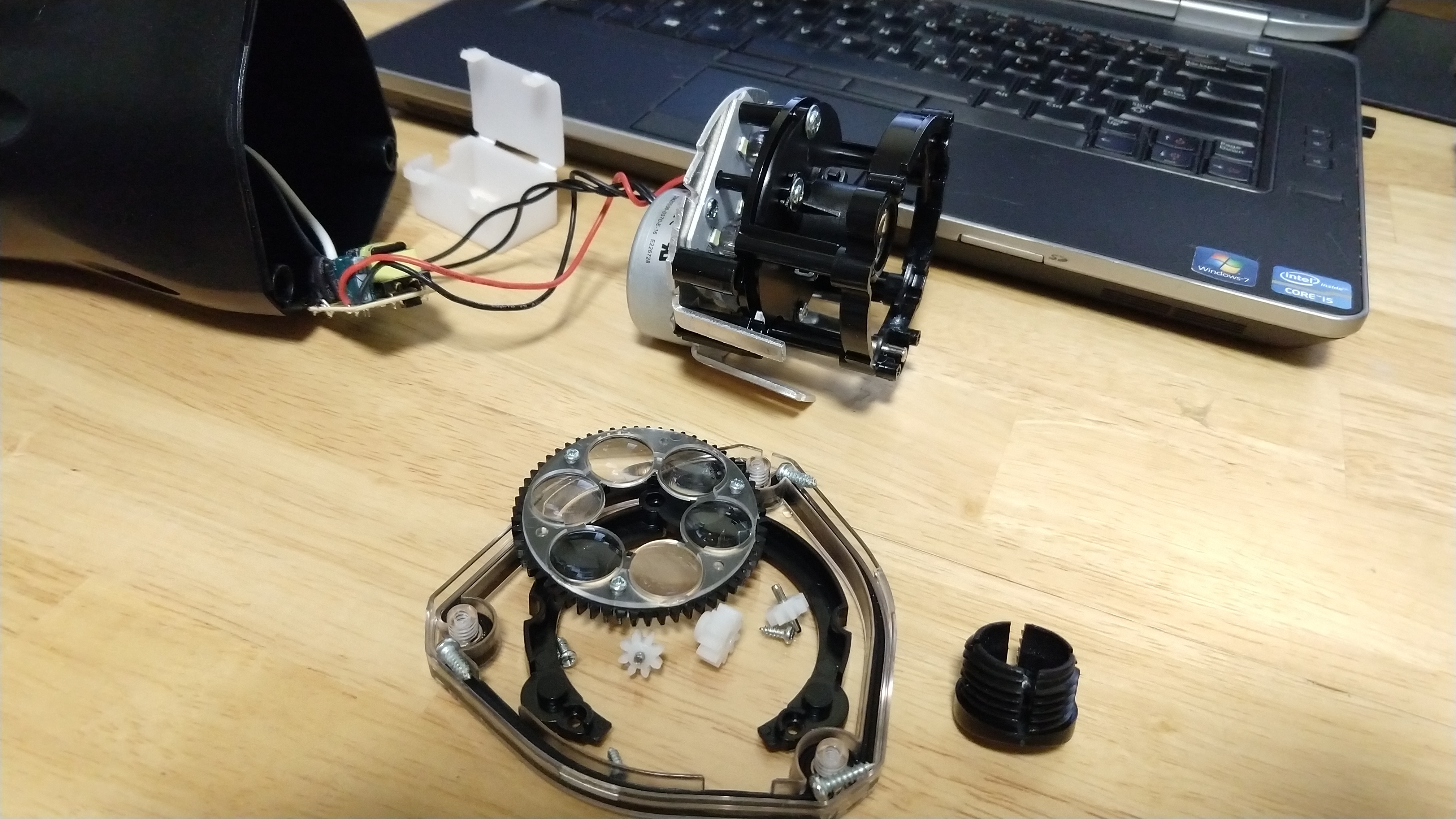

Better photos of the innards
My assumption last year was either that …
  • Moisture had bridged some contacts, shorting or otherwise impairing the ability of the AC/DC converter to function as intended
  • The added heat re-made a bad contact
The motor is 120V AC, so it doesn’t care about the AC/DC converter. I’d say the AC/DC converter is simply dead were it not for the low DC voltage across the output side.
Assuming that hot air fixed it previously, any ideas? Worth messing with for a sub-$20 purchase?
Gave up on it. Might salvage the LEDs/optics for some other project later.
Yeah. For roughly $20, it’d only be worthwhile to save if you have an excess of time to fiddle with it. Or a severe insufficiency of cash.
LED array plus optics could be of interest for future tinkering. Suspect that unburdened of the silhouette mask it produces a reasonable wash of light even a low currents. Tanner sells DC power supplies for cheap.
