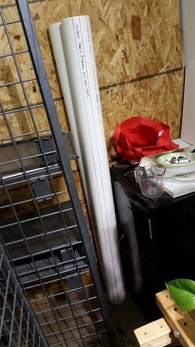

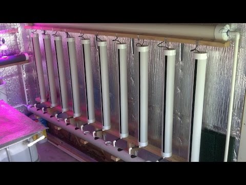

I have two x five foot sections of 4" schedule 40 PVC pipe in the corner of the Bio area that are going to be a component is a system like this:
They need to have a 1" slot ripped down the entire length. I have measured and marked the pipes and they can be seen here

I’d use the chop saw, myself, and have done so on my home 10" model without issue. However, be mindful that some claim that PVC is prone to “shattering”. I have not experienced this, but it is always a good idea to wear safety glasses (and, in this case, a face shield) when dealing with spinning metal blades.
— Zach
The problem is going to be holding the PVC in the proper orientation. Have you thought of how you’re going to do that?
Probably could made a jig to engage the slot of the outfeed to keep it straight.
Actually, the riving knife will probably suffice. I’m not used to having one.
Doh! I forgot to read your entire post (about “ripping the slot”). Ignore my suggestion of the chop saw.
Would this be something you could put on the Bridgeport mill between two end blocks? This assumes the ends are cut square (with aforementioned chop saw).
I think the cross slide might be long enough … Bryan can answer this. PVC is plastic, and I think we’re OK with that on the mill.
— Zach
It’s travel is only 30", I think. If the tubes are short enough it would work.
I have seen a jig made of 3 boards in a “C” shape to sandwich the PCV but I figured that I could raise the blade just about 1/2" then run the PCV along its length using a guide the way you would rip a 2x4. I figured I could maintain rotational orientation of the pipe by drawing a line along its side against the guide and keeping it in place visually.
The 2x4 represents some sort of adjustable guide I presume is available on the saw. Then rotate and make the second cut. Doesn’t have to be too precise.
