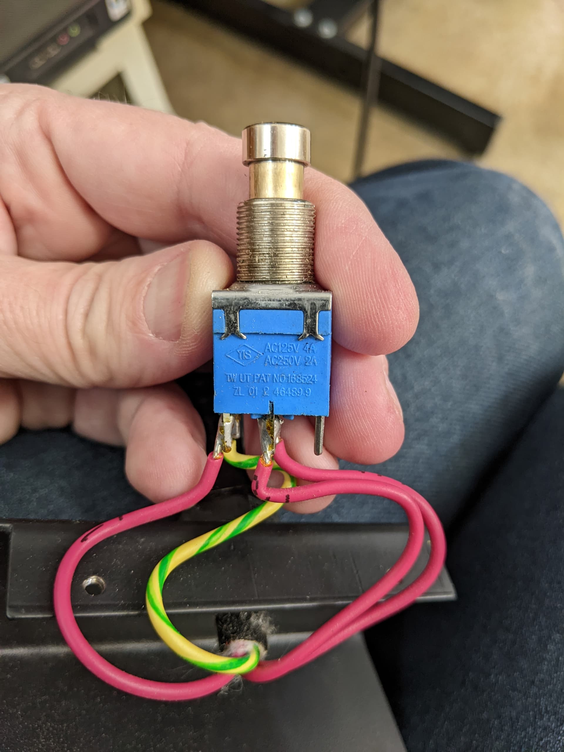

Help identify switch?
Foot switch for the CNC mat cutter at our work is getting flaky, want to replace it with new one. Nearest I can find are guitar foot stomp switches, but don’t know if they’re a proper match. Help?
Try Altex near NW side of Addison airport. I’ve seen similar switches there.
I think this is it from our friends at Mouser, $3.95
https://www.mouser.com/ProductDetail/SparkFun/COM-15133?qs=l7cgNqFNU1ixeguX%2Btox8w%3D%3D
Perhaps one of these has the proper dimensions and ratings: Foot Switches Pushbutton Switches – Mouser
May i suggest a linemastser foot switch as replacement.
Specifically the clipper line from linemaster. We used them on our jug debagger for production. Most survived 500000 activations
