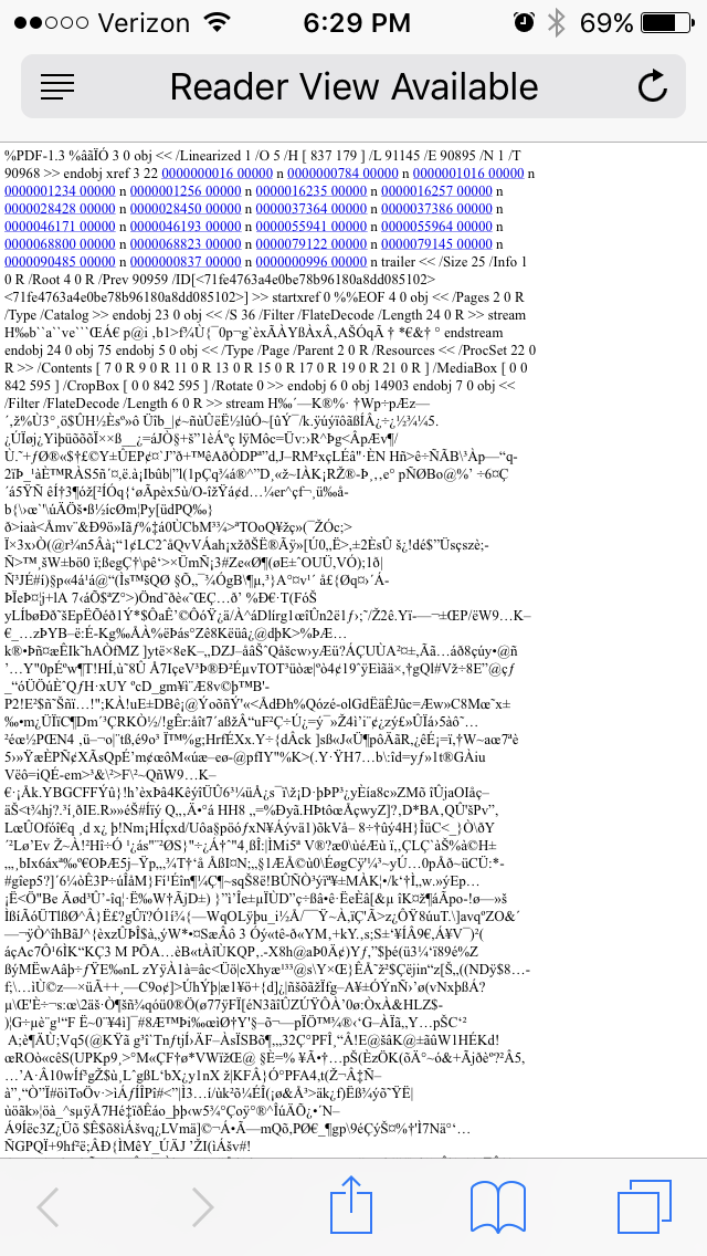

First link is jiberish to me.
If I knew more specs I might be able to help.
Save it and take the stupid .html off the end of the PDF file and Adobe Acrobat will open it.
Silly web site publishers…
