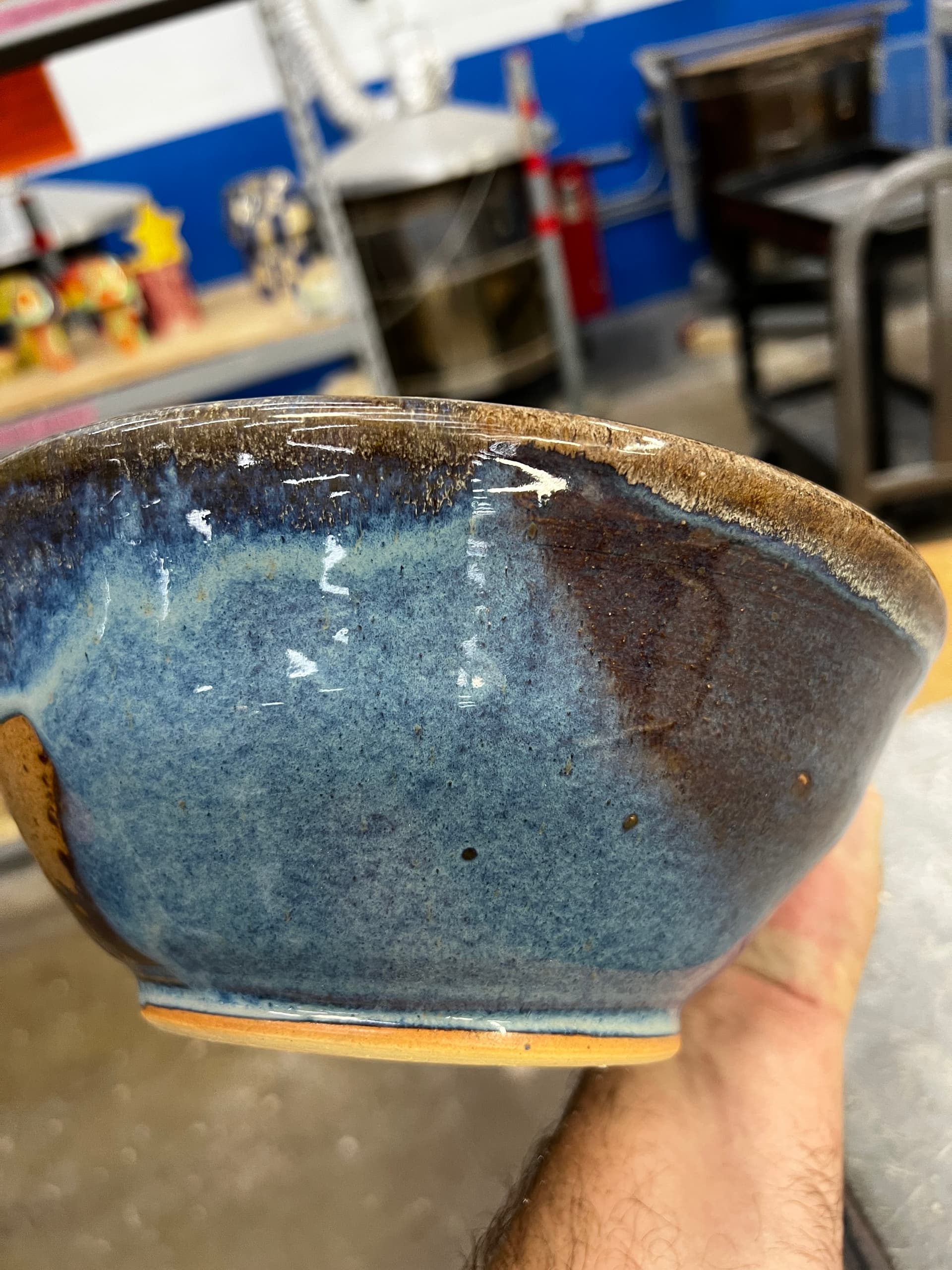

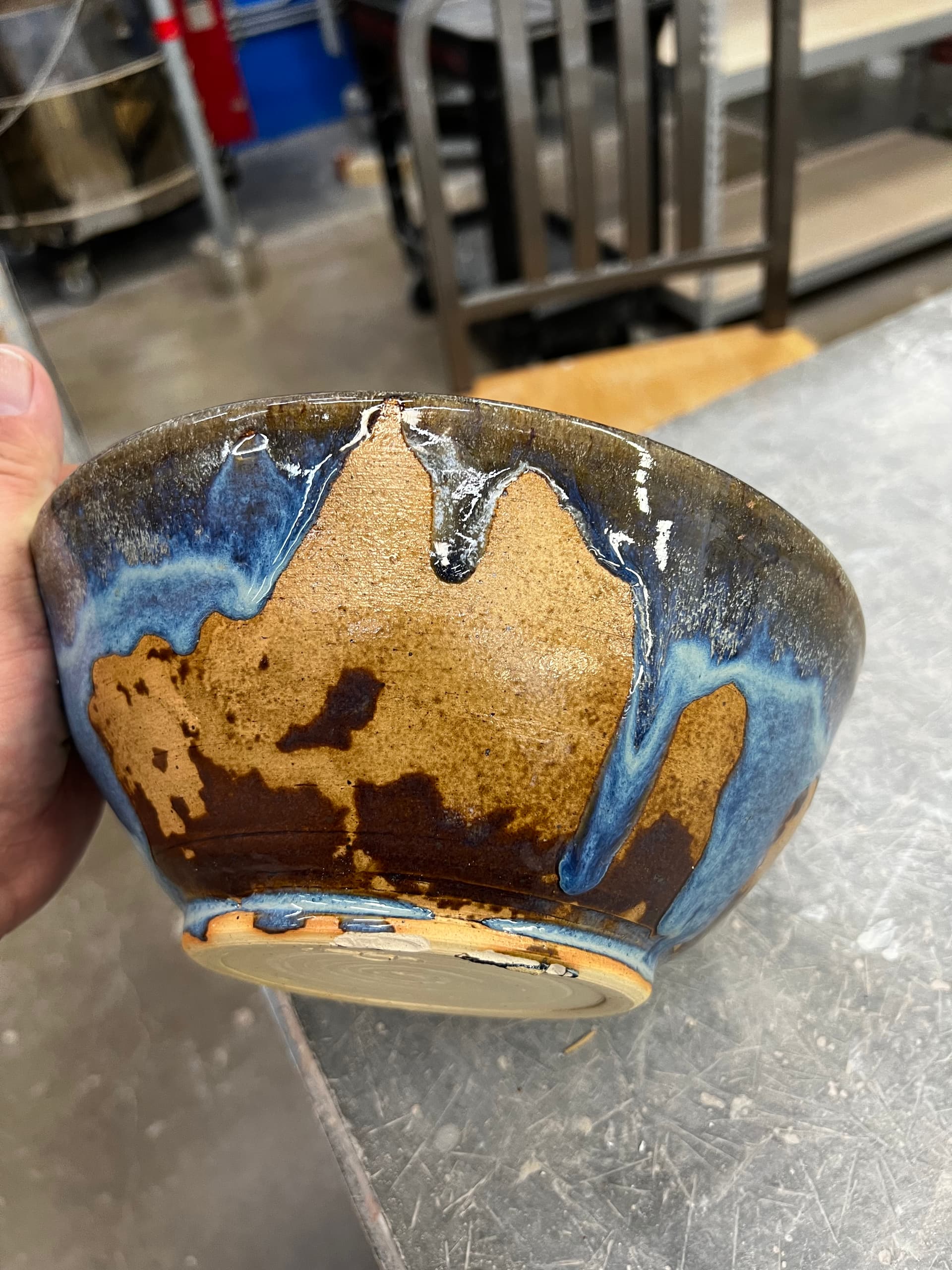

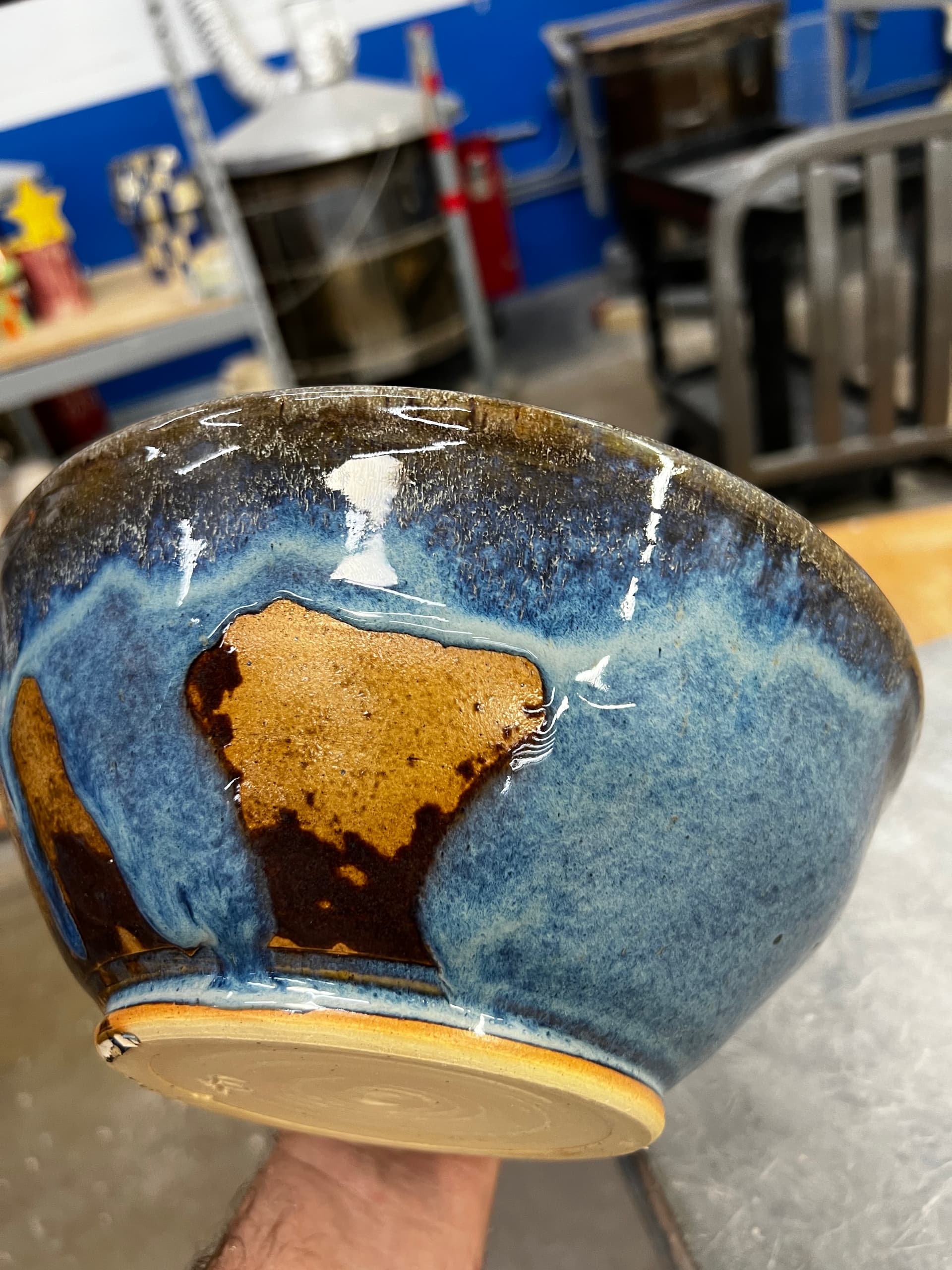

I glaze my bowls with blue rutile, dipping glaze pc-20. One of the two bowls that I glazed the glaze, ran off part of the bowl on part of the outside. See photos. Does anyone have any ideas on what this issue could be?
Thank you in advance for your advice and suggestions.
Scott

What type of clay?
Were there any oils on the surface?
Wax resist?
Three possibilies come to mind, if you sand outside (green ware or bisque) and don’t wash off the piece after bisque the glaze can stick to the “dust” and spit off or pull away. Another possibility is that somehow wax got on it, maybe a contaminated brush or rag. Lastly, the glaze wasn’t mixed enough before application since it settles out over time.
May not be any of those though, I like the look of blue rutile but I have horrible luck with it so I don’t use it much.
A few more just came out of the kiln. I hope you can save them.
They were either brown stoneware or white. On the bowls I dipped the bottoms in beeswax. On the mug I glazed the bottoms. There may have been a little oil from my hands on a couple of the pieces, but it would not be oil or all of the items. The only thing that I have changed up is moving to a dipping glaze.
I didn’t do sanding to those pieces. I don’t think that will be the issue. I think I have a bad batch of glaze.
