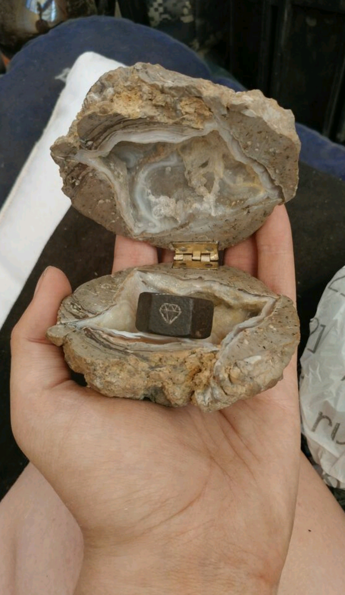

I did exactly this. I’ll post pictures when I get home. It’s not easy. You’ll need a good hard endmill and some way to clamp it in a vice
Turns out she had one on her phone. I guess she liked it.
That is amaaaazing. Next question. Did you use space tools or your tools?
I used the Bridgeport to make a notch for the hinge and then epoxied the hinge in. Screws would destroy the stone. The guy at the shop pre polished the cut edges so I didn’t have to do that part
