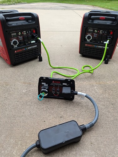

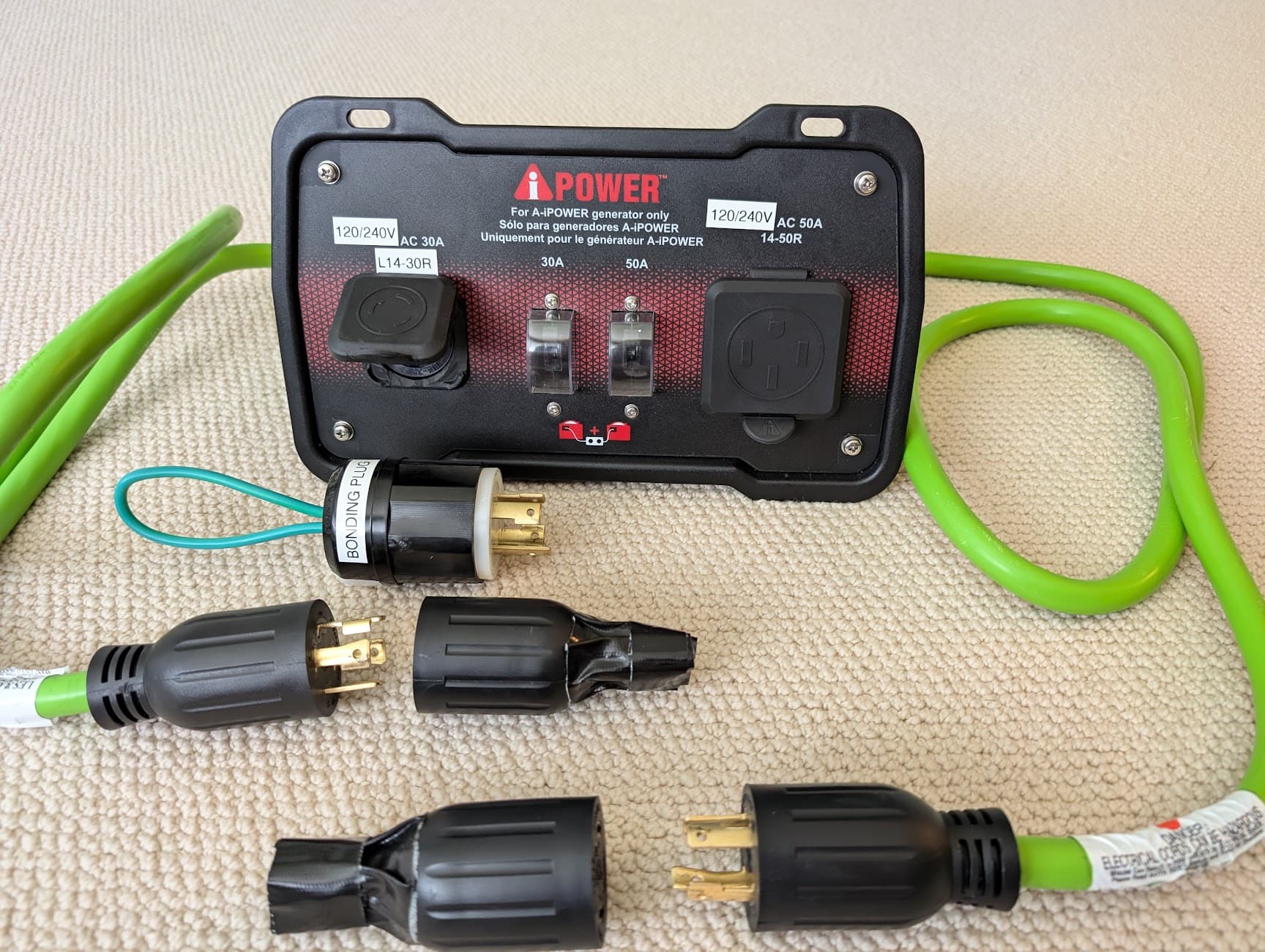

Still a bit of a hack job, but this is what I did:
  • I replaced the L6-30R in the box with a L14-30R
  • I bought two short L14-30 extension cords and cut off the receptacle ends to replace the existing 3 wire cables with 4 wire cables. The plug ends go into each generator’s L14-30R where the neutral is available instead of the parallel ports.
  • I wired X, Y, W and G inside the box with new cables. This is basically identical to the way the kit was originally wired plus the neutral from the new cords so W is connected between both generators and both the 14-50R and new L14-30R receptacles.
  • I capped the wires on the receptacle end of the extension cords I cut, and use them as protective covers for the L14-30P ends when not connected to the generators.

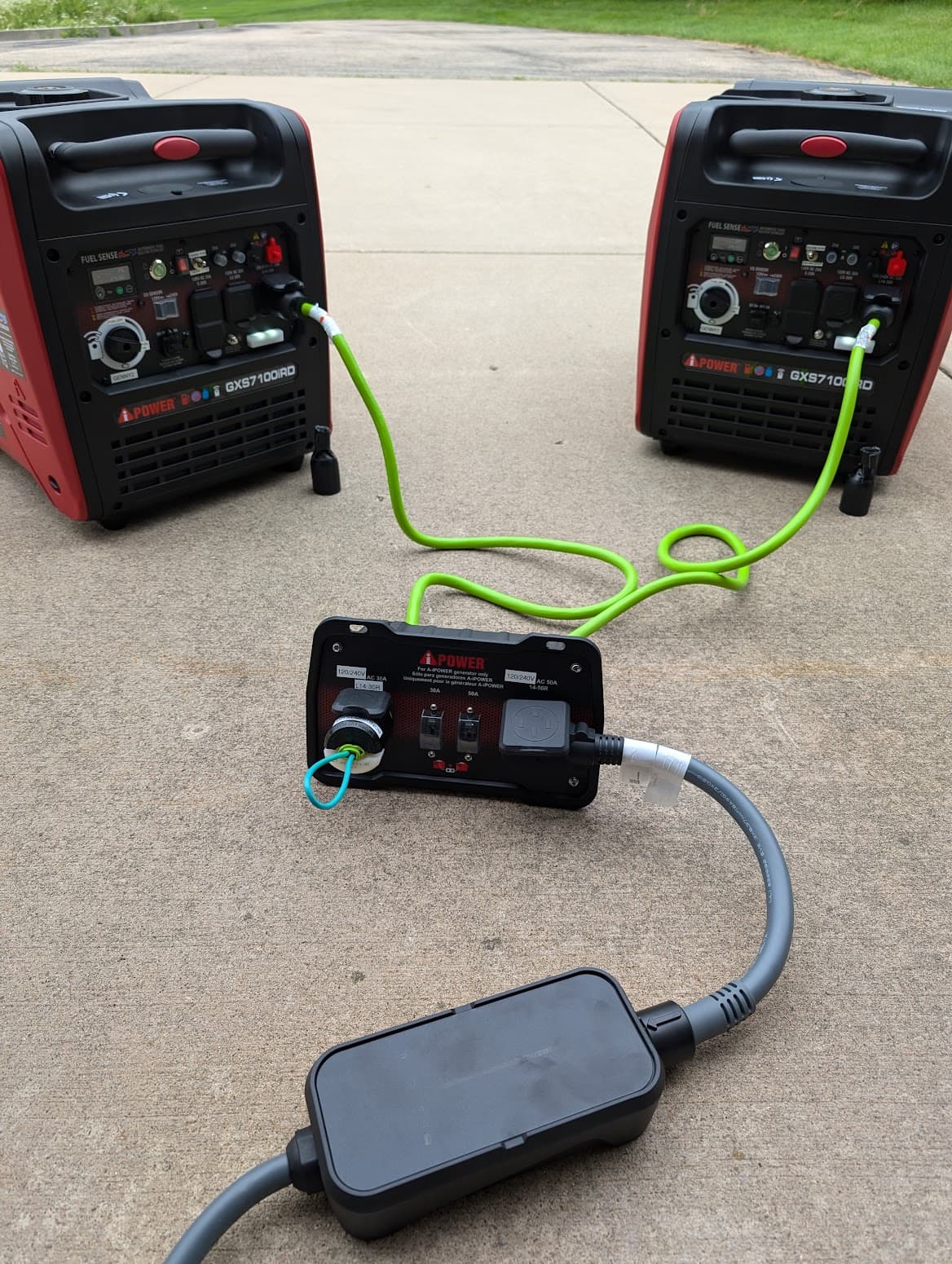

The main reason I swapped in the L14-30R is so that I had a place to add a neutral-ground bond. While my main use is to connect to my house, I have a EV charger that is a great way to exercise and test the parallel setup since it can pull 40 amps. When charging the car like this, I need a neutral-ground bond or the charger shows a wiring fault (as expected). So my exercise setup is this parallel kit with the EV charger on the 14-50R, and a bonding plug (jumper between W and G) on the L14-30R. Works great. When connected to the house, I leave the neutral floating and rely on the bond in the panel.
Here are the issues with this setup that I am willing to accept:
  • The 50a and 30a breakers in the parallel box are only wired to one hot leg each. That was fine when this was a 240v only kit since killing either leg breaks the 240V circuit. But now that I made it 120/240v capable, a tripped breaker is only going to cut power to one leg. Any 120V loads on the other leg would still be live. I am OK with this because my main use case is into a house inlet with interlock, and the house connection is already on a 50amp double pole breaker in my panel. The breakers in the box are redundant in my setup.
  • Using the L14-30P extensions cords to replace the parallel cables makes the altered kit effectively a 30a suicide cable with a couple extra receptacles in it. The reason they make separate parallel ports on generators to avoid the possibility of someone doing something dumb. I understand why I did what I did, and know to only use this kit for my intended purpose.
So with a simple 50a generator inlet and interlock, the kit works great for 120/240V and remains neutral floating - the bond is in my house panel.
Double throw would be fine too. Just remember if your transfer is switching neutral (3 pole), then you would need to bond neutral to ground on the kit side like I do when EV charging with the L14-30R.
Parallel kit in use exercising with EV.
I was thinking something like that, just completely DIY using a big watertight J-box with switches for each generator cord to disable suicide cord functionality should I wish to pull a generator for refueling.
