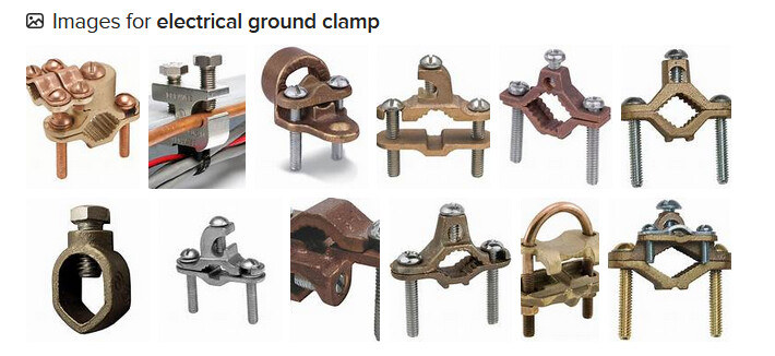

Does your house have metal pipes? If so, you could use a ground clamp as an expedient clamp point. You could clamp onto a facet bib. Attach one permanently then just attach generator ground wire to it quickly.

Gas pipe will work. I wouldn’t be worried at all and have seen electricians use them often. I wouldn’t do it close to a connection just in case a leak might happen. But gas inside pipe, even if a spark went through it won’t ignite, it needs oxygen, besides electricity will conduct along metal outside and not gap across inside.
