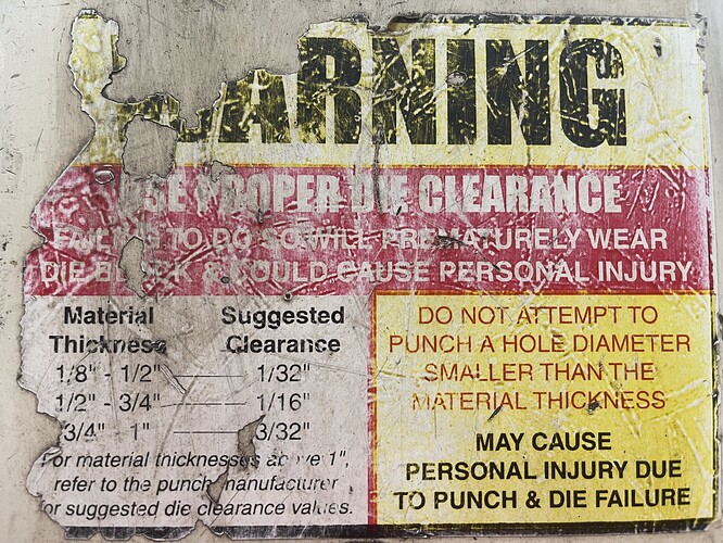

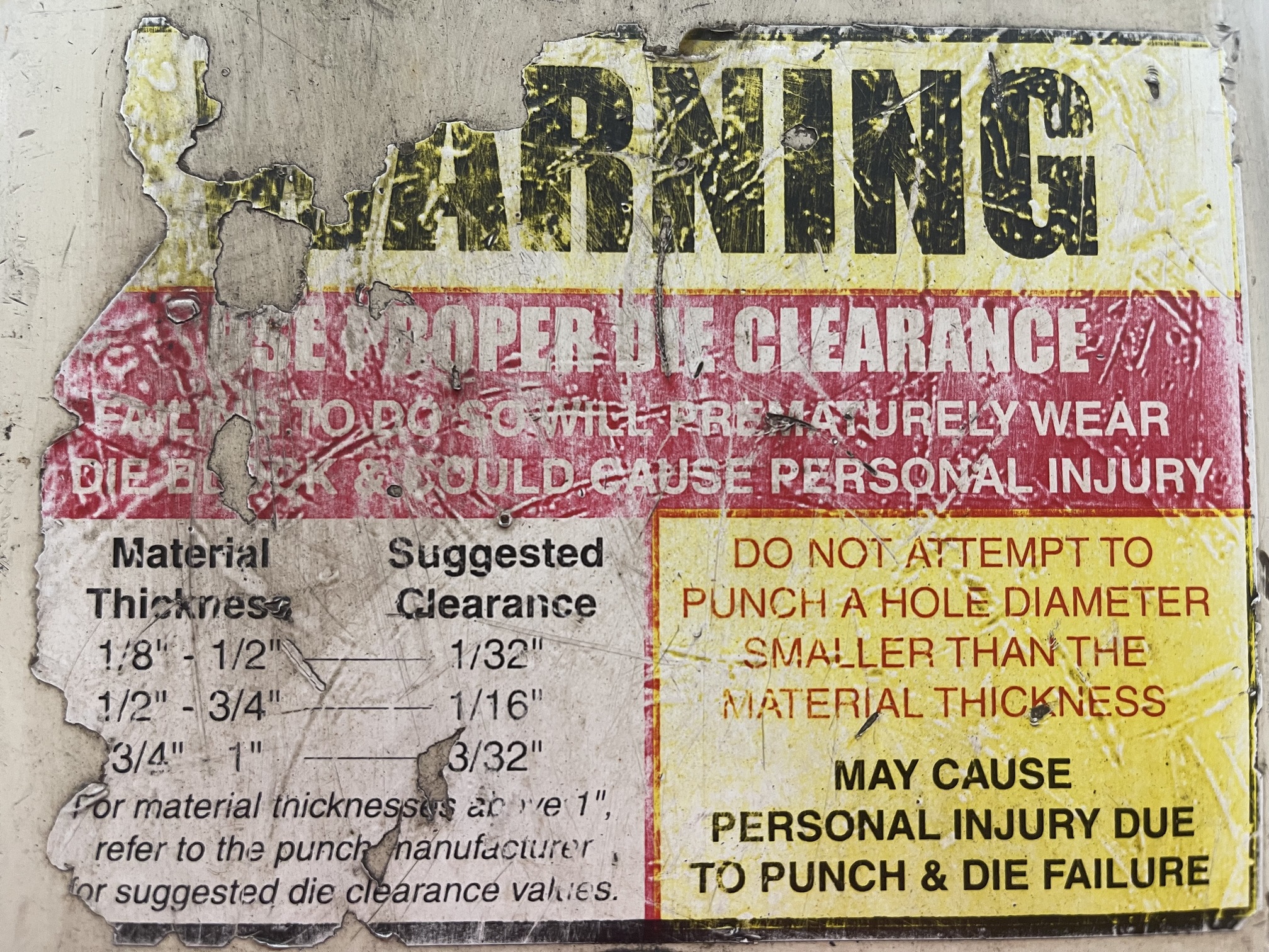

Aaaand it’s even a bit more complicated. This is the label on the Geka proper:
It says: for material thickness 1/8” to 1/2” use clearance 1/32 (so 1/16 total) for 1/2” to 3/4”use clearance 1/16” (1/8” total) for 3/4” to 1” use 3/32” (3/16” total.)
Since we limit the machine to 5/8” material, 1/16” is probably all we need.

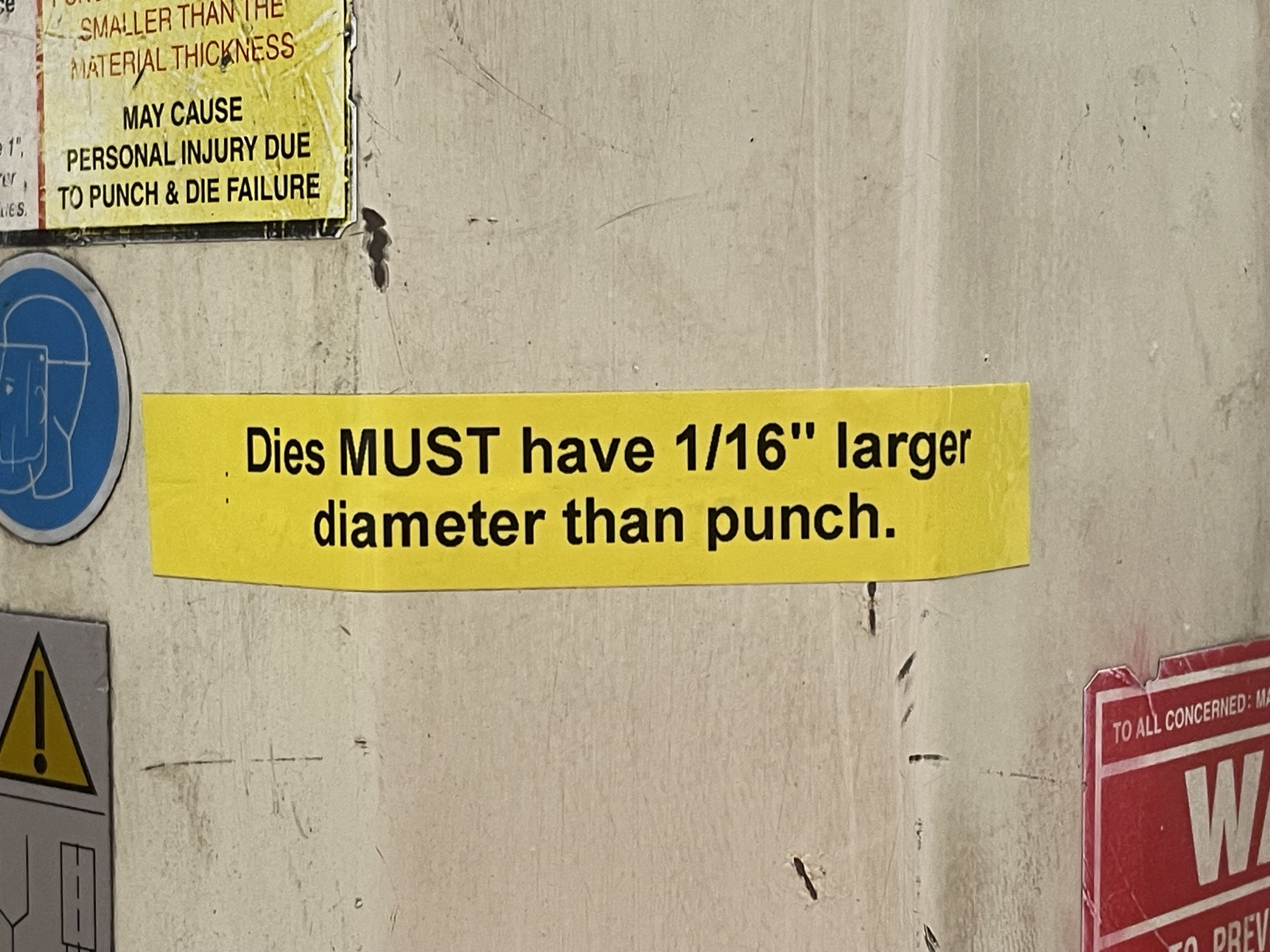

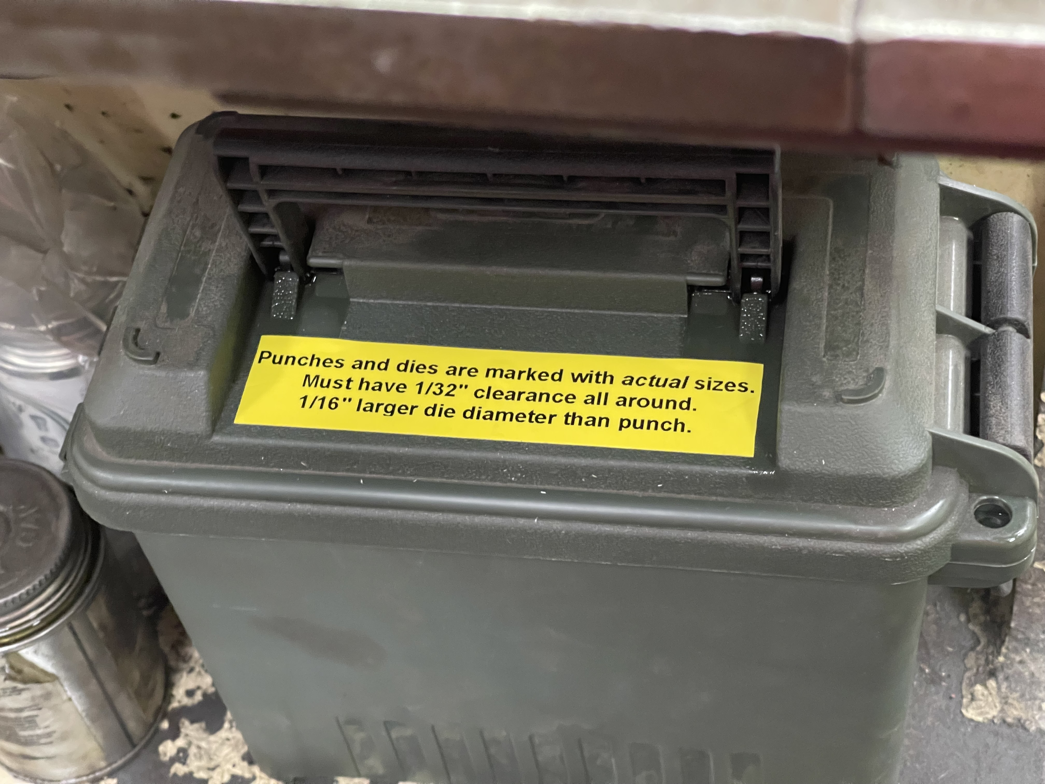

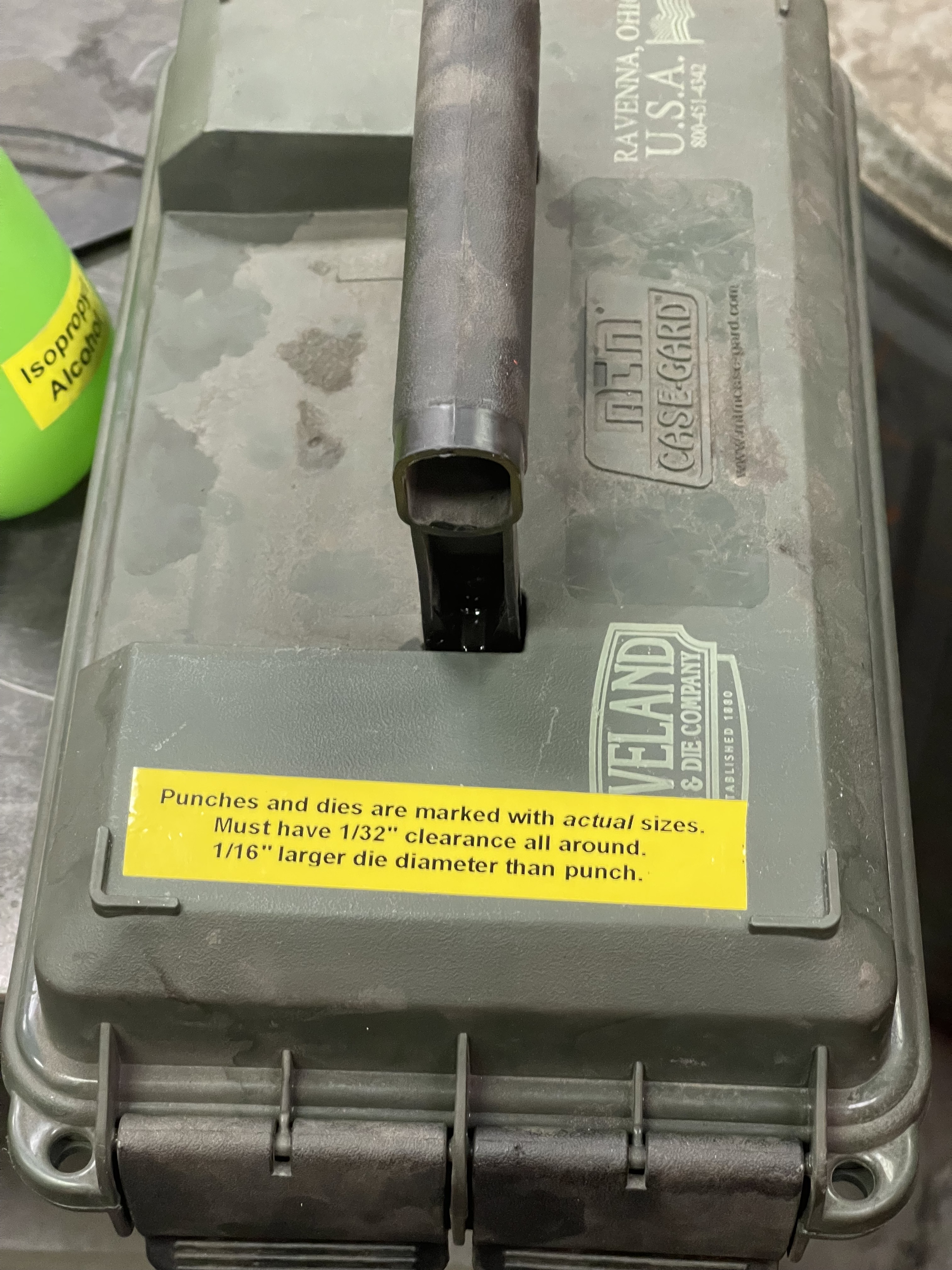

I’ve added these labels to the punch boxes.
And on the Geka:
