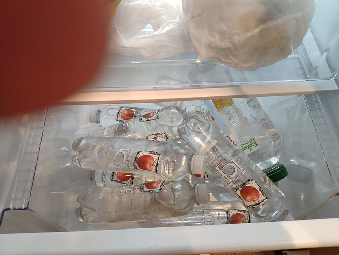

I try to keep some “ballast” in the thing (water bottles full of water) as I don’t have need to keep it super filled:
But for the most part it is mostly (?) occupied most of the time:
