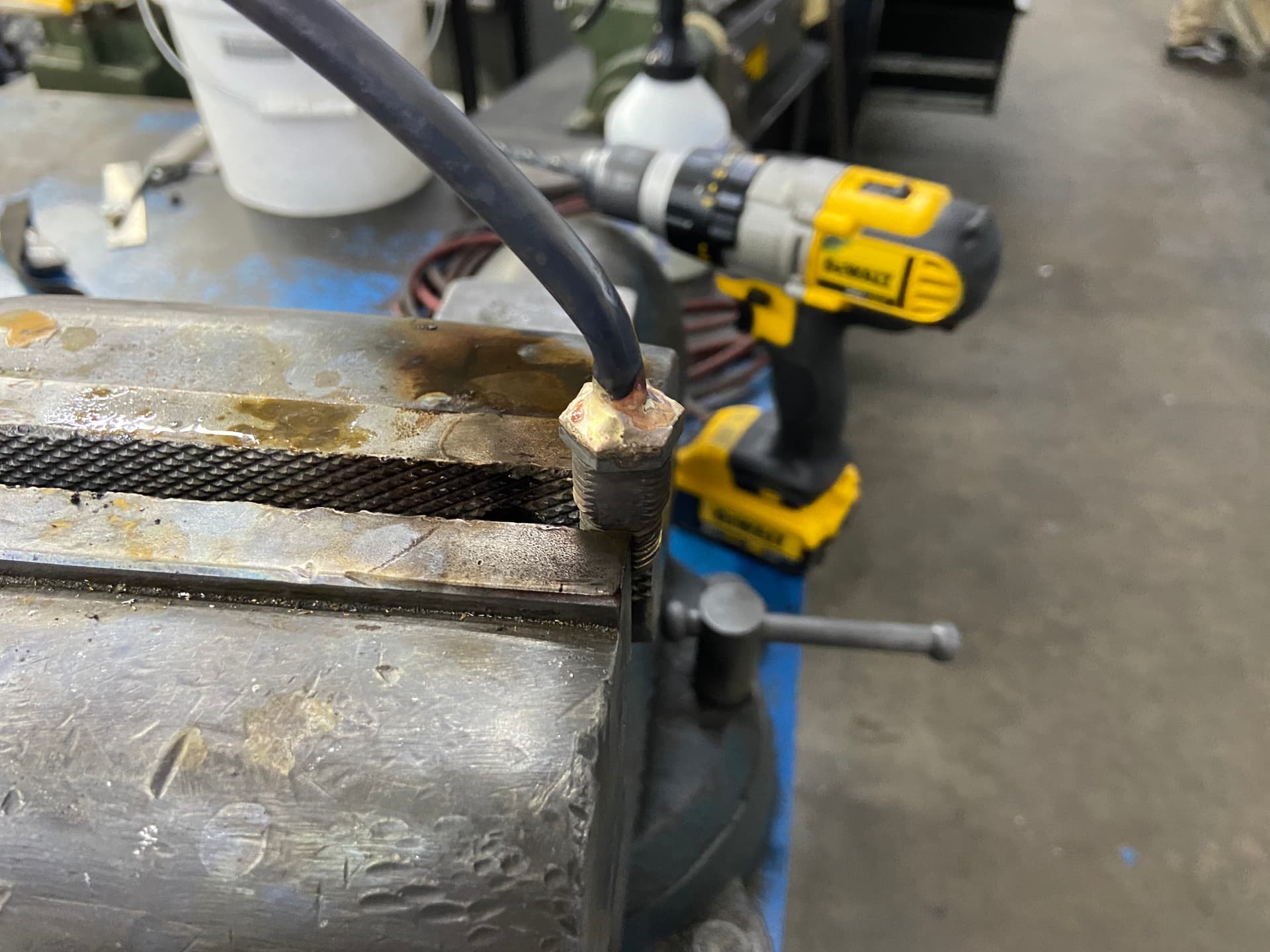

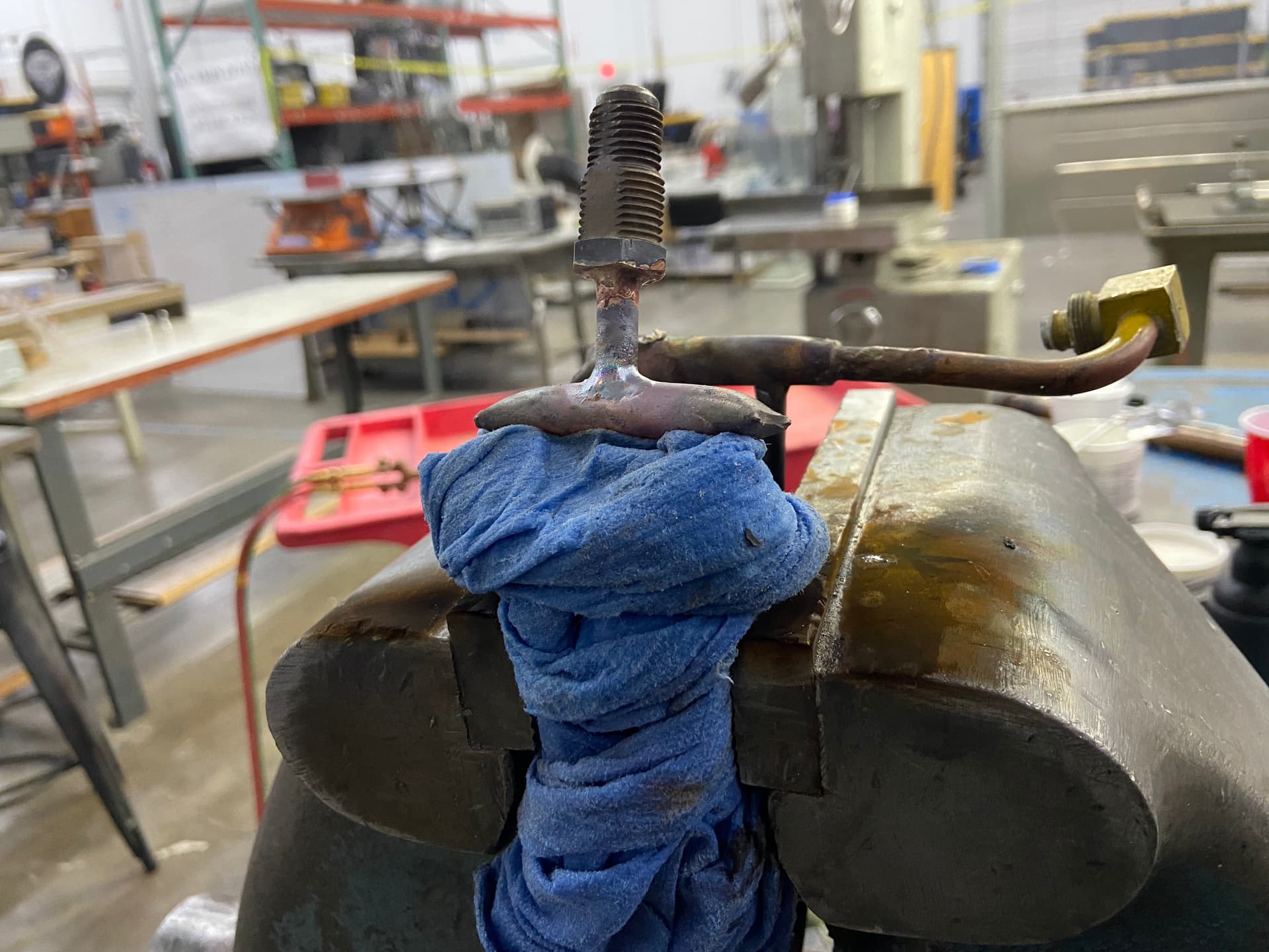

This is what the induction forge coil looked like when Joe pulled it out.

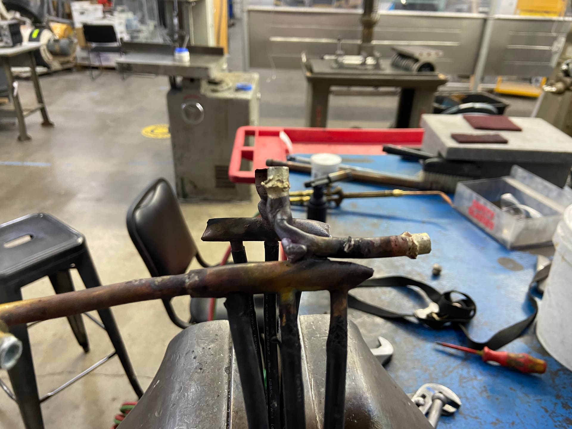

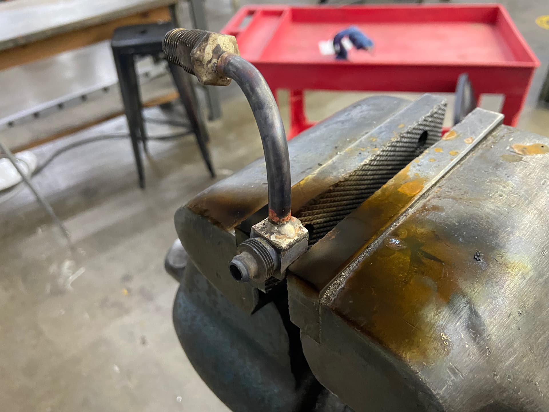

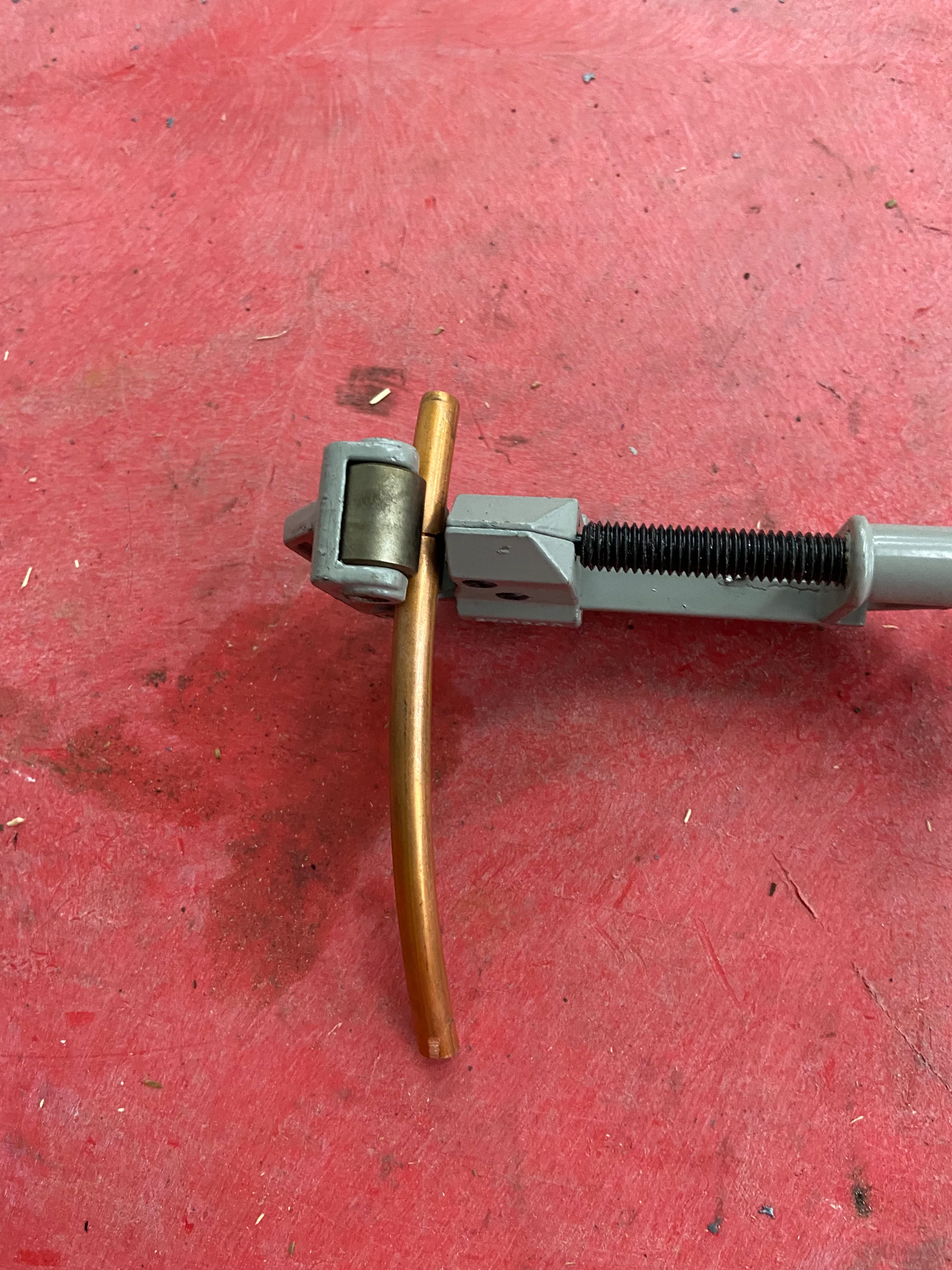

Here are pictures of the repair process

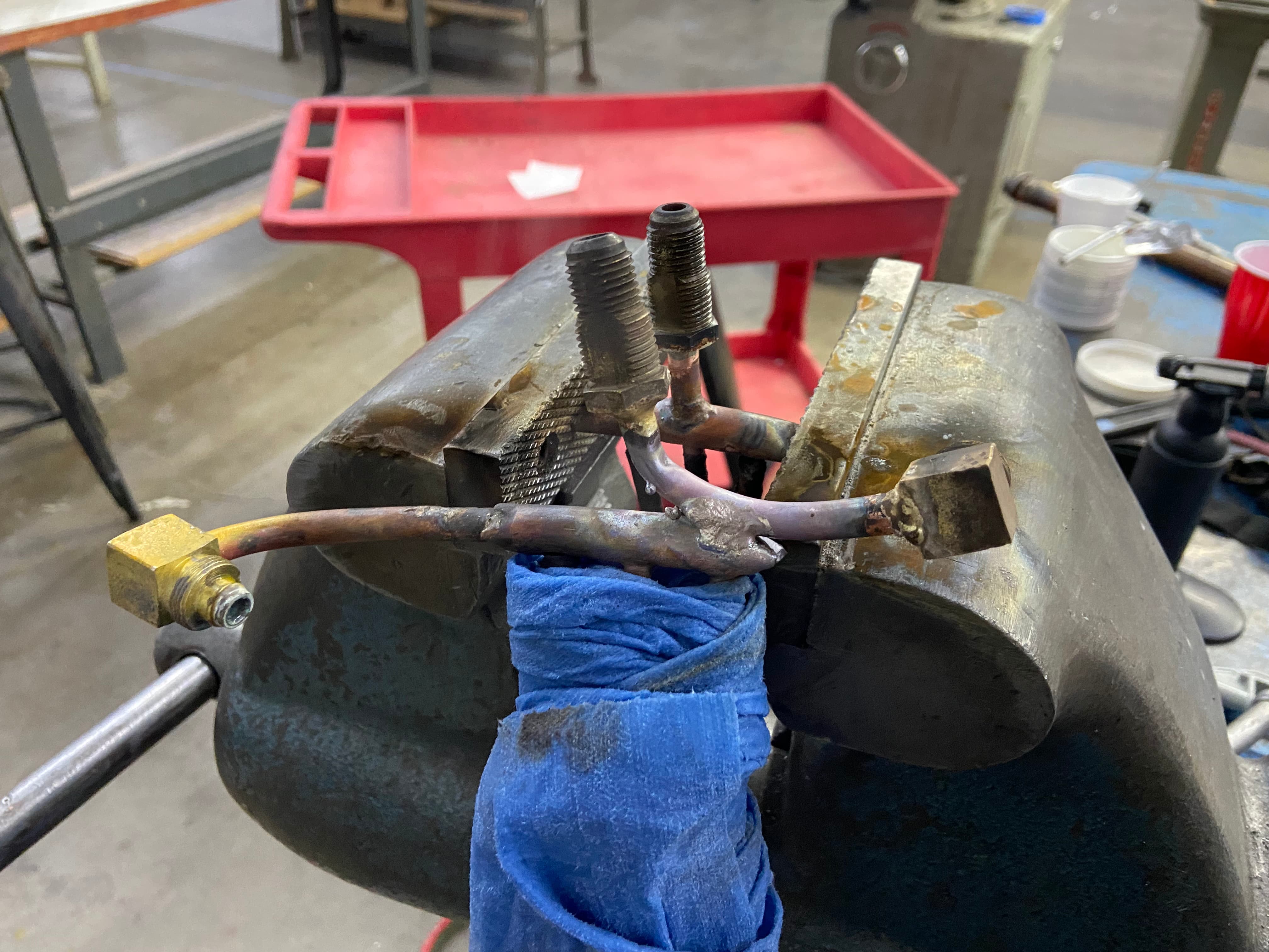

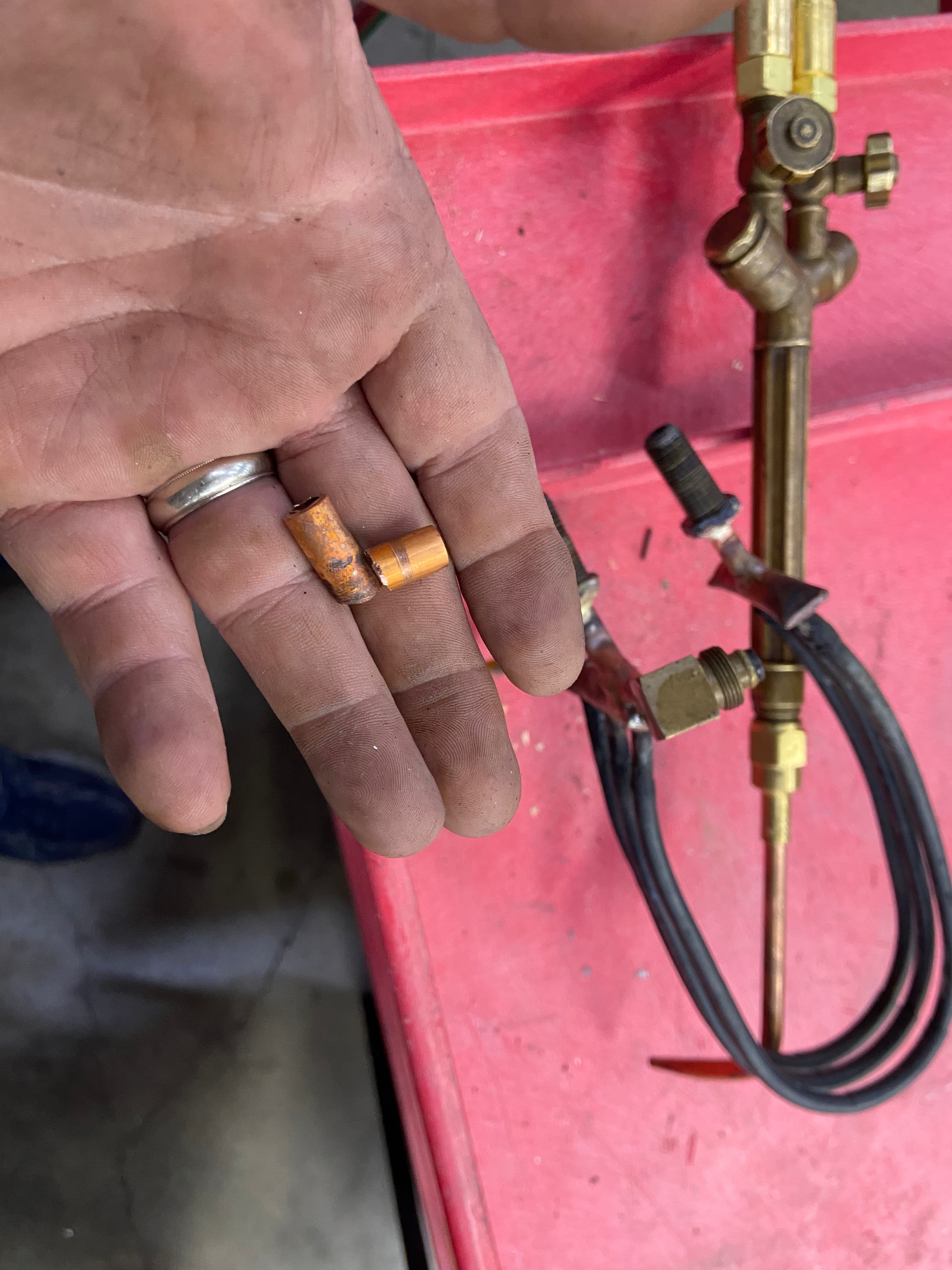

The wet paper towels were to keep the damn heat shrink from smoking & catching fire
The braze here had to be quick in & out, otherwise the braze would have looked a little better.

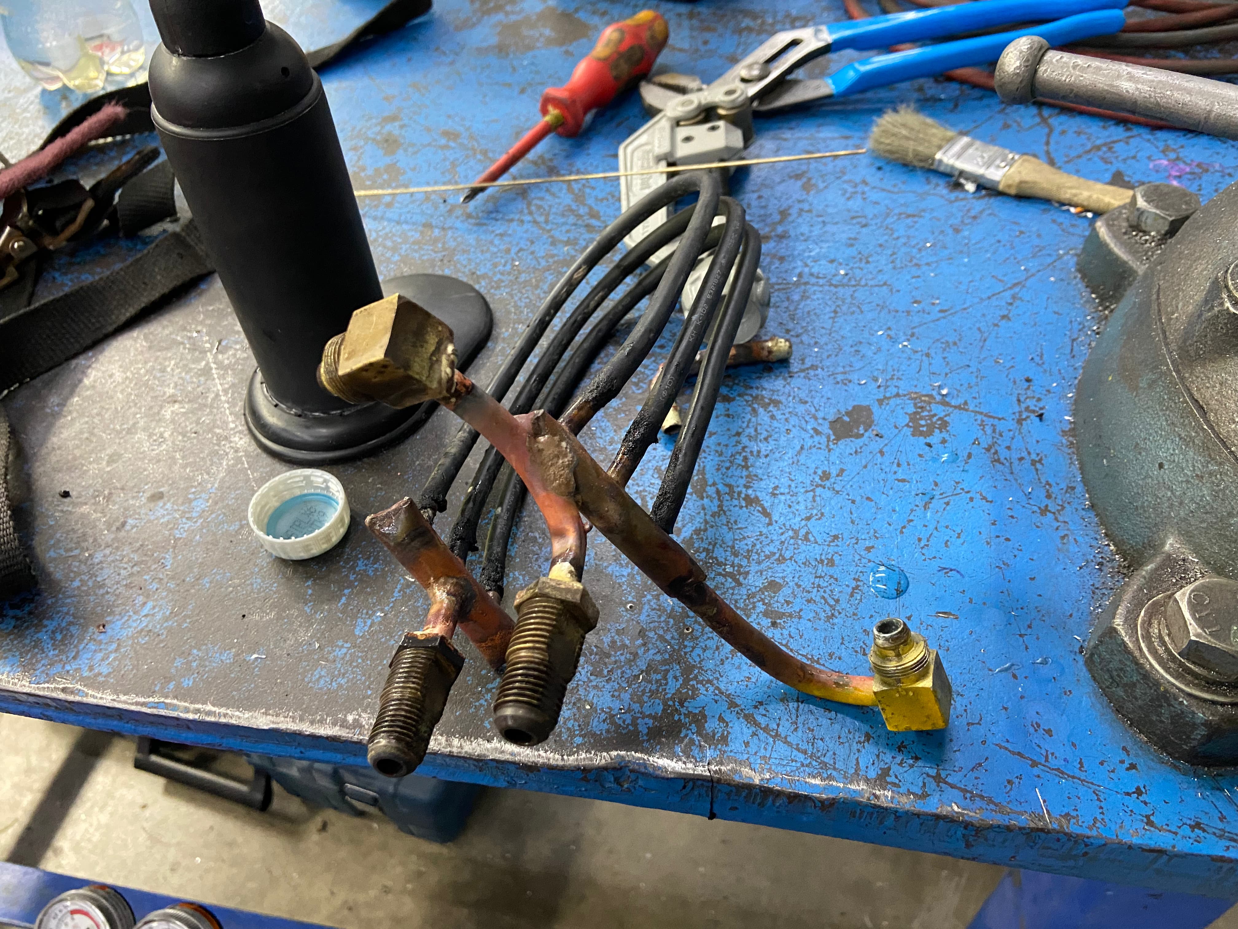

This is what I had to work with.
& this was all that was left, with no mistakes.
Induction forge is running again thanks to Tim
