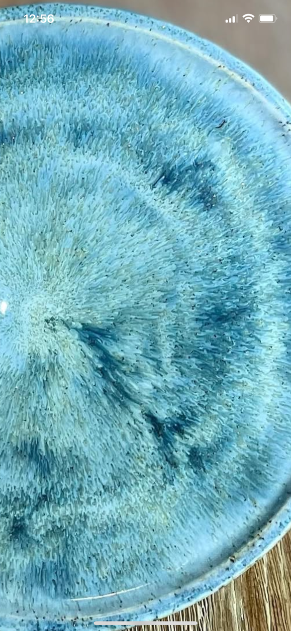

A few faves zoomed in:
Both of these are Cosmic Oil Spot over Arctic Blue, different # of coats of one vs the other gives bright vs dark.

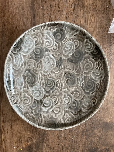

Snow over Storm.

That snow over storm is awesome. I just glazed a piece that’s snow over C 29 Deep Sea (not at the space) with hopes to have similar results :crossed_fingers:t2:
