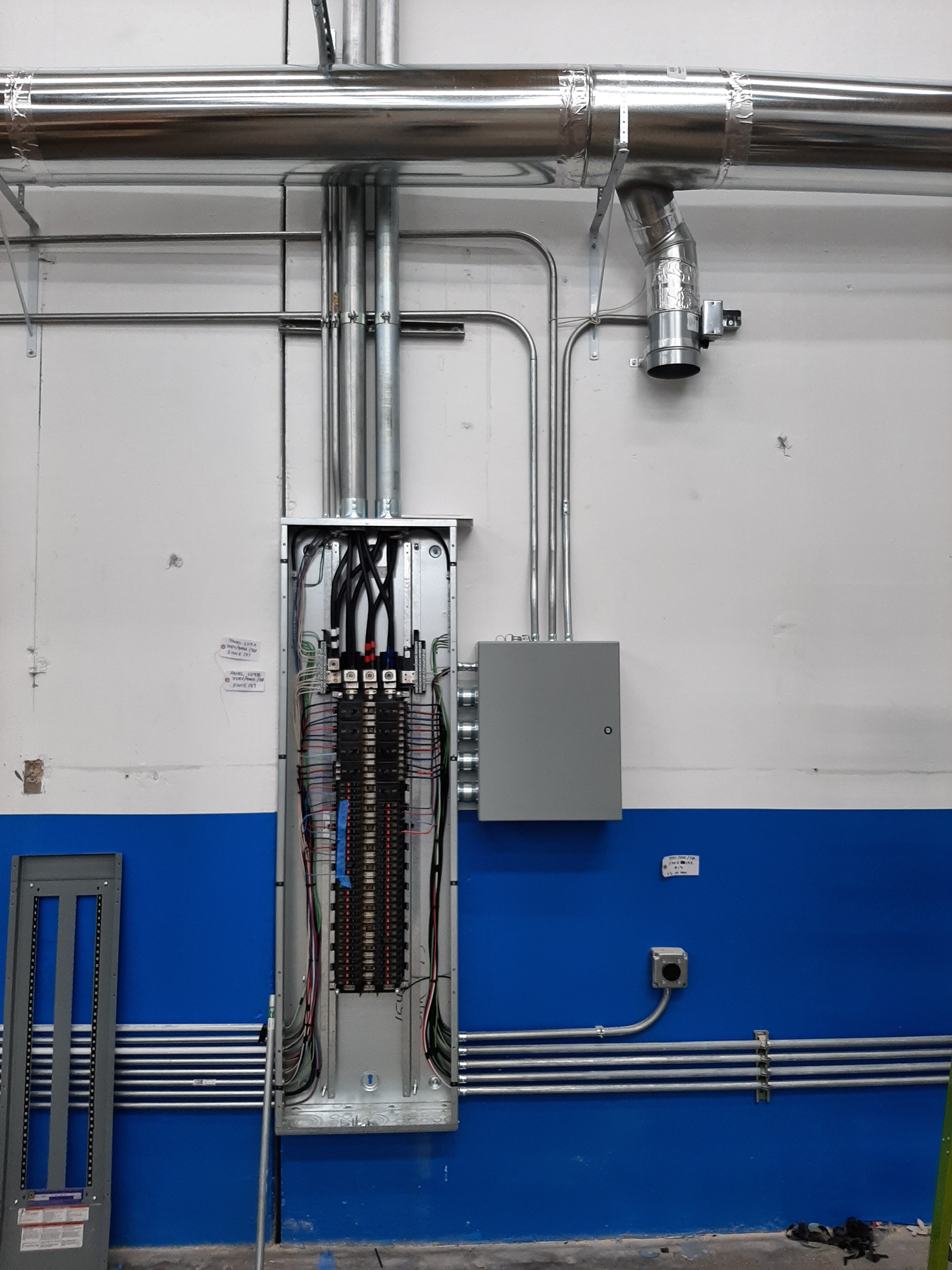

Then in the next photo below, the new 400 Amp panel for Fired Arts, Jewelry, and Glassmaking is complete except for the installation of the front panel. You can see at the top of the photo the newly installed ventilation duct for all the kilns. Each kiln’s vent hood will be connected to the duct with an electric damper that will open and close the appropriate vent hood. The gray box to the right of the circuit breaker panel will house the controller to operate all the dampers and the roof-top fan system.

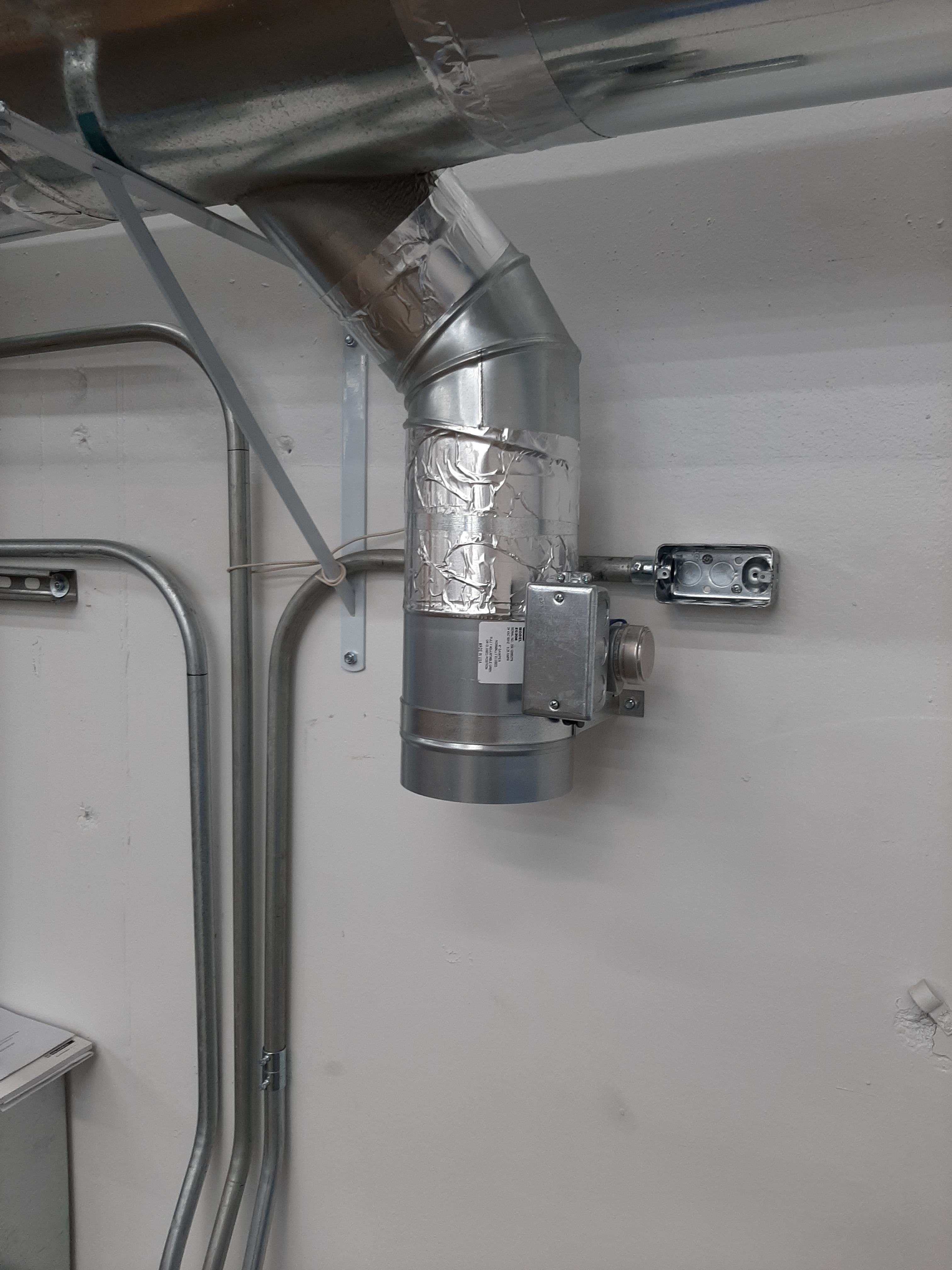

Then in the next photo below, this is a close up of the damper assembly. This is the same type of damper that is currently used on the laser cutters.

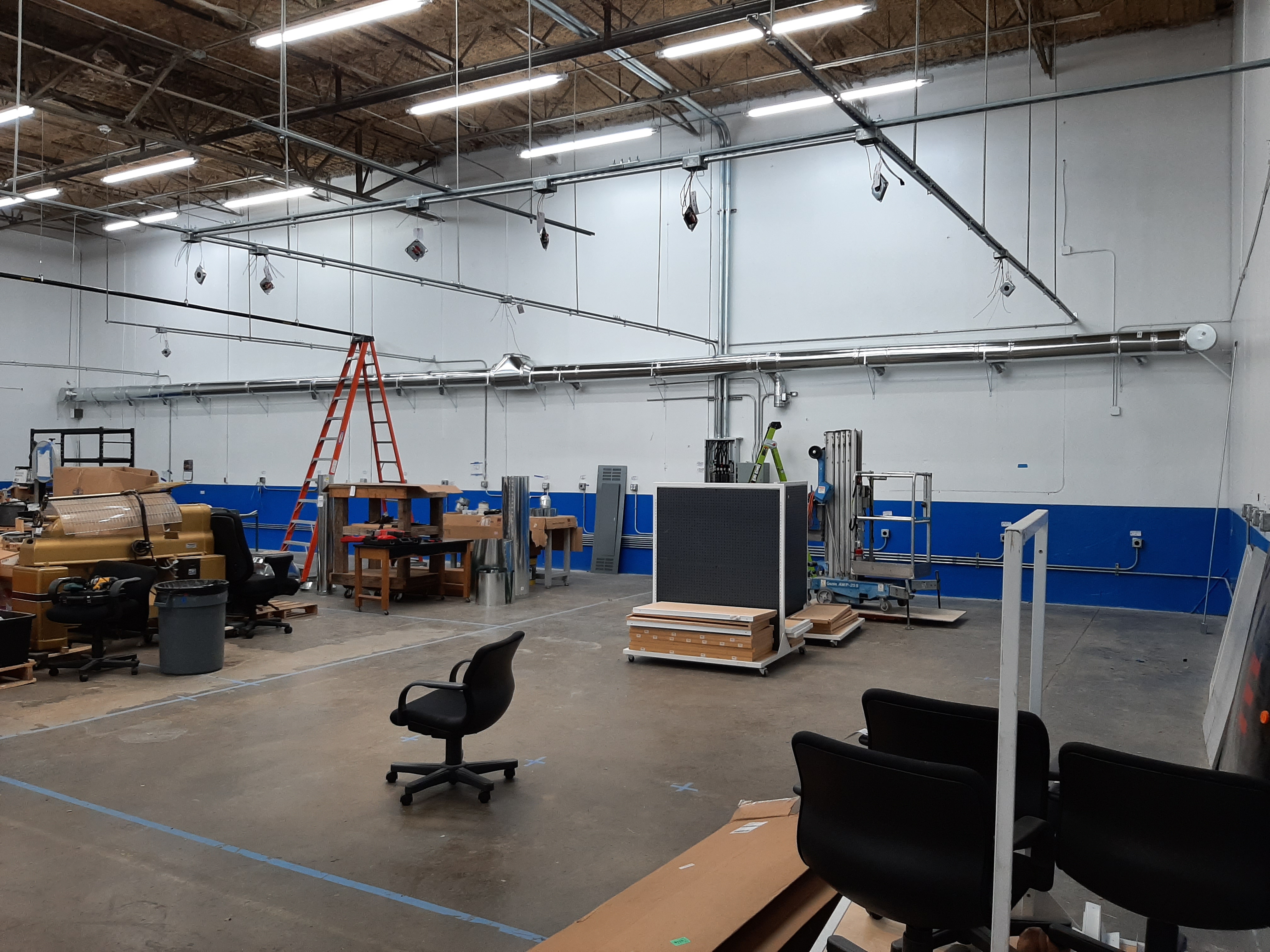

Then in the next photo below, an overall view of all the duct work going from corner to corner along the entire length of the wall. In the center of the wall is the connection duct that will go straight up to the roof. Once City Hall opens up, then we can get the building permits to have the roof-top fan installed. The same type of duct work will be added to the Blacksmith area.
