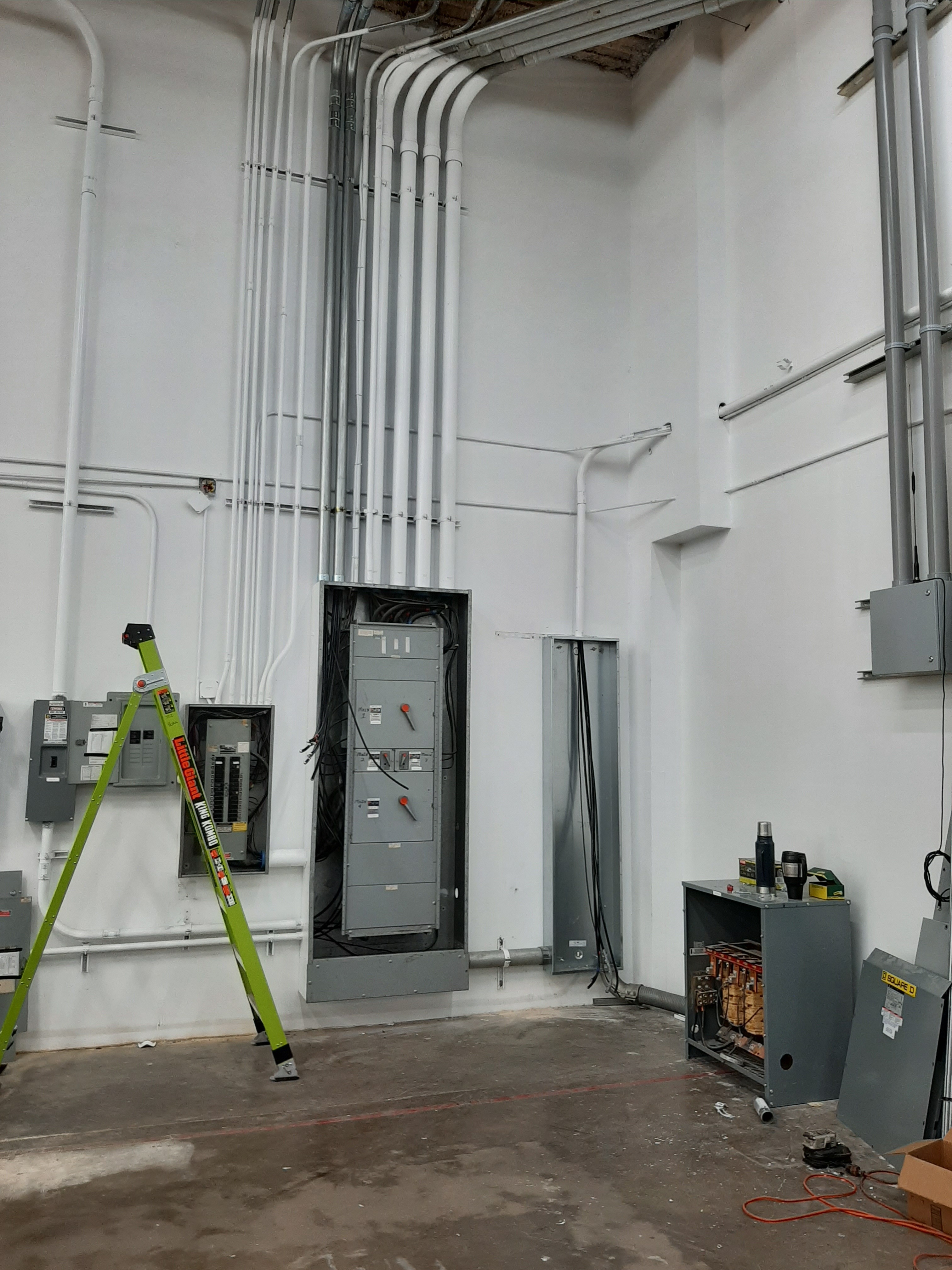

Electricity in the building was shut down for awhile as the Electricians worked on the main circuit breaker panel. The large box in the middle of this picture (see above photo) is the 1,600 Amp main panel for the 102 side of DMS. The new 400 Amp panel to the right will feed the Machine Shop, Blacksmith, and the 480 Volt transformer for the Welding area. The panels behind the step ladder are still to be replaced with new 400 Amp panels for all the building’s rooftop air conditions and the Automotive area. All of the major wiring has been installed in the conduits just waiting to be terminated.

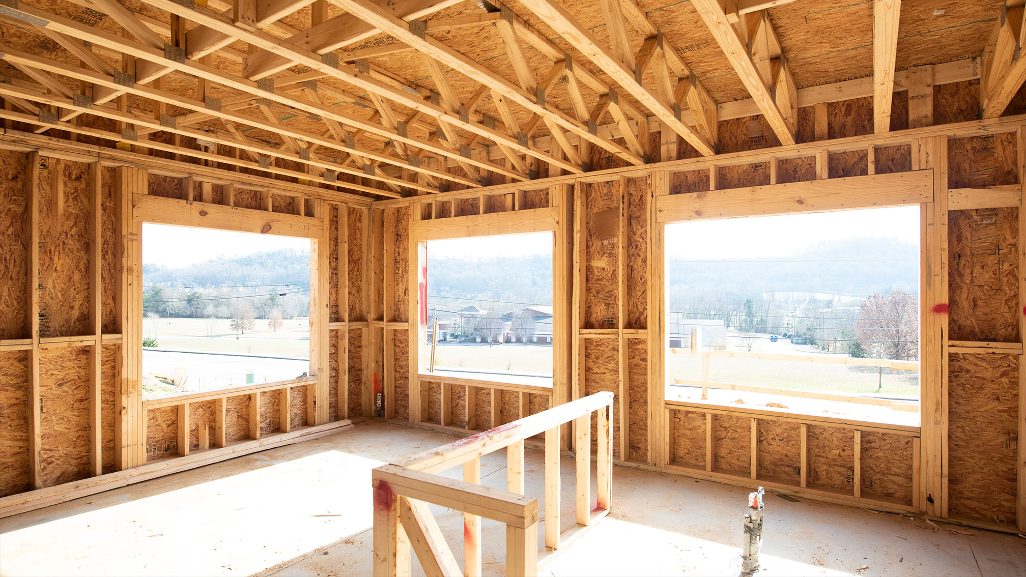

Build the wall !!!
