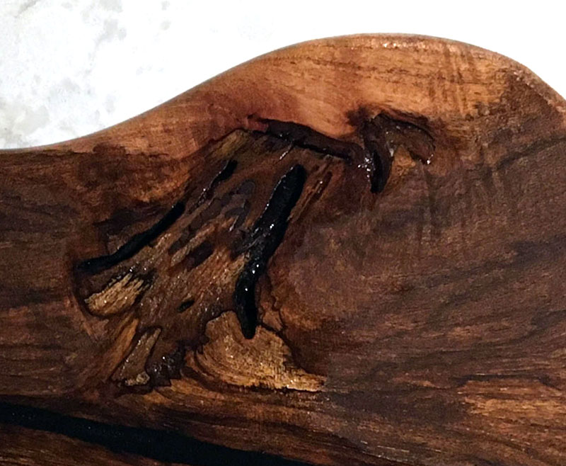

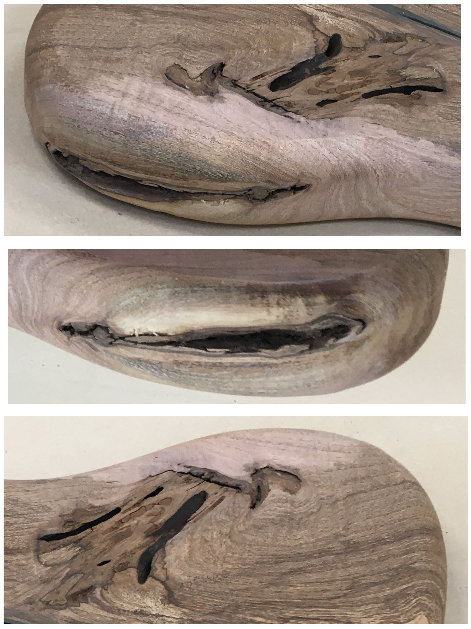

I’m filling in a knothole on a guitar body. I’m pretty sure the hole continues all the way through. Unless there are creative suggestions, I’d like to make the surface smooth and clear. Here is a composite photo showing the knot from both ends, plus a pic of the mesquite spritzed with water to show color better.
like you said, it might be that the hole goes all the way through, Id tape up the bottom one then do pours based on whatever the maximum pour amount is allowed by the resin you have chosen to use. If you don’t have a resin already picked out, I personally really like East coast bar-top resin for applications like this because you can pop the bubbles using a hot air dryer.

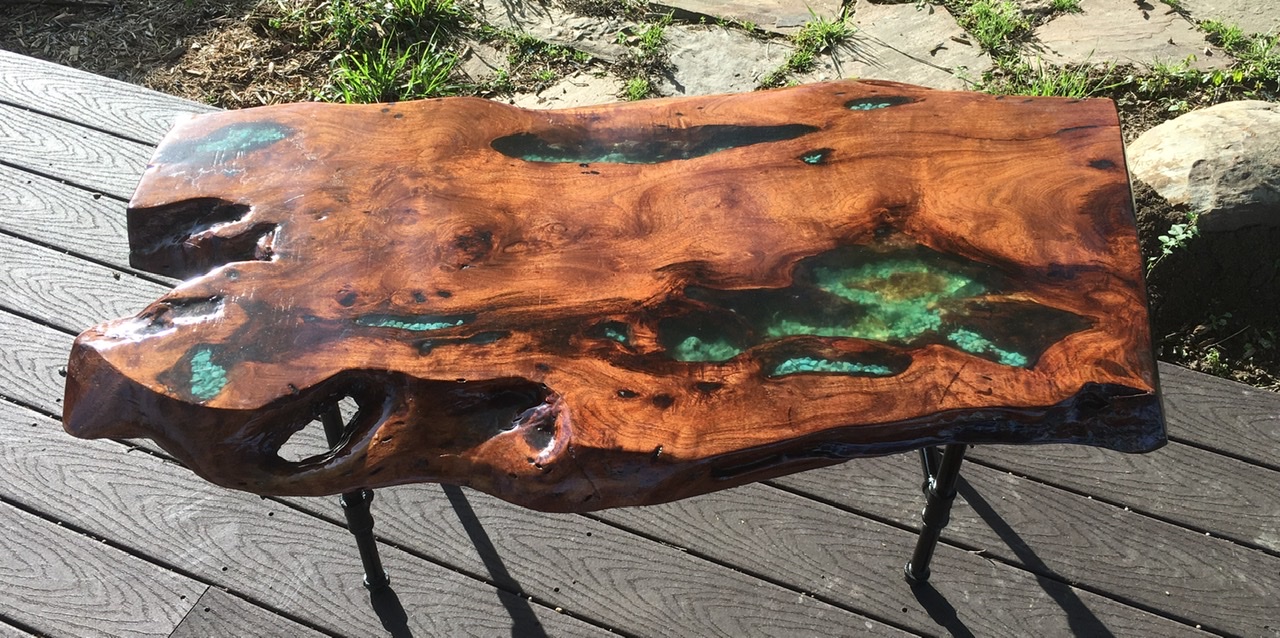

You can also mix sawdust from the wood and/or coffee grounds to make a more solid fill. I did that for the holes in my mesquite table. I aded turquoise stones as an accent.

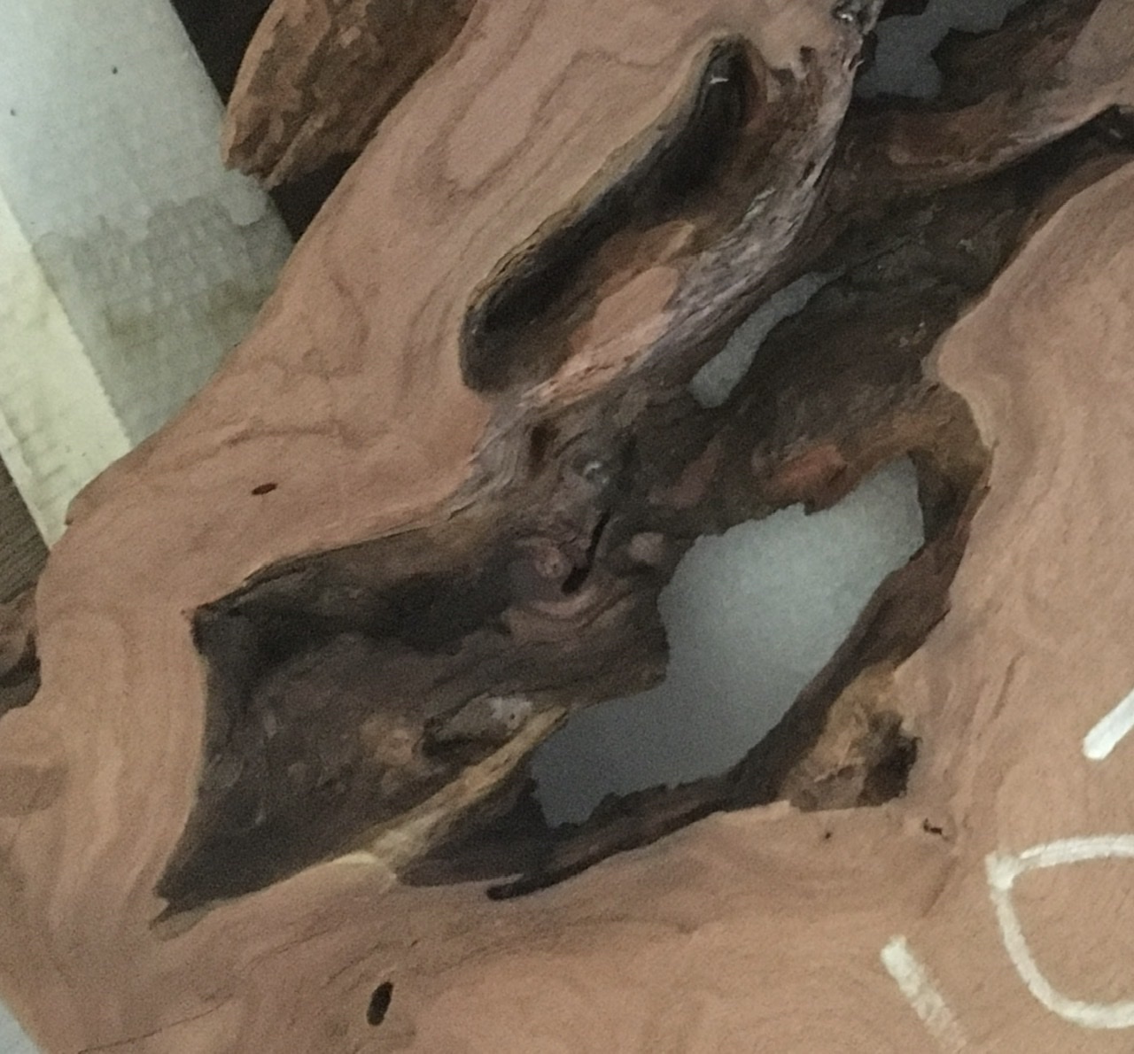

Here’s the hole.

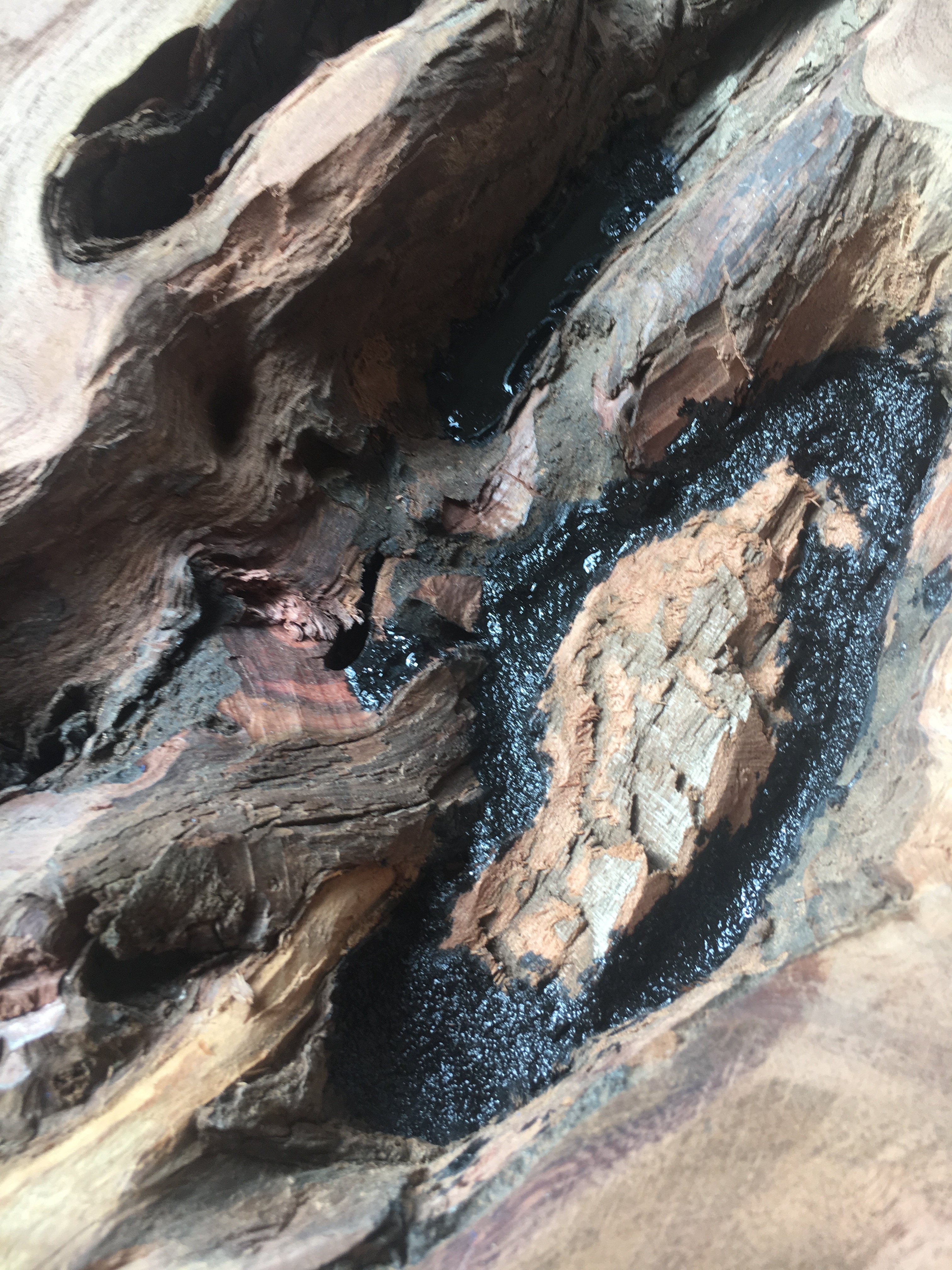

Here’s the initial fill (coffee grounds with resin, with a wood cutoff filling much of the space):
Here it is about 1/2 full:

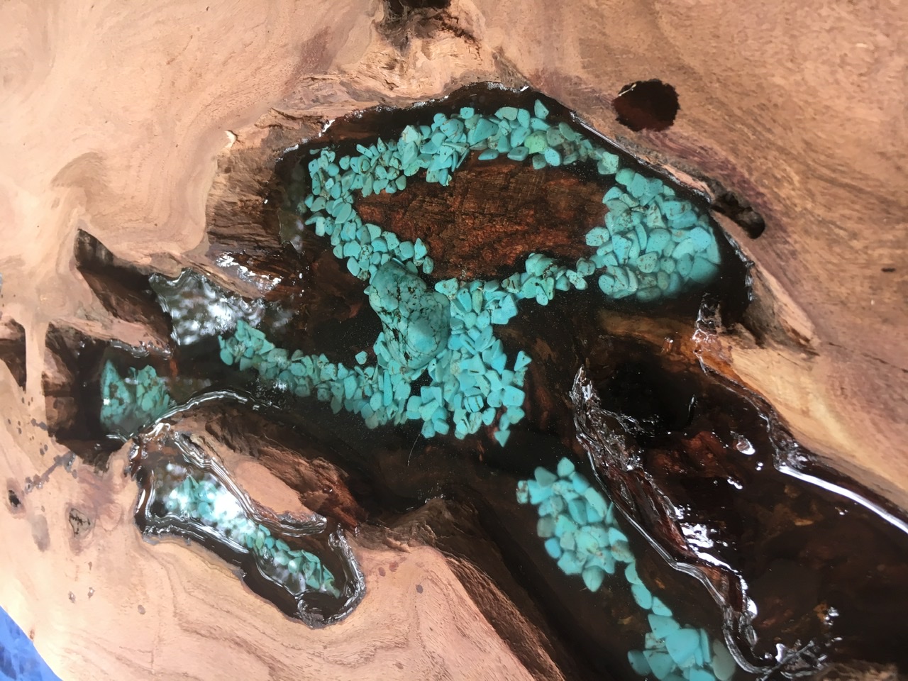

And the final result:
