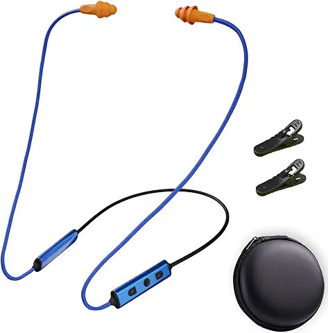

No, but the issue with the Milwaukee earbuds was that the weight of the electronic portion of the bud was enough to cause it to fall out, especially if you’ve got smaller ears like me. They attempted to counteract this by having a small silicone/rubber piece that you’d wedge into a crevace towards the front of your ear, however that’s what caused them to be the most uncomfortable for me personally.
If I were to purchase another set of Bluetooth compatible ones, I’d probably go for some earmuffs or ones similar to the picture below. That way the actual weight of the earbud isn’t causing it too fall out every thirty minutes or so. it’s instead just resting around your neck. I can’t speak to the audio quality of something like this though. Typically work earbuds don’t have the greatest audio quality, but it’s good enough to listen to your tunes or audiobooks without needing a super loud speaker. You’re moreso paying for the fact that they have a noise reduction rating (NRR) than for the audio quality or fancy features like you are with normal audio equipment.
